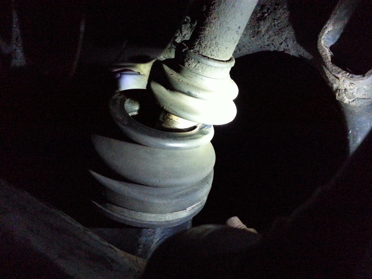

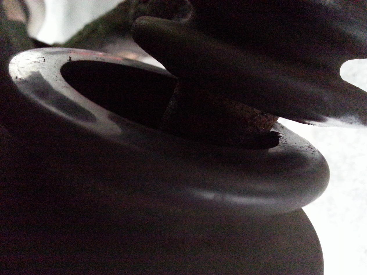

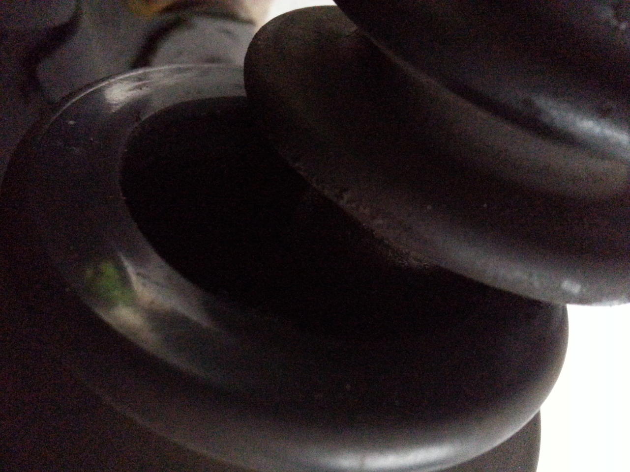

I also noticed the inner CV boot on the drivers side is torn - almost seems as if it was defective to begin with since its such a clean split (pics below). Any suggestions on a temporary repair until I can get to doing a permanent fix?

With how much that is torn, I would just replace complete axle. If it has been that way for a while, I wouldn't want to take out, clean up, and repack. Too much ish could of gotten in there. Not worth the small savings for how much extra work it would be.
But maybe someone has another suggestion.
Yeah, was thinking the same but wanted to make a temporary fix until I get replace the cv axle...

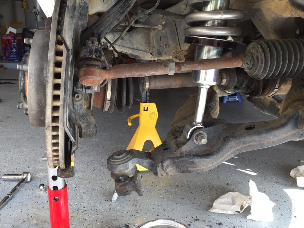

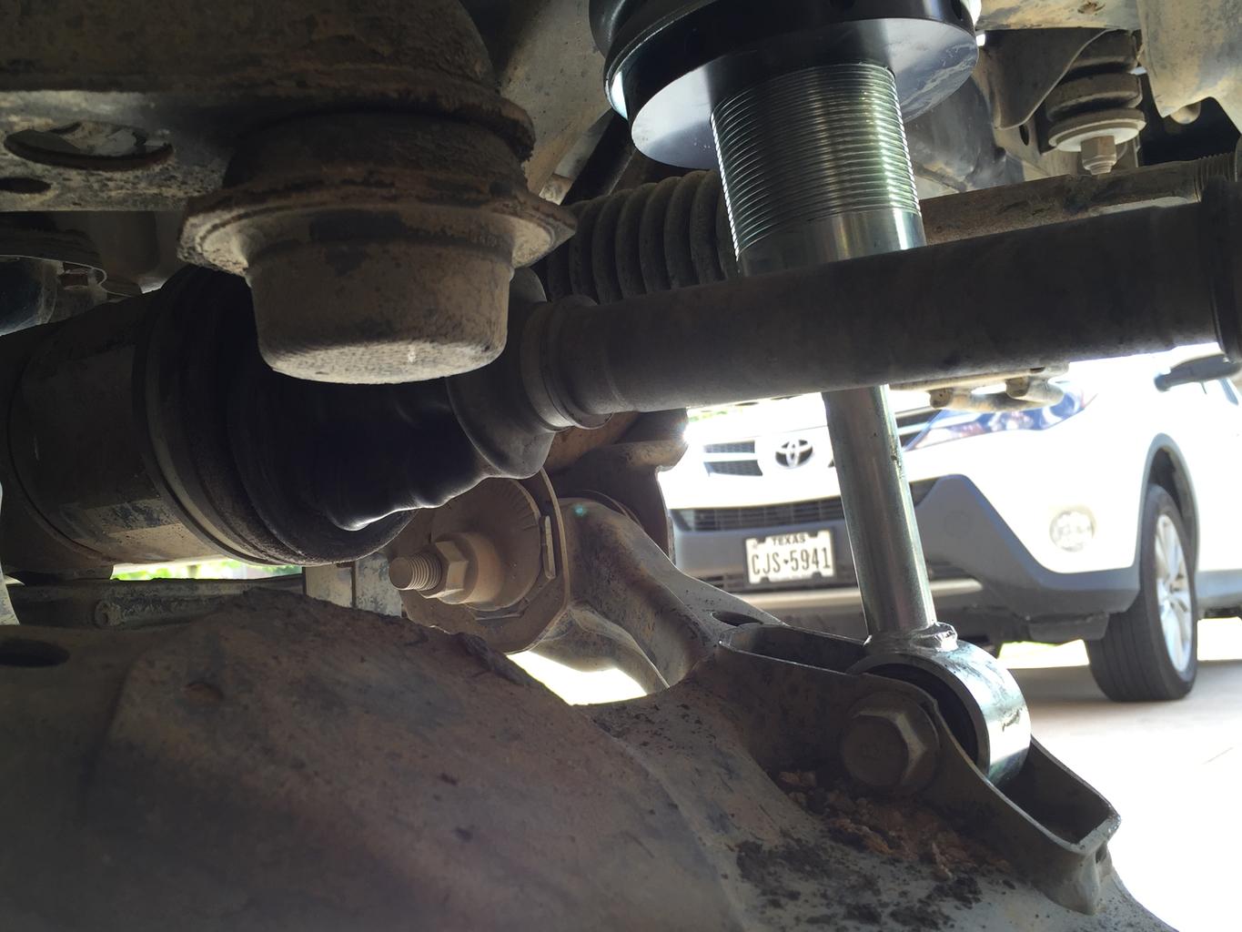

I am installing the Boss kit on my 04. I have the left front side done but have run into an issue on the from right (passenger). In following the instructions to remove the 2 bolts attaching the LCA to the Spindle assembly I must have messed something up. I got the new coil over in but cannot reconnect the spindle to the LCA. I am worried I let the axle drop too far?

The only thing that is dropped right now is your LCA. Do you have a bottle Jack or any other jack you could put under the LCA and jack it up? That pressure will bring it up to the connecting points allowing you to get the bolts in and tighten.
Thanks! I do have a jack and will do that. I tried it earlier but probably did not raise the arm enough. That's when I was worried I broke the rule in the instructions to not let the axle drop too much and had messed up the axle because of the way the boot looks.
I appreciate your help!

Disconnect the UCA at the upper ball joint. So much easier to slide the coil over in it.
I just did a 5th Gen Friday. I removed the sway bar link, brake line bracket, upper ball joint from UCA and that's pretty much it. I have always disconnected the 2 lower UCA bolts in the past but I find that being more work and not as easy to get the Coil lover in.
