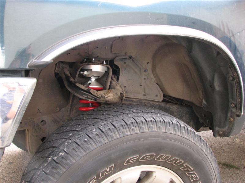

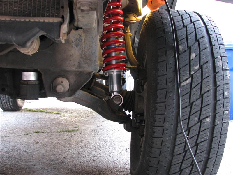

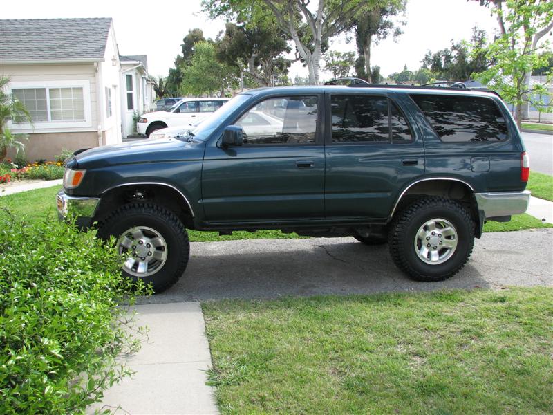

Here's some pics.

Wow I have the Ultimate coilovers too and they were set nowhere near that high out of the box. After installation, 3 months and approx. 1000 miles of driving they settled to a little more than 2.5'' of lift with no adjustments. Over the three months, the coils settled about 1/2''
Yeah, I would lower the front a little, if I were you. 3'' of lift is max I would feel comfortable running, considering the high CV angles and other stuff.
Ive got 1" of thread spare on mine, that's what was recommended by Toytec and 24" from hub center to bottom of LTD fenders. The front won't settle as much as the rear. If you like a level ride or even a little rake then you're probaly going to want 1.5-2" coil spacers in the rear. Mine settled out in a week or so. Let it settle, make adjustments and get an alignment ASAP.:cheers:
Thanks for the responses guys. To Jon, I have OME 890's with a 10 mm spacer on it now! That's how high the front is! LOL I don't know what the difference is with my truck. Maybe I got the only "special" 3rd gen with an alluminum block so my front end is lighter...?
I guess I should adjust them down about 1/2" on the coilover and see what that does.
It looks like we set those too high. I would adjust them to about 1.25 inches of thread showing below the locking nut. That should be about 3 inches of lift.
Thanks for jumping in Steeze. I originally never wanted 3" in the front. I want rake so I first adjusted them down to 1 1/8" of thread left below the bottom nut and I still had about 4" of lift.
I adjusted them down again to .75" and now I have 3" of lift. Tomorrow I'll take them down to .5" and leave them there. The cv's look much better, still rides great, even softer.
Thanks again for the help guys!
P.S. Gerdo, I did break the uppers loose and retorque. Heard them pop and twist in there so I agree it's the right way to go.

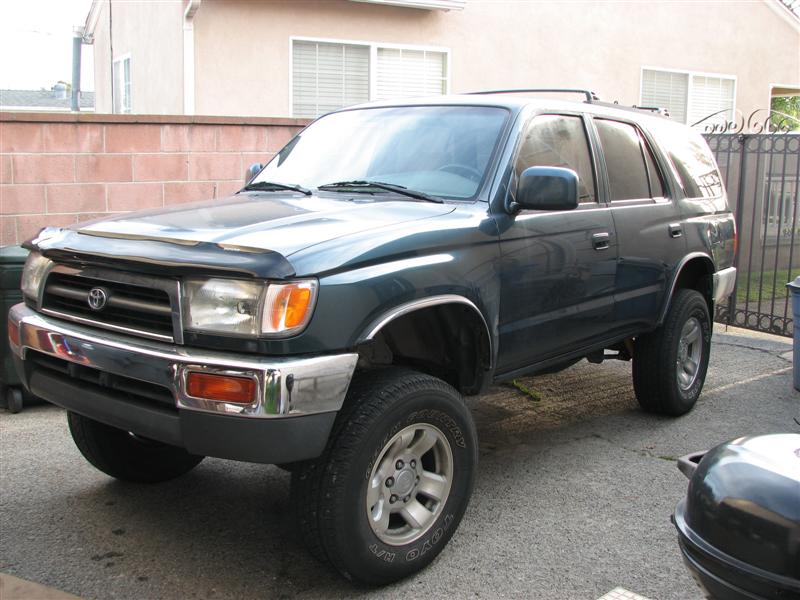

Finished with adjusting the height last week. I only left 5/8th's of an inch of thread showing beneath the bottom lock nut. Still got 2-2.5" of lift. Got the alignment and new tires put on today.

Thanks guys! Fightman, lol, I guess my truck is going to look like your first bought truck for a while since I don't have many more plans for it. It's just what I wanted it to be right now.
