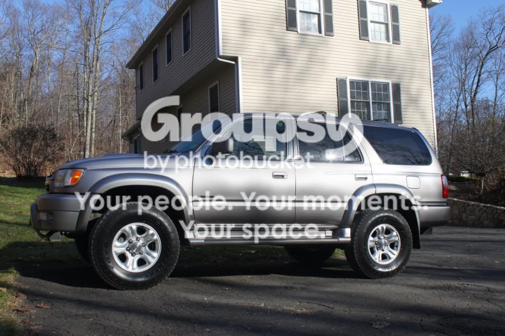

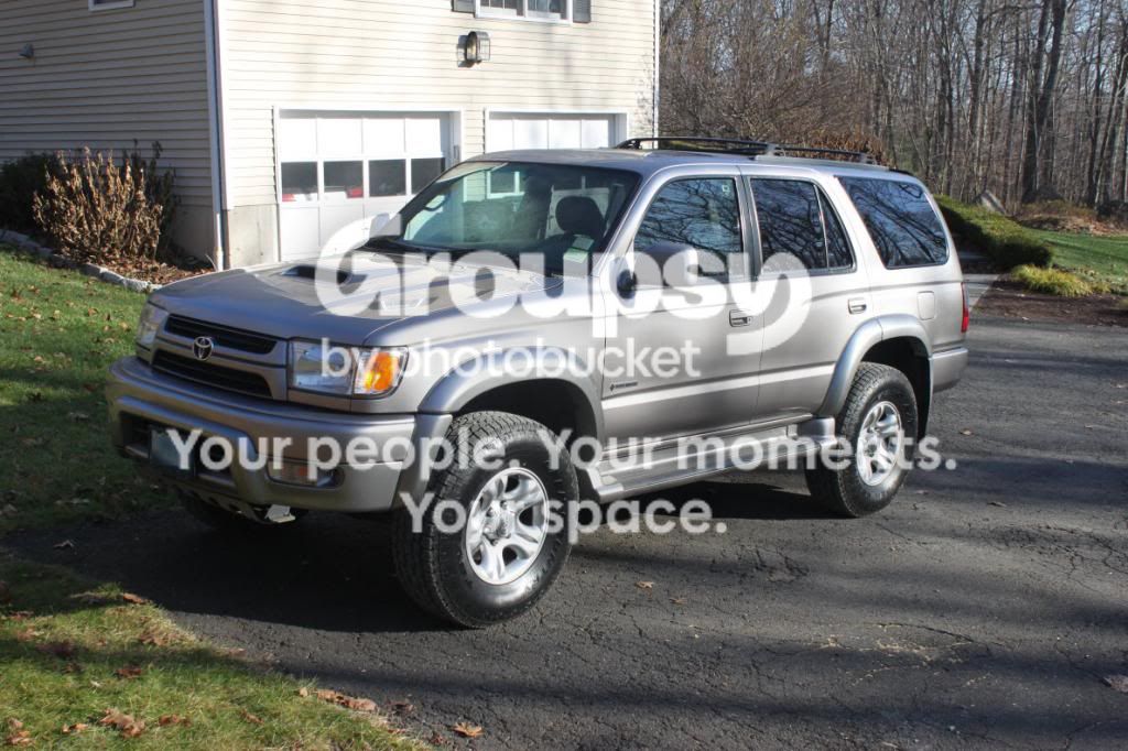

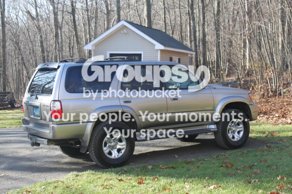

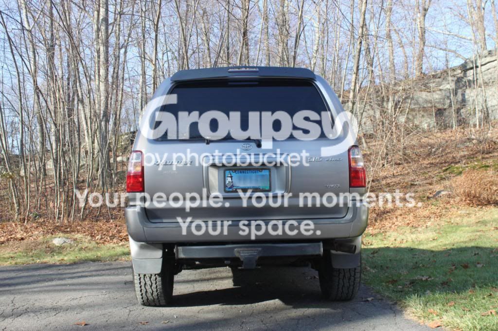

AFTER PICS >>>
4Runner3.jpg~original
4Runner2.jpg~original
4Runner1.jpg~original
4Runner4.jpg~original
After installation I put Toyo Open Country A/T IIs on in the 265/75R16 size. The ride is awesome and I couldn't be happier overall. The only thing I am still getting used to is the amount of additional sidewall now -- I used to have the original Open Country A/Ts in the OEM 265/70R16 size w/ whitewalls out. Visually I would probably be happier with 17" wheels and/or whitewalls... but they don't sell the tire in this height for 17s. I just need to get used to it.
So, hopefully this post helps those who are thinking of the same / similar setup! I'll post more on the actual installation soon.

Truck looks awesome! Nice mild lift, OEM wheels, bigger tires, Thundercloud Sport Edition awesomeness - great combo!
What did you do up front? Did you install a spacer or new springs, or ???
My son's '99 has the same OME 906 and yellow Bilsteins in the back, new Moog springs up front (slightly taller than the stock '99) with Pro-Comp's up front (wish we had done Bilsteins there, too).
I think it has the perfect back-to-front rake, about 1-1.5" higher in the back than the front. My son, however, wants to raise the front up because it looks to him like it "droops" - whatever.
The toytec ultimate kit comes with toytec's coil-overs.
its a bilstein shock with their custom coilover kit on it. adjustable from 1" to 3.5" of lift.
its a full adjustable coilover kit in the front, top notch stuff
Thanks guys! Awpsome is spot on -- it's running the Bilstein / Eibach coilovers that Toytec sells. I have them pretty well dialed down... and they're surely overkill for a DD that does occasional offroading... but I wanted to set the truck up for camping and more offroading in the future. I'm thinking 17" wheels and 33" tires at that point -- and will be able to dial this lift up accordingly. I just wasn't ready to get into all the additional cost and work this go-around... including the loss of MPG going to those bigger tires. Adds up when you do 45 miles each weekday!
