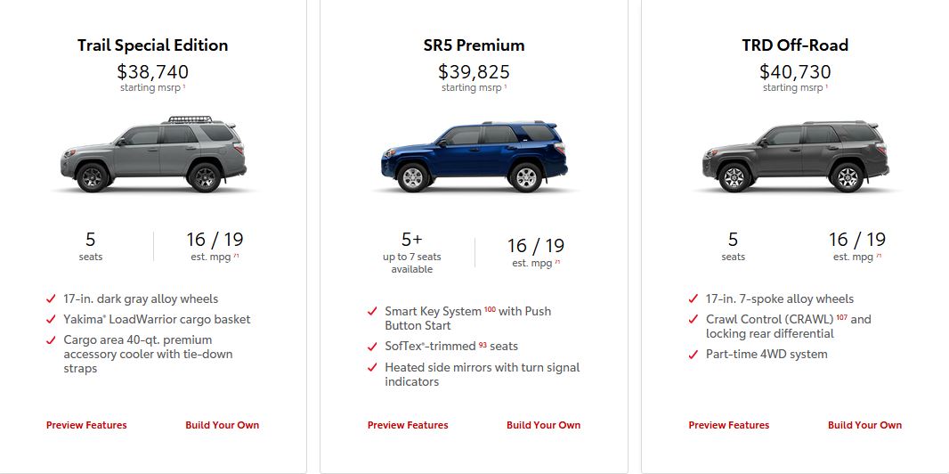

OP, I think any 4X4 version of the 4Runner will handle what you are looking for. However, it should be noted that the current “Trail” model is not the same as the older Trail edition. At some point, Toyota decided to rename the Trail to Off-Road. This causes a lot of confusion in threads like this. The newer Trail versions seem to be an SR5 with a few cosmetic upgrades and doesn’t have Crawl Control, MTS, or a rear locker. The Pro and Off-road trims will have all of these. I have an older Trail edition and the only difference between it and the Pro back then was the upgraded suspension.
Again, I think any 4X4 trim level will do what you want. If you think you need the off-road features,like Crawl Control, MTS, and rear locker, look at the Off Road trim level.

SR5/2021 Trail Edition: capable off road but does not have a rear locker or crawl control/Multi terrain Select (MTS).
Trail (2010-2016), TRD off road (2017-2021) and Venture (2020-2021): Has crawl, MTS and most importantly a rear locker. As others said, it shouldn’t be required 99% of the time for the type of off roading you described but if you do need it, it can be the difference between continuing and turning back. KDSS is available and is a good option if you don’t plan to lift more than 2”.

A 4x4 Off Road, Off Road Premium, or Venture would be my recommendation. I'm off road almost every weekend and use my locking rear differential all the time.
The current Trail model is a SR5, which doesn't have the locking rear differential.
You really want a locker for water crossings as there is the potential for hidden obstacles under the water. The rear locker allows me to slowly crawl over obstacles vs using momentum that can break things.

Edited to add. There is a $2k-$3k difference in price between the Trail and the Off Road. Get the Off Road.
