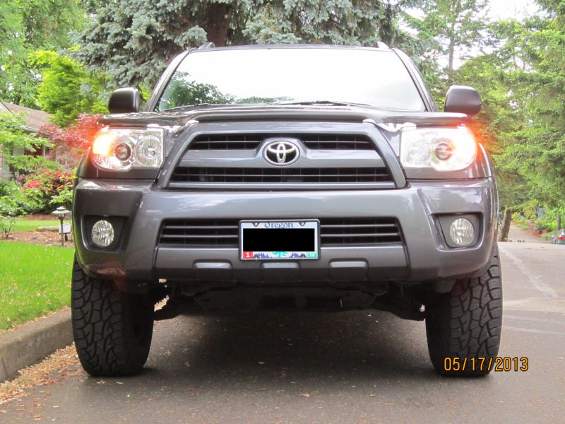

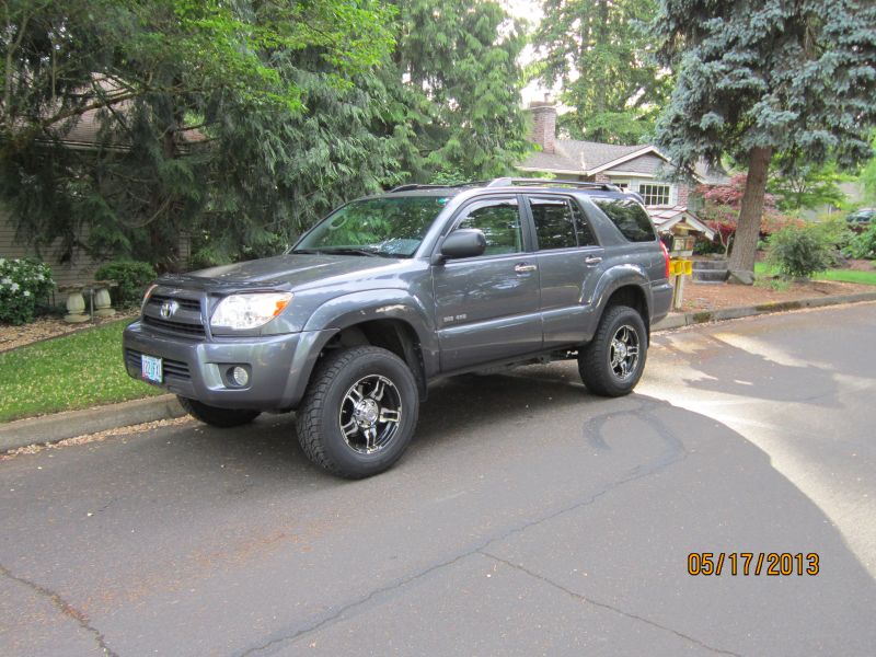

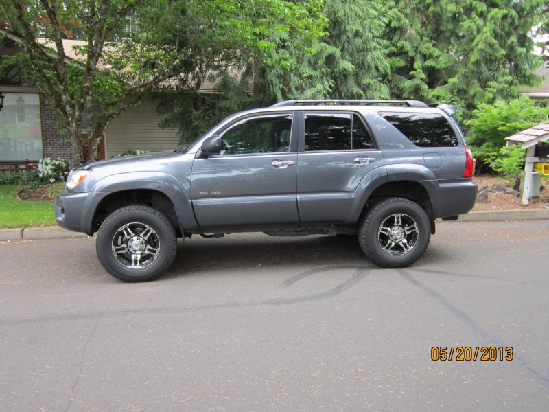

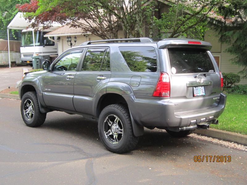

I researched and started with the FJ coils, DS 2.5 lift and 5100's all the way around. After that I installed Cooper ATP 265/70-17's. Great tires, great ride and comfort. For those on a budget, I highly recommend it. I was in for under $500.00 on the lift and $830.00 for the tires.

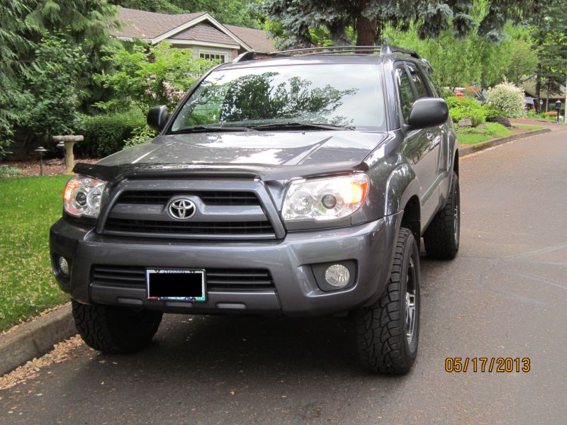

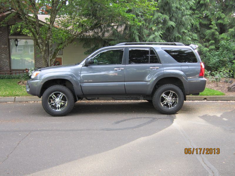

Here is how it currently sits. I did have to by some wheel spacers due to lack of back spacing of the wheels. I also recently removed the running boards. They seem to get in the way more than help.
This also starts the second part of additional mods. Budget conscious and balanced. Those seeking to not spend a lot of cash to enhance their 4Runner, hopefully I can help.

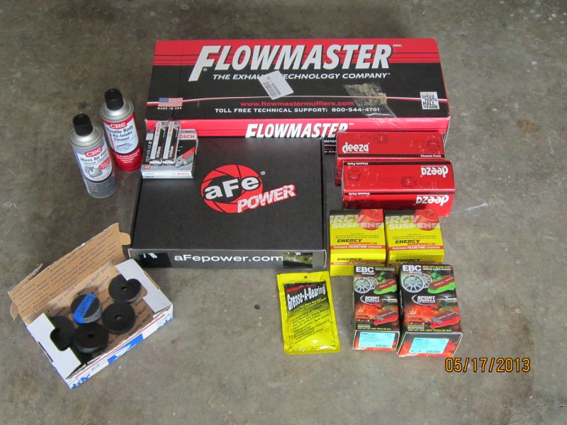

I ran SeaFoam earlier this week in the tank, oil and intake. Today I changed the oil. Tomorrow begins installing parts. I'm upgrading the brakes, exhaust, air filter, sway bar bushings, installing iridium plugs and a 1/2" BL from emelianenkov. The URD Y-Pipe and MAF Sensor calibrator won't be here until this Wednesday. I'm also waiting on 4xInnovations rock sliders that shipped today.
The Flowmaster 50 Super SUV series is going on with a side tip out behind the rear tire. I found a screaming deal on Amazon for $101.00 for the muffler. I went with the EBC 6000 Green Stuff pads. Due to mixed reviews I opted to keep factory rotors in lieu of tossing money where no benefit would be guaranteed.
Full LED interior lighting will happen later this summer, along with a roof rack!
Hopefully I should see some performance, a little better fuel mileage and get some maintenance items taken care of. Thanks to all those that shared input on brakes, exhaust, and URD parts experience. It really helped guide my decisions.
I'll post up pictures and get some lift measurements as this procedes. Nobody can argue the joy of parts coming to the house!

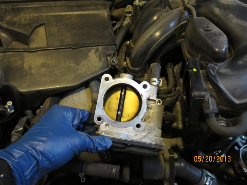

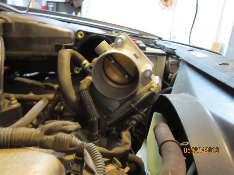

Between Sunday and Monday I installed the front Energy sway bar bushings, cleaned the nasty throttle body, MAF sensor and put in my aFe Pro Dry filter.

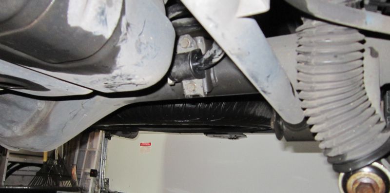

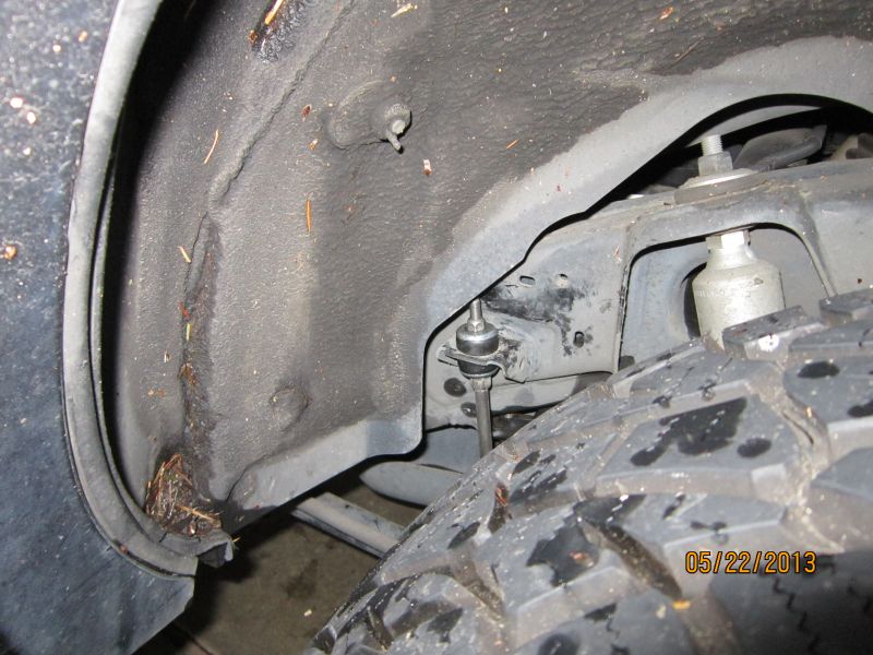

Today I finished up installing the rear Energy bar bushings and end link bushings. I ordered them from Wheeler's Off Road. They are great to deal with.

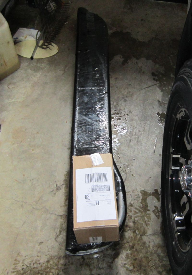

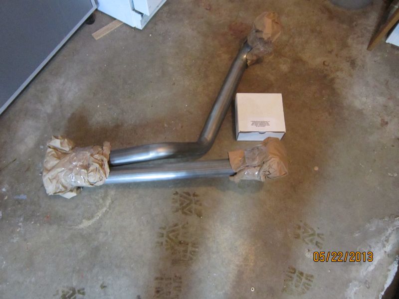

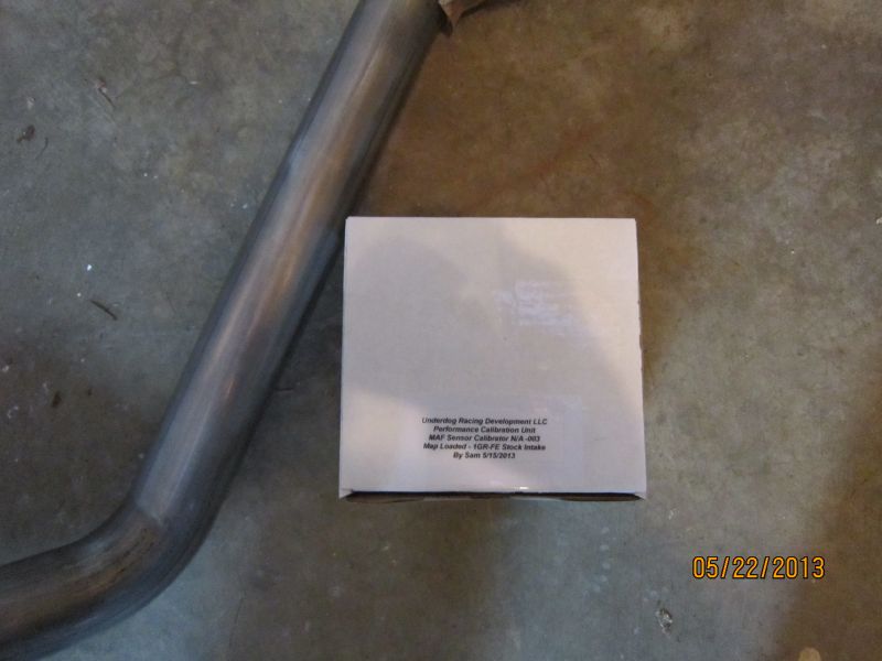

The best part of the day was the two deliveries from FedEx. My URD y-pipe, MAF sensor calibrator and 4x rock sliders arrived. I'll be busy this weekend trying to get at least the exhaust completed. URD and 4x Innovations have been top notch so far.

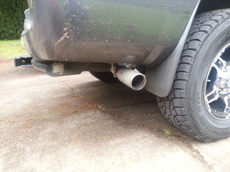

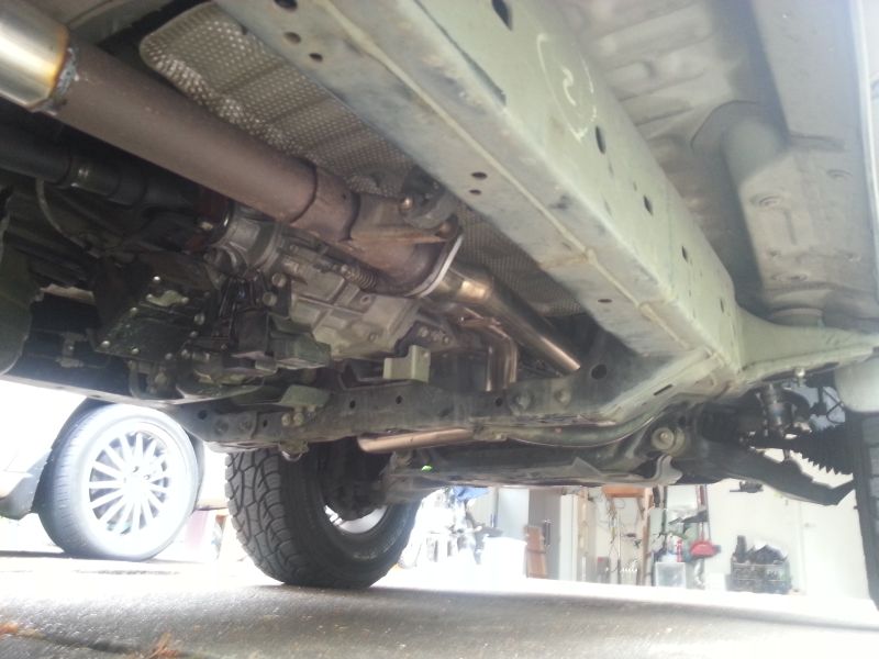

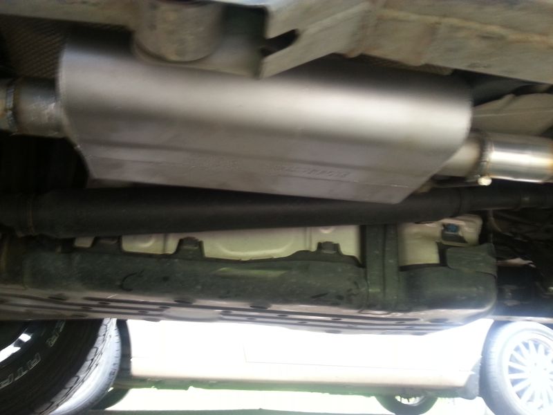

I started installing my latest round of mod installations Friday night. The stock y-pipe came out. It was a royal pain. The new URD Y-Pipe took all of about 2 minutes to install. Saturday I had the Flowmaster installed and the tailpipe tipped out behind the tire.
The muffler has a louder tone to it, but not bad. It rumbles along nicely. There is a very stark difference between the Flowmaster and the stock muffler with resonator.

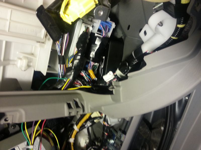

Today I completed the URD MAF Calibrator install. I did a lot of searching for other user installs on other forum boards. It took about an hour or so to finish it up. I would have preferred the solder option, but it wasn't working for me. I crimped the wires into connectors.
It'll probably take about a week of driving to get the ECU to learn it. Next up are brakes and getting my rock sliders installed.

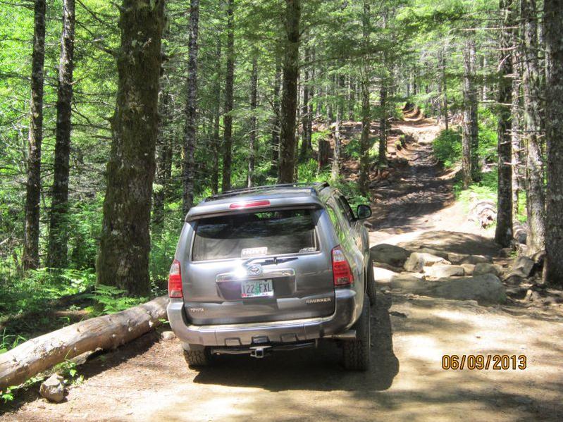

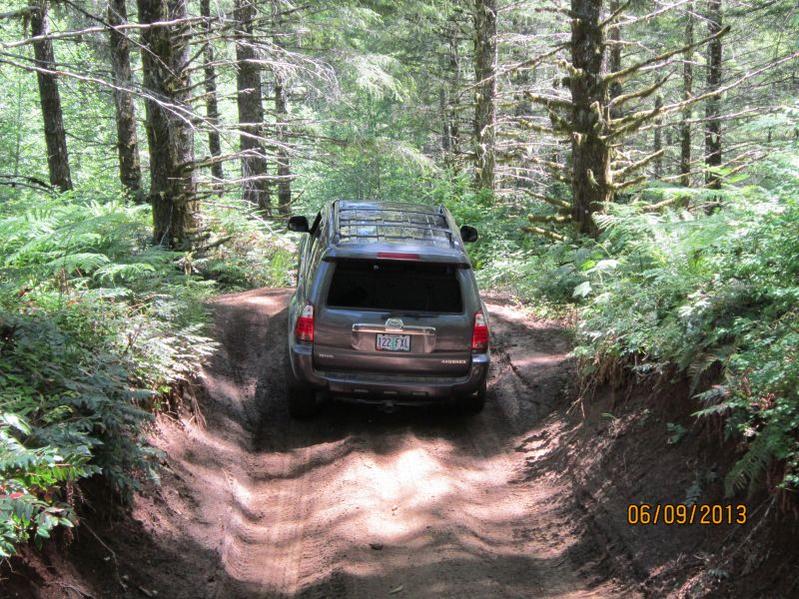

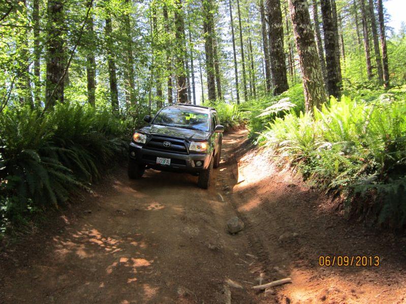

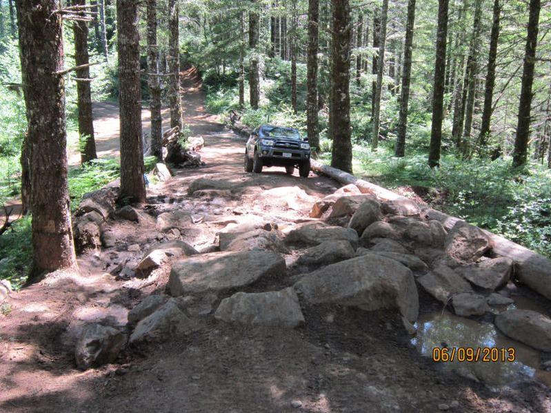

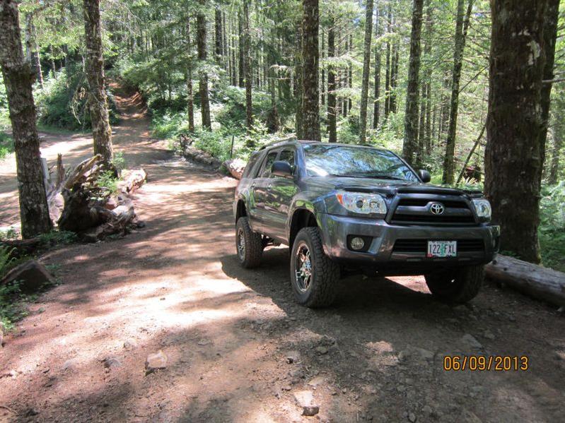

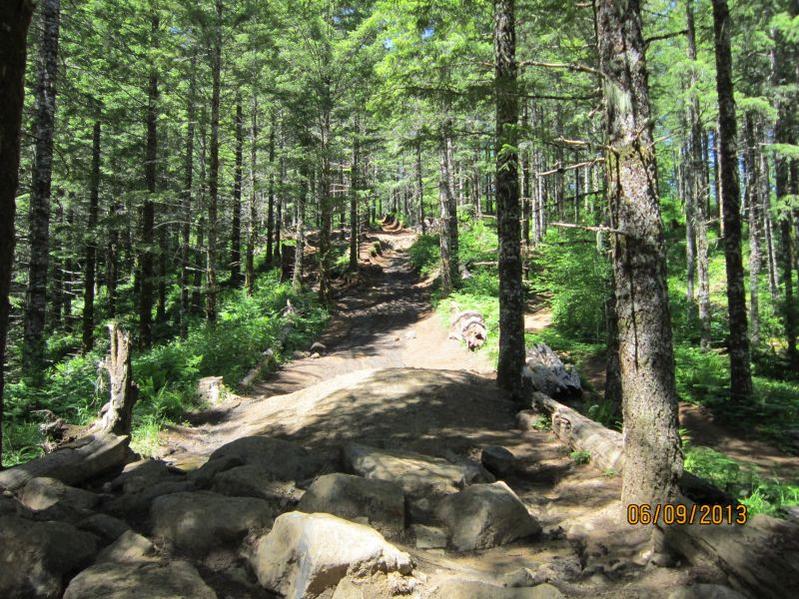

We got out on some trail today and it's the first time to get into something other than fire roads. I really am pleased with the lift. We did not get into major rock sections. There were some pretty narrow sections though. These are great trucks.
It was also the first time getting out of the city with the URD upgrades and the Flowmaster 50 SUV series. There is minimal cab noise at highway speeds and no drone pulling hills. I noticed since the ECU has adjusted a nice power increase too. The swaybar bushing upgrades were very nice on the higher speed curves. There is a lot less body roll. Last week I installed some heavy duty Deezla front end links.

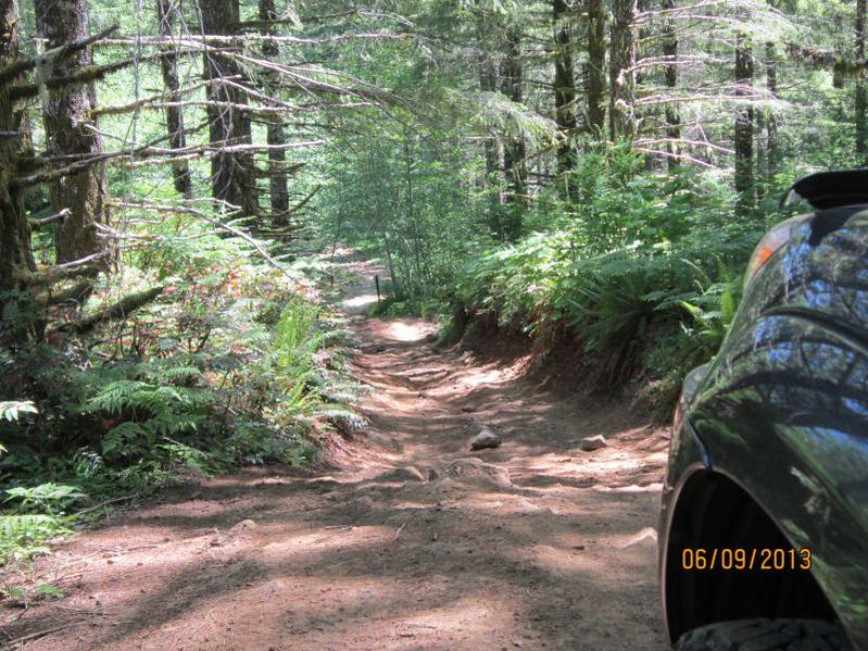

Here's some pictures. I normally ride my bike in these areas. Totally wierd, but still happy to get out there in the 4Runner and very happy with the performance.
Hitting some trails out in the woods. Beautiful day in the mountains.

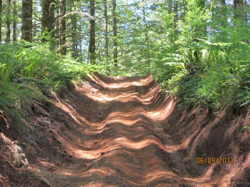

More pictures.... This area dropped down into a pretty narrow gully. I had to think skinny. I'd had to ding up the daily driver too badly.
