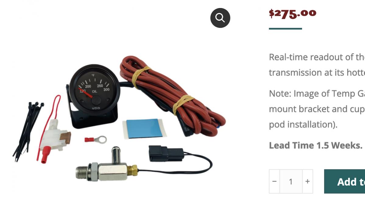

Perhaps you need something like this to verify the ATF temp:
Analogue Transmission Temperature Gauge to suit Lexus LX450 (Jan 1995 onward) with A343F 4 Speed Auto - CruiserBrothers
The A343F is very similar to the A340F transmission.
Have you seen one of those in action? I'm all for supporting small import businesses in the USA, but that's a bit pricey when I have a dozen other issues needing attention. Also, since I'm here grousing already, that vague VDO gauge is only a little better than our factory temp needle and must be more useful on the Lexus/LC ATs they are geared to, given the temp range printed on the face. I'll stick with my $100 UltraGauge that displays fractions of a degree (admittedly, I have no idea where the computer gets that reading).

IIRC it gets its temp reading from the temp sensor on the passenger side of the trans next to the outlet pipe. That kit won't work on the 4runner as it has hard lines that go up to about a foot away from the radiator.
If you have a '99+, using the OBD-II information is easiest/best. It takes the reading from the same location as that kit, on the cooler outlet pipe.
-Charlie
$275 for a physical gage vs $5 for say Torque Pro makes no sense to me.
If you want a separate display the app can be put on an old phone - all it needs it BT to connect to odb2 reader. Luck all with the pesky trans temps.
