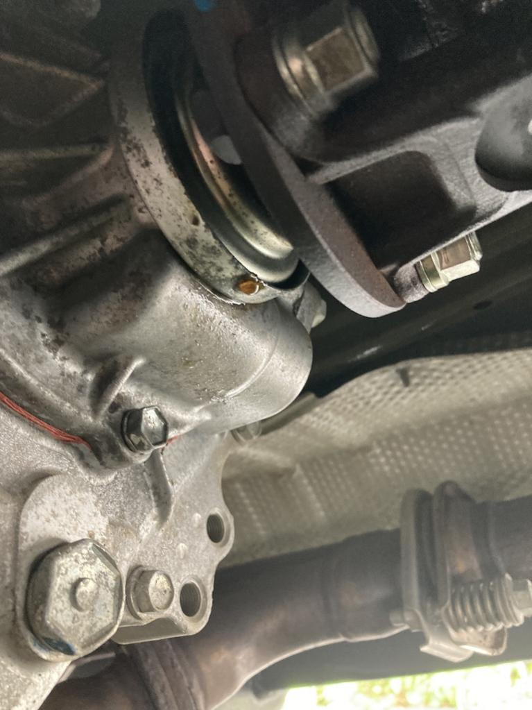

2019 with 22,500 miles.
Anyone else have a rear output shaft seal leak? It is very minor as the truck was parked all week in the garage with nothing on the floor. Going to have a dealer take a look shortly.
I have not looked at the maintenance manual yet but assume it is a fairly quick job.
Thanks!
Super easy job, hardest part is unbolting the drive shaft.
I changed mine once, but it actually wasn't what was leaking. There is an O ring behind a cover plate for where the speedo sensor went on earlier models that was my leak.
Yep my 2019 did the same thing at 32,077. Fix under warranty! FYI tell the dealership it's a slow drip, apparently there is some seepage that is considered normal by the dealership.
