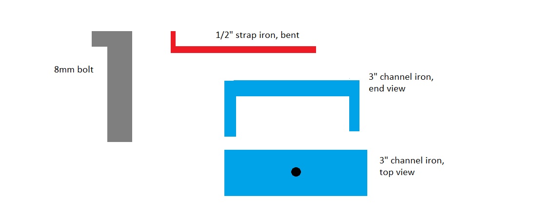

You can purchase a bearing puller. However you can easily, for this application, make one yourself with some odd bits of scrap metal. I'll see if I can find the one I made for this very job and post a photograph tomorrow. Meanwhile, here's a description and a crude drawing made in MS Paint.
Start with an 8mm bolt about 75mm long. (Or use a 5/16" bolt) Use a bench grinder and grind on its flats until you've made it so that the head can be inserted into the bearing's hole. Do most of the grinding on one side of the bolt's flats as you can. (gray in the my picture) You'll have to round the other side.
Take an 8" piece of 1/8" thick, 1/2" wide strap iron and bend it into an L shape. (red in my picture.) you may have to grind and shape the bent end a bit. The idea is that first you'll insert the bolt into the bearing, then this L-shaped piece will be inserted to lock the bolt's head in.
Finally, you'll need a short piece of 3" channel iron, blue in my picture. Drill an 8mm hole in it center.
Oh, you'll need an 8mm nut, too. (or 5/16")
In my experience pilot bearings are not a particularly tight fit in Toyota flywheels.
Once the bolt and strap are in place, put the channel iron over the bolt, put on a nut, and pull the bearing.
There are probably lots of substitutes for the channel iron. Once on a Tercel I used a very long piece of angle iron that went all the way to the edges of the flywheel. You just need something to pull against, and you need room under it to insert and hold the red piece.
