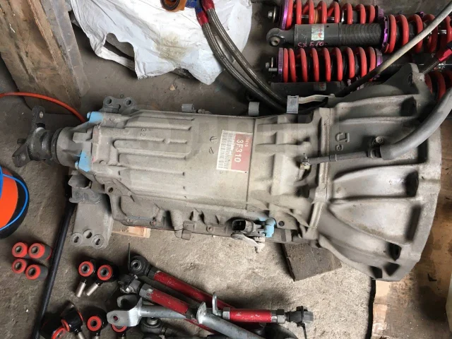

Where is the breather? I don't think I've ever noticed it before.
It is on the top/front of the main body of the trans.
Depending on year, 2WD/4WD, etc. it is slightly different. You can see it there as a small tube that goes partially up the bellhousing (my '97 4WD trans), on my '99 2WD trans, it was just a little cap kinda like the rear diff breather, coming out of the trans in the same position. On the car-based A340's, it is often a longer tube that goes up much higher:
