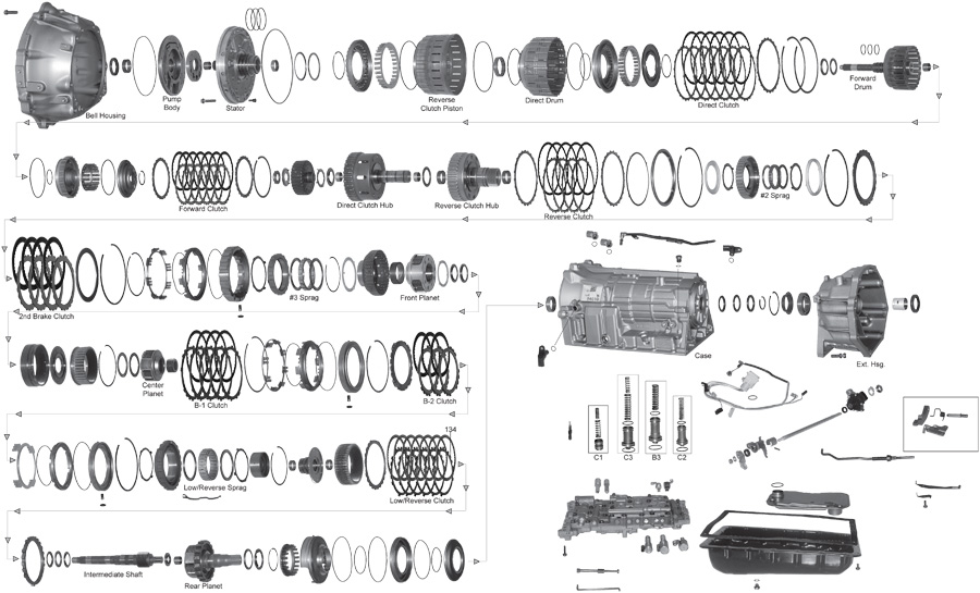

The A750f transmission has IIRC 7 clutch packs. It's similar to most traditional automatics with multiple planetary gear sets. Shifting planetary gear sets is normally done with clutch packs. They should see very little wear. The reason is that the torque management reduces load before the shifts happen. They basically don't wear out. A million miles is probably about the typical service life. There's a reason you never see threads about rebuilding these automatics. I don't think you'll hurt anything by replacing the fluid. But you probably won't help anything either. Fluid color doesn't have much value in identifying the properties of the oil. I suppose you could have it analyzed by a lab - but unless you also know what the goal is - how would you know whether to replace or not?
From the anecdotal evidence department of irrelevant information - My last 4runner got an trans oil change at 200k miles. I did timing belt #2 and also replaced every rubber hose and belt under the hood and all the oils and gear lubes as a full 200k service. It was also the first diff and transfer case fluid change it ever had. No problems with it ever. Probably didn't need it. I'm sure it's still driving around out there somewhere.
Here's an exploded view of the A750F with all of the clutch packs. (they're the parts that look like the olympic rings)
