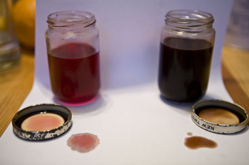

But back to basics, what does the trans fluid look like? Good fluid is a bright cherry red, old fluid is darker red, and bad/burned fluid is more brown, and if burned smells burned.
Transmission Fluid
Here is the fluid from the transmission (on the right) compared to new fluid (on the left). The old fluid is very thin, does not have a very strong burnt smell, and still has a red tint, but is pretty brown compared to new fluid.
Any thoughts on the next step?
