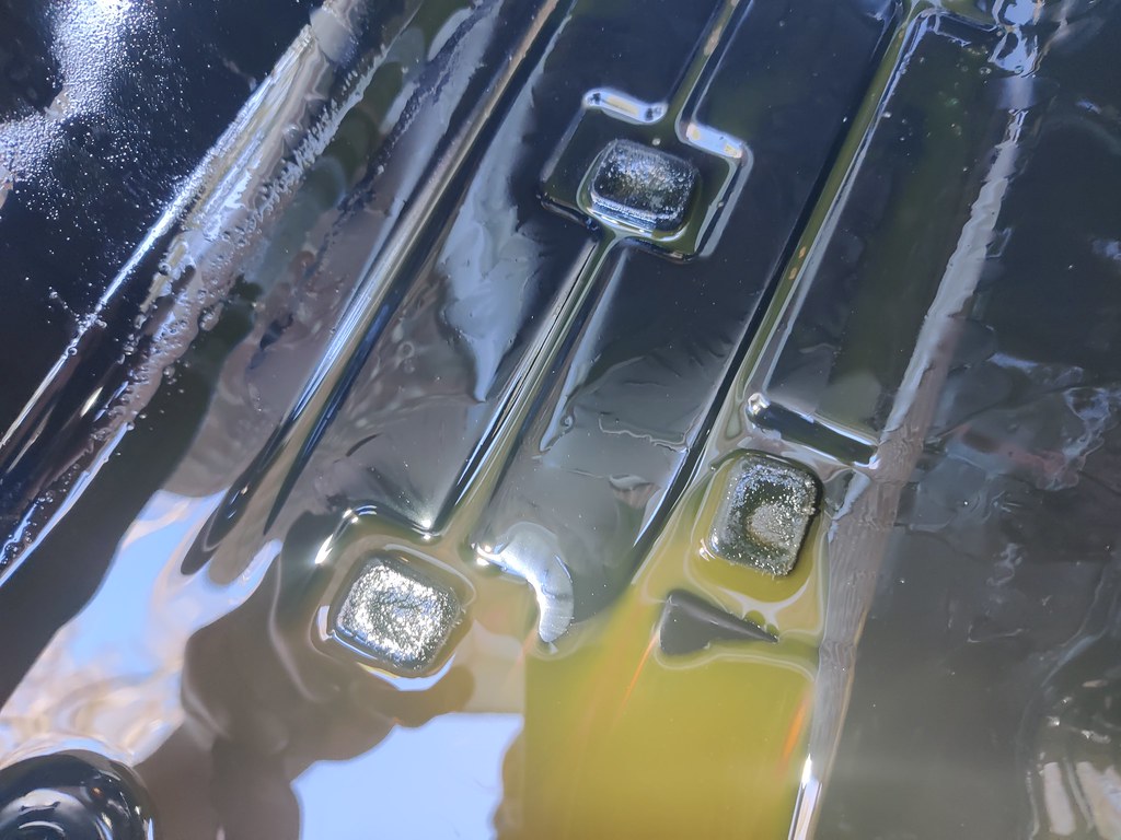

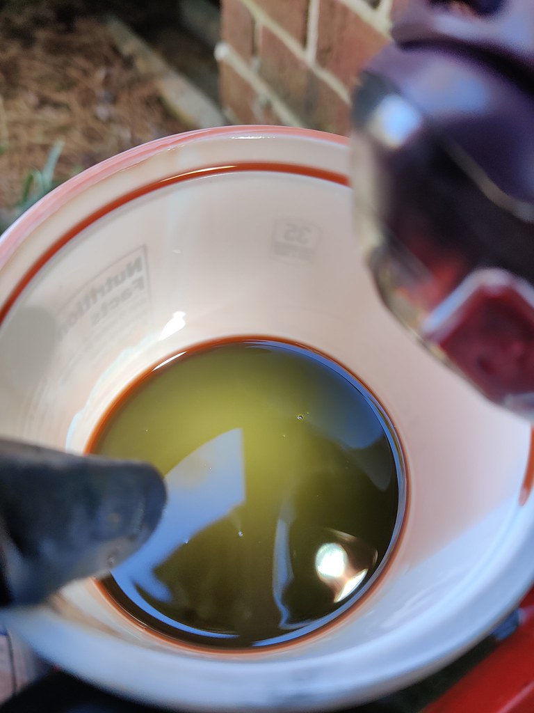

Pictures incoming.

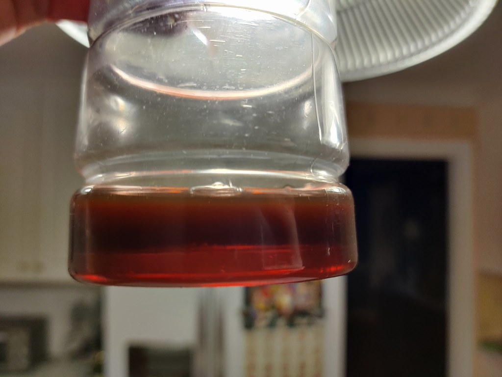

Fluid in the drain pan with light on it
Fluid in a clear bottle from the side with light from the top

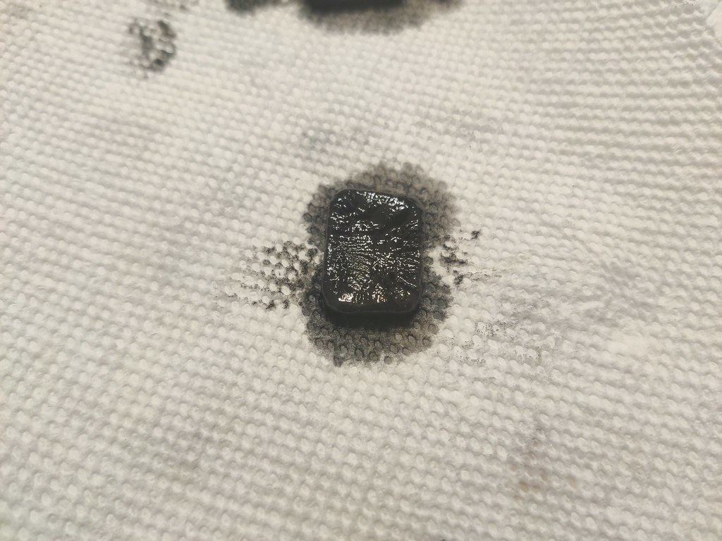

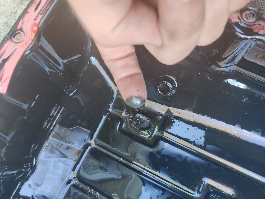

Bottom of the pan, I just touched the magnet with my finger
[url=https://flic.kr/p/2kncrfT]

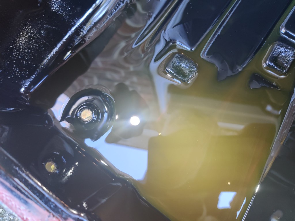

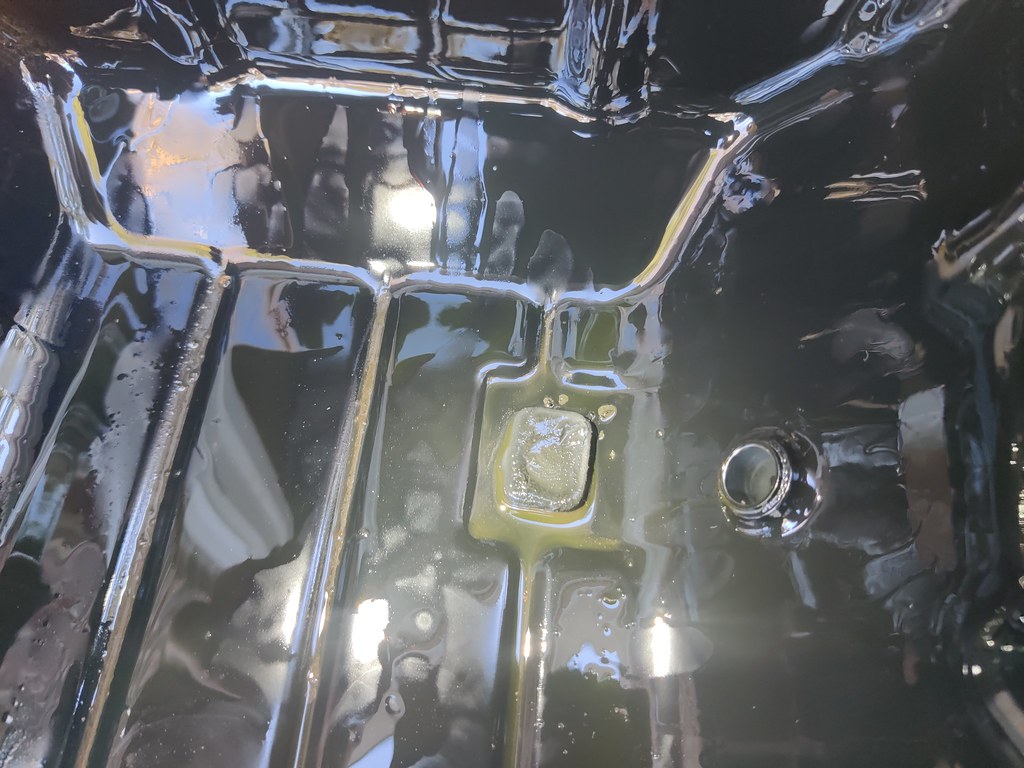

Front of pan (closest to driver, near drain plug)
[url=https://flic.kr/p/2kn85CK]
Middle of pan
[url=https://flic.kr/p/2knc1iN]
Back of pan
[url=https://flic.kr/p/2kn85Jg]

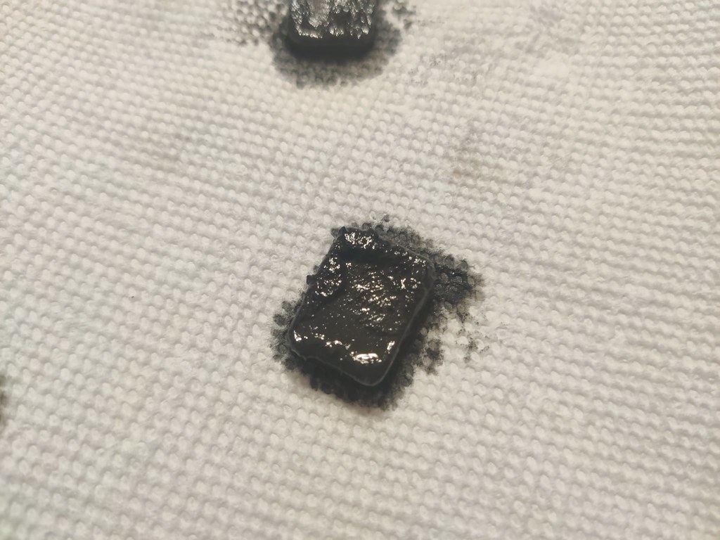

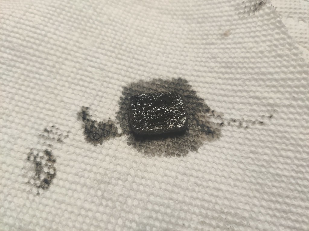

Magnets
[url=https://flic.kr/p/2knbRUP]
[url=https://flic.kr/p/2knbRTB]
[url=https://flic.kr/p/2kncr6Q]

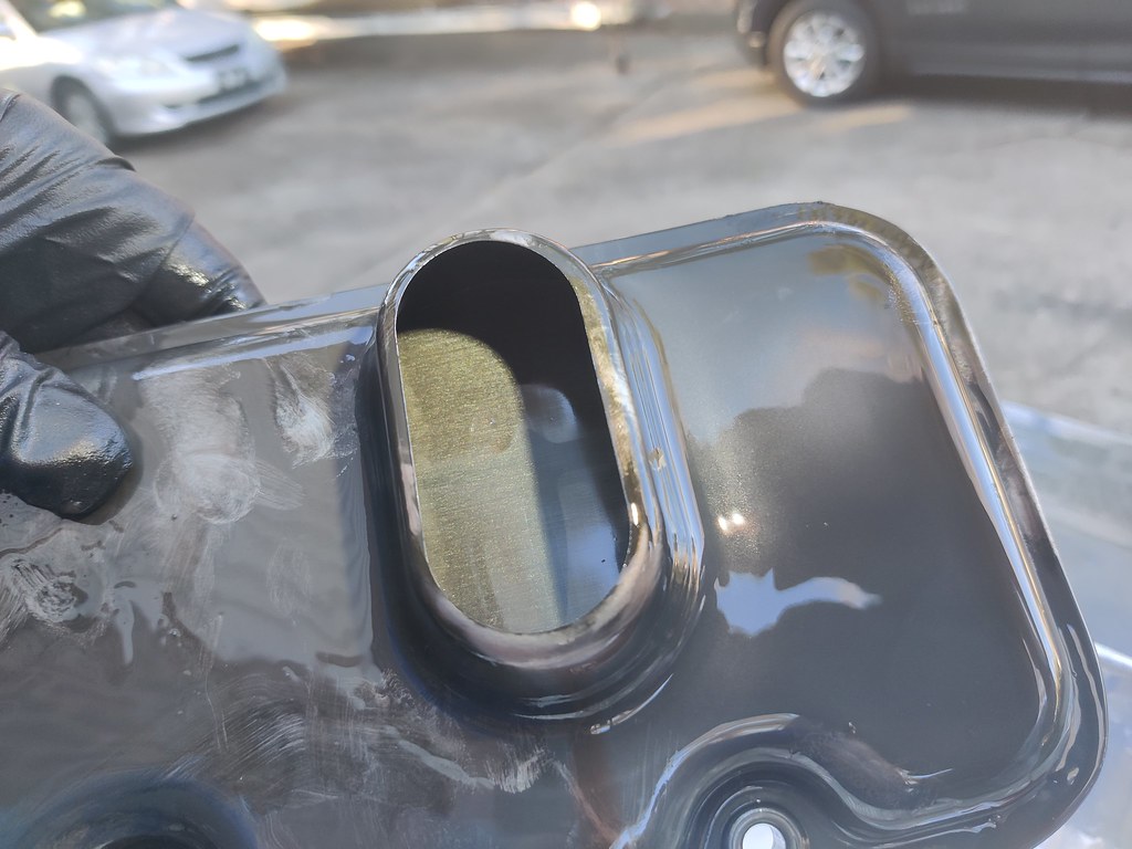

Filter pickup side
[url=https://flic.kr/p/2knbS1A]

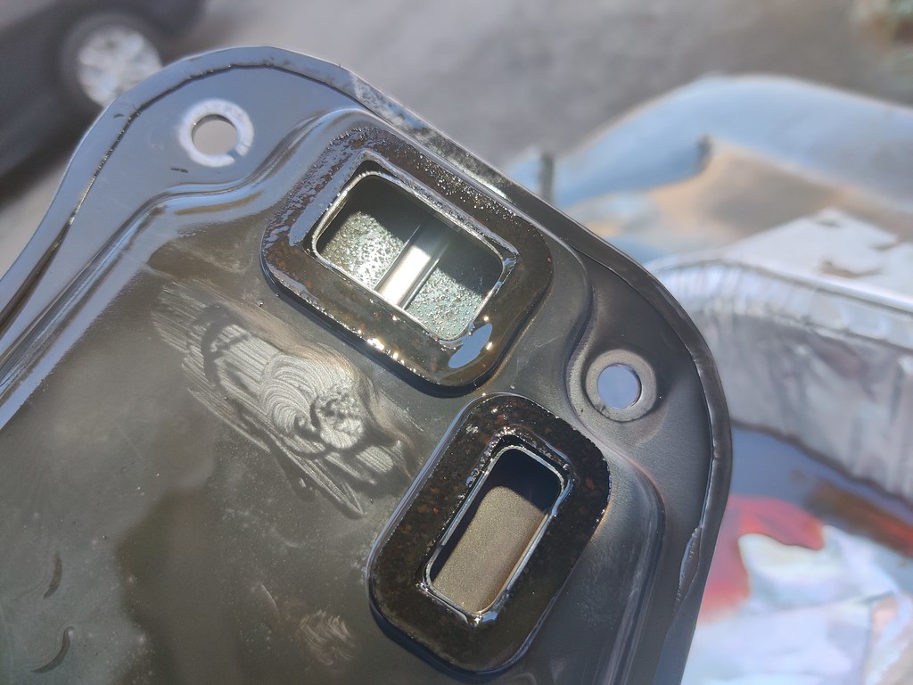

Filter Valve Body side
[url=https://flic.kr/p/2kn7WuR]
So obviously there are only 3 magnets, the fourth magnet had at some point come loose and was actually on top of another magnet. I didn't realize until i went to clean them that they were stuck together. Also you can see in the picture of the pickup side of the filter that the whole thing was covered in this thin black film. I assume this to be normal and just dirt buildup from over the years. The concerning thing about the filter is the particulate matter in the square opening at the front-most part of the filter. The fluid color to me looked horrible from the top, that ugly brown almost green. I had replaced the fluid in the pan and then some (almost 8 quarts) when I spewed all the fluid out after my cooler install, so i wasn't expecting it to be that bad. Also it smelled quite bad as well.
Any thoughts on what you see are appreciated. Thanks!
Very common to have fine metal debris on your magnets. When I exchange myfluid all of it at once. I mostly clean the magnets and replace the filters as well. Those filters will plug in time and reduce fluid flow.

That looks like some nasty old fluid that's floating on top of the new fluid. I wouldn't be too concerned about the stuff on the magnets. It doesn't look like there are any big chunks so that's good. Are you just doing the filter and filling it up or are you going to do a transmission flush as well?
Why is the old fluid in pan look greenish?
I've seen it in other vehicles anywhere from bright red to black, but not Green.
Fellas, are we sure no engine coolant has made it in there?
Coolant plus transmission fluid makes this foamy/frothy/glue like residue. More likely that someone at some point has added some sort of trans fluid additive. Some of those like to separate from the transmission fluid at high temps.
Or maybe someone added motor oil?
Even the nastiest trans oil I've seen still has a bit of red in it when put on a paper towel.
The green color is puzzling.
So the green, part of it may be that i was shining an LED flashlight directly into it while taking the picture on my phone. It does not have the same look as your conventional water-in-oil does at all, however my coolant is Prestone green so i suppose it could be. There's definitely no engine oil in there, the car has been in my family for 90% of its life and I like to think that we are not that stupid....:doh:
You can see if you zoom in on the pic of the trans fluid in the clear container from the side, that there is a small layer of it on top of the red transmission fluid, maybe its just sludge and grime settling on the top of the fluid, cause when I swish it up it doesn't "milkshake" like mentioned.
