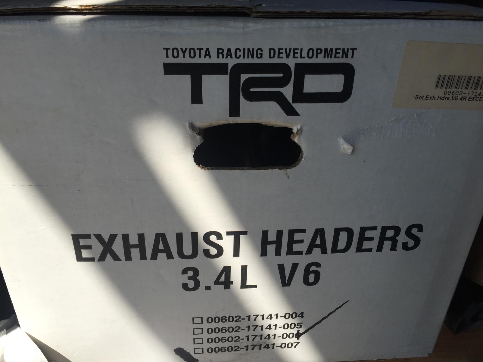

What was the part number for your headers?...
Was it any of these on this box??..
it was one of those numbers. cant remember though. been a while. but i remember trying to sell them and posting here somewhere where i mentioned part numbers. i wanna say it was the 007, but not 100%
