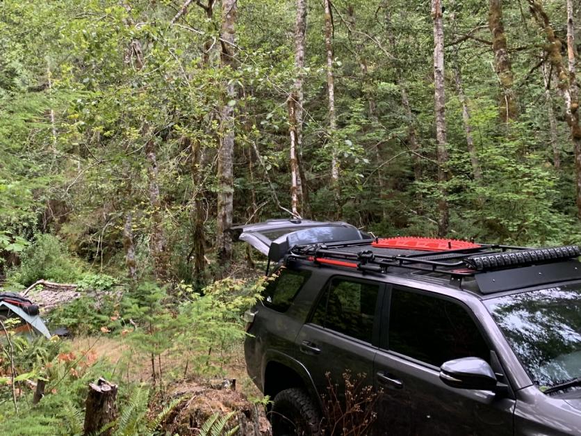

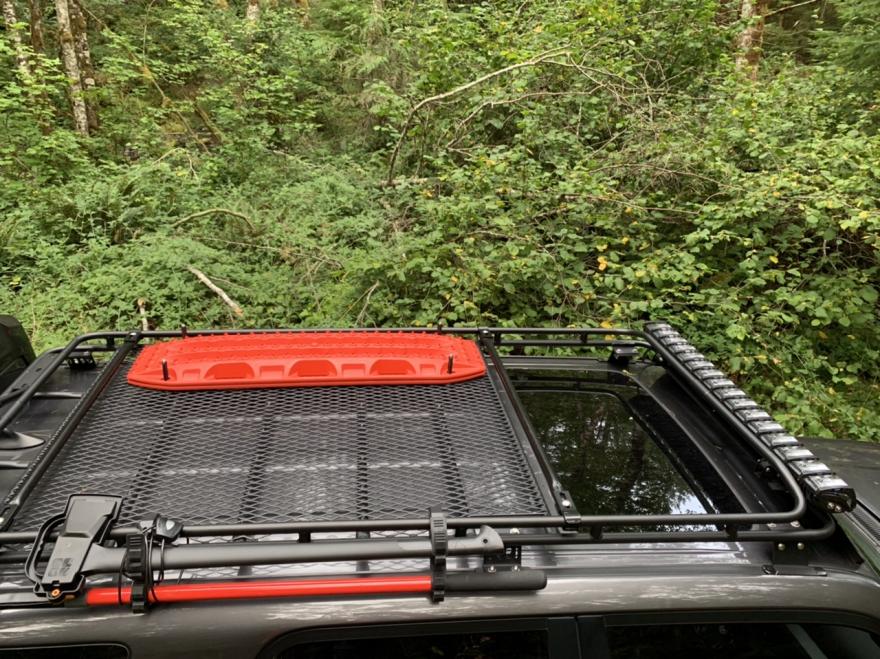

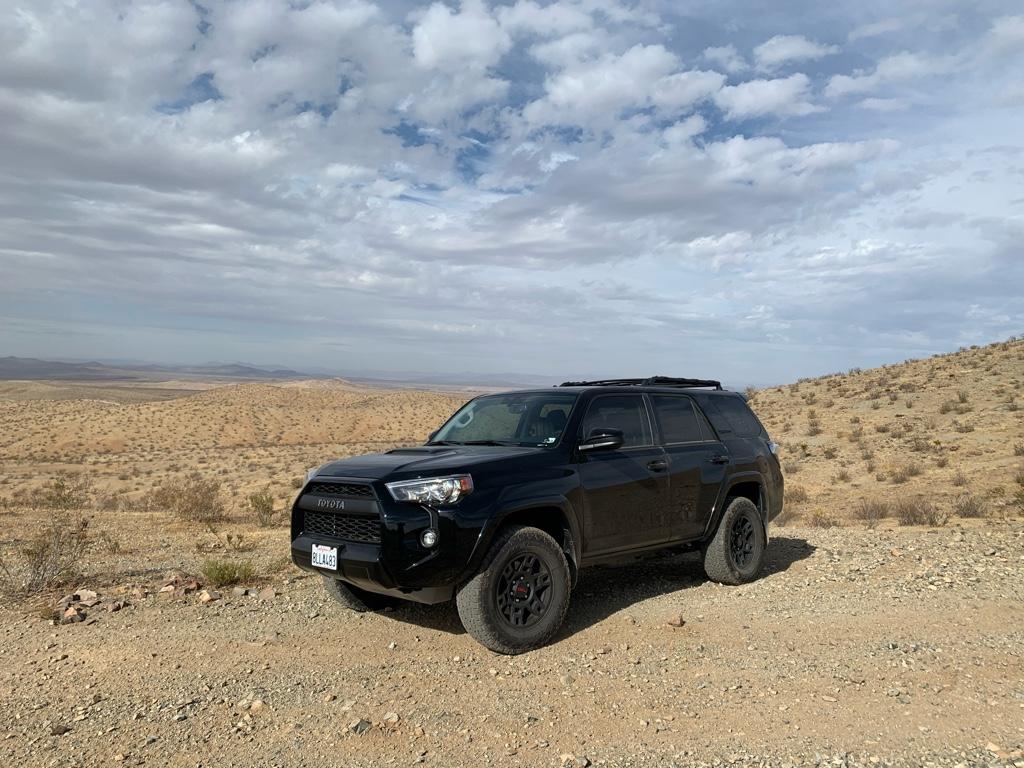

I own a 2019 TRD Pro but, did not care for the extra height and lack of functionality of the stock pro rack so, I modified it to remove the top rail. Now it has a much lower profile and a much cleaner look (In my opinion). I moved the cross bar that was at the front of the top rail down to the lower rail now making for 4 bars across the rack. I don’t have any good close-up photos of the mods but, here’s one long distance shot.
BTW. I noticed that you are in Mission Viejo. I’m in Foothill Ranch. PM me if you are interested or have any questions.
Thanks,
Tom

More pics and details on what it took to chop it please.

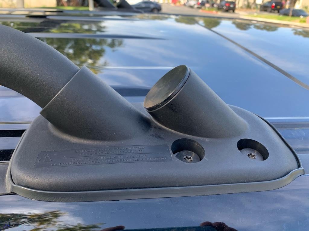

Any chance you can post close up pics on how yours looks like? Curious to see how you covered up the front plastic mount cover hole where the top tube mounts down into and also everything else.

Tom what did you do for the holes from the top bar that go to the front of roof rack mounting location and what about the bar in the back of the rack
The rack comes off fairly easily but, from new, the mounting bolts are very tight with lots of loctite. Just be careful to break one bolt loose then move on to the other before spinning it all of the way out.
For the front foot, I machined a plastic plug that fits tightly into the hole and is held in place from underneath.
For the rear tube, I used a piece of 1 3/4” aluminum tube cut to the same length as the plastic piece it is replacing. I then machined two inserts that were the same diameter as the inside of the stock tubing. Fit them into the tube leaving about an 1 1/2” protruding. I then fit it to the stock rails, drilled through the existing holes. Tapped the inserts and threaded in a new fastener.
For the holes that remained in the top of the rails, I found some grommet plugs and pressed them in.
Hope this answers most of your questions.
Good luck,
Tom

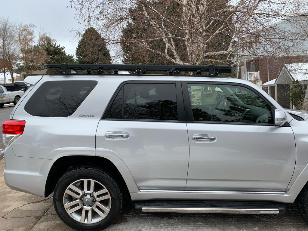

I hate the way the TRD Pro rack looks. Unfortunately I want a rack half the height so I will probably end up with a Prinsu.
Agree... The new TRD pro racks are a step backwards! Check out GOBI, pricey but worth it IMO.
