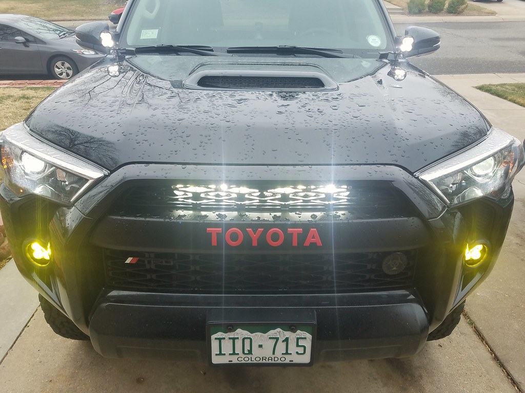

I did the same set up as [MENTION=129593]MTN4RNR[/MENTION] and love it. My only "issue" with the setup is that the grill does block some of the light. Not a big deal. I do have the old grille from before the TRD grille which I could mod to have an opening. Theres a before and after picture somewhere here on the forums of what the output looks like with the grille on and off and its quote noticeable. While it is a small issue, the functionality and low profile of the setup outweighs the "issue" I have.

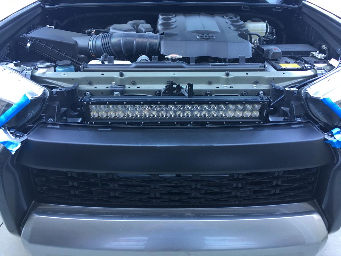

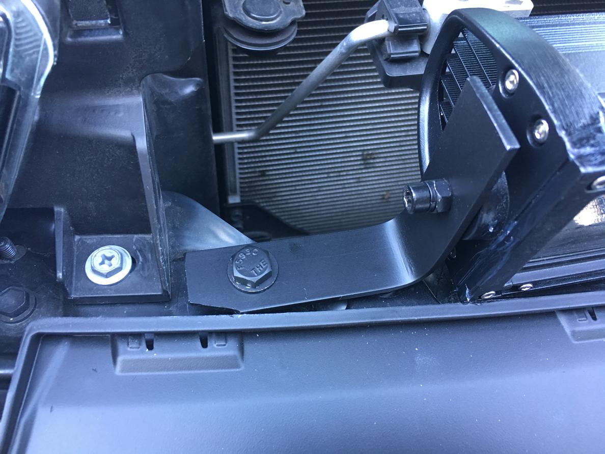

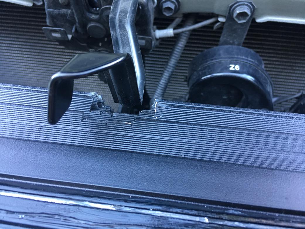

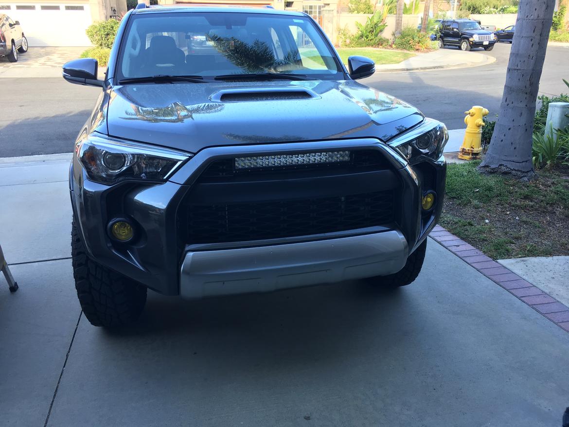

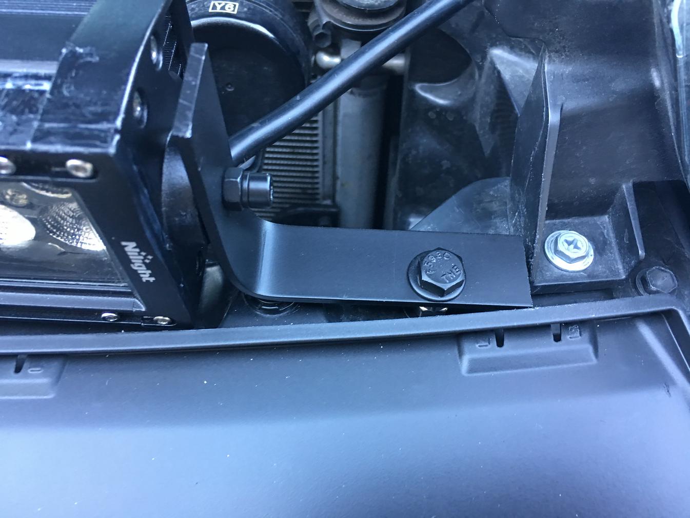

Here is my install. Went with 22” spot/flood. I didn’t want to spend close to $200 on the upper plastic piece so I cut my upper non-TRD stock grill and mounted the light bar. Made the mounts by cutting and bending some aluminum bar stock and painted it satin black. Used the original holes from the stock metal ledge. Used some bolts, washers, and nylon locking nuts and it is solid. Had to cut the aluminum fins to fit the hood release latch. Also added marine silicone to the light bar for extra waterproofing. Stock splash guard/big plastic cover still fits on top.
