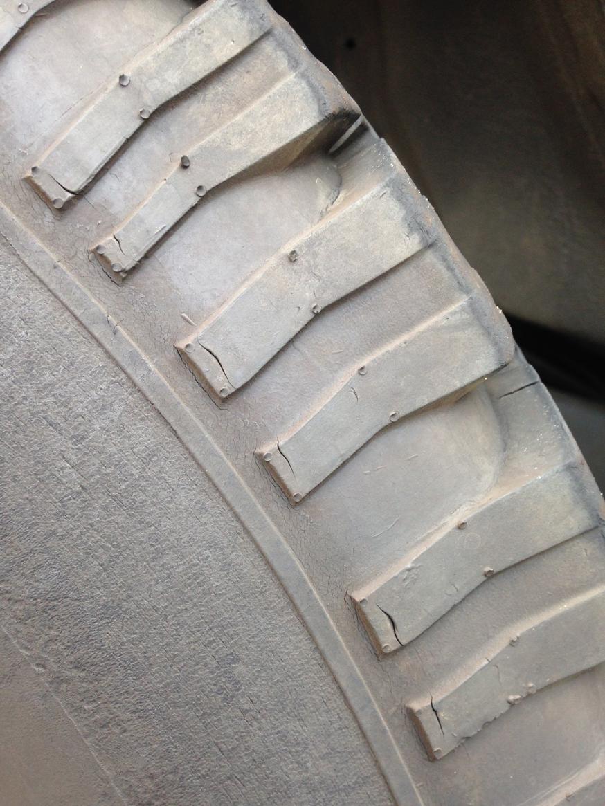

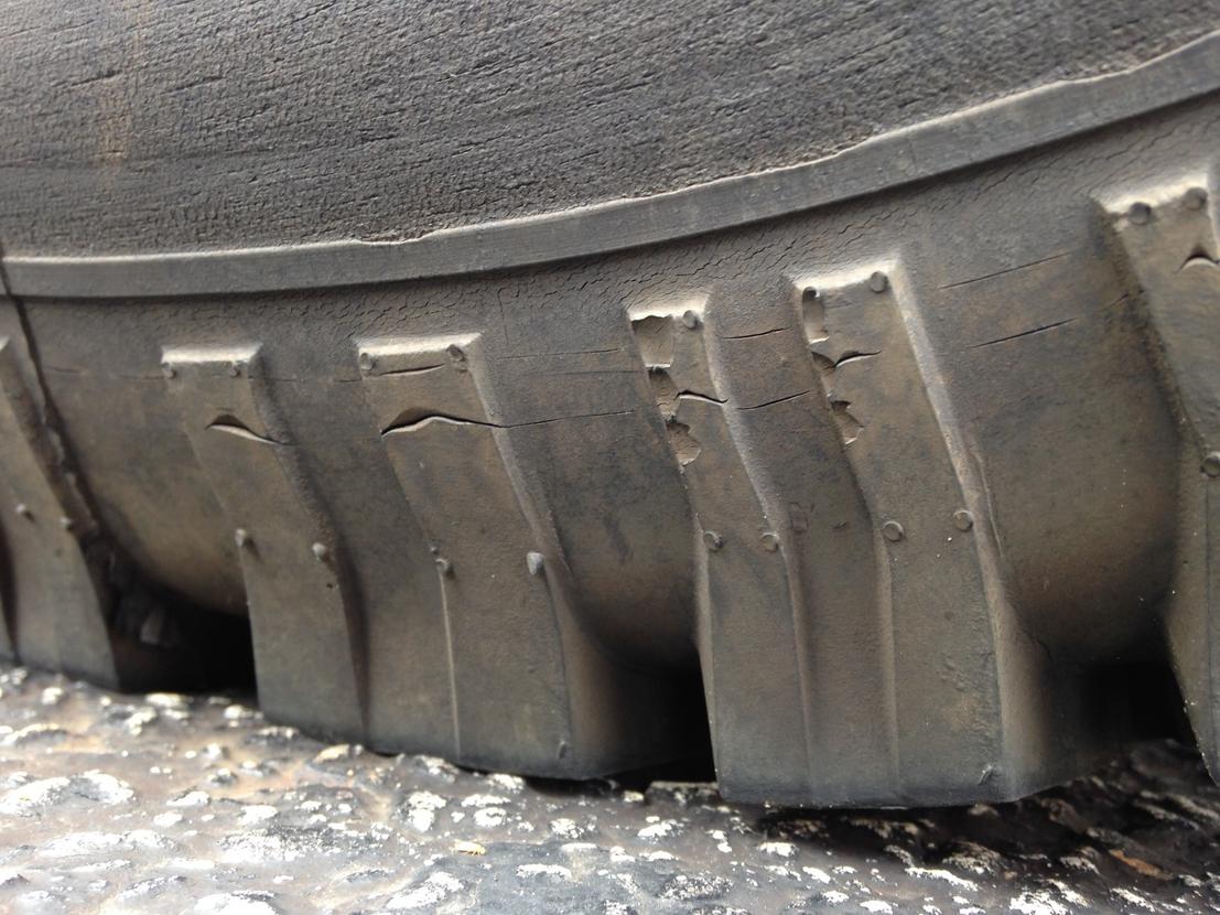

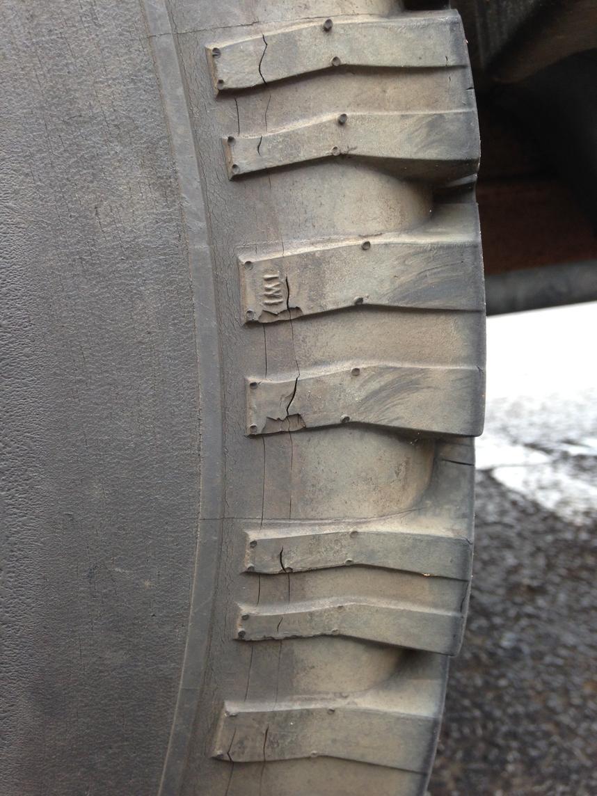

3 of my 4 treadwright wardens have developed these cracks. They were purchased July of last year, were installed a month after that and have about 8000 miles on them.
They mostly see pavement use, but on occasion a dirt road or grassy field (my front yard or side lot). No rock climbing, no mudding, nothing extreme. Always properly inflated and rotated at 4k miles.
Anyone have any idea what could cause this? I sent an email to their customer service and am still waiting to hear back...

I looks like they are cracking right where they attach the new tread. That could lead to a possible tread delamination. You get what you pay for with these tires IMO. They are still used tires.

I believe so. Not that I think it is safe on passenger vehicle tires. Usually a semi truck tire will say on the sidewall that they are retreadable. Not these though.

Im a huge treadwright supporter. I have ran three sets, wife is on her first set and have friends that run them. I also have had the cracks show up on my tires after about a year but I beat them. They have always made it 2-3 years with 25,000 plus miles on the muds I have ran with the cracks. Like stated you get what you pay for and I have not had any issues even with the surface cracks. Wife Wardens are over year old and they look pretty good still and no cracks so I always thought it was my muds that I beat. I run them at 10psi on the trail and have ripped some of the large tread off doing some rock crawling but they always held up good still.
So pretty much I have just ignored the cracks and they still have done me good.
It looks to me like you hit something while spinning your tires.
I thought this too, but can't figure out what it was. These cracks are on the driver side front and rear and passenger side rear. Passenger front is not showing the cracks. Passenger side rear has it the worst.

crawl underneath and check the insides.
those are not cuts, they are cracks.
whether that is bad or not, dunno.
my BFG's have similar-ish cracks...but they are over 10 yrs old now.
Like I stated before. I have the cracks. I live with the cracks. The tires still work. I have driven 1000 mile trip on them before. I get 25-30k miles on my muds. I air them down to 10psi regularly. I have torn the mud lugs right off, which ive done with BFGs also, and they still keep going. If you research online you can find maybe one post on any forums stating they had the retread come off the tire from treadwright. They have stated themselves they have had only 1 incident.

If it were me, I wouldn't worry about it but I would make a habit out of paying attention to them and periodically taking pics for comparison.
If it forces you into the habit of frequently checking your tires, consider it a blessing.

the truth is they are old tires with new tread
