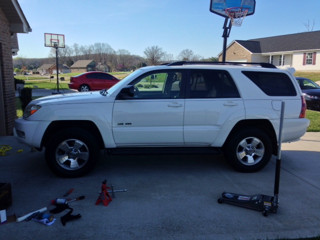

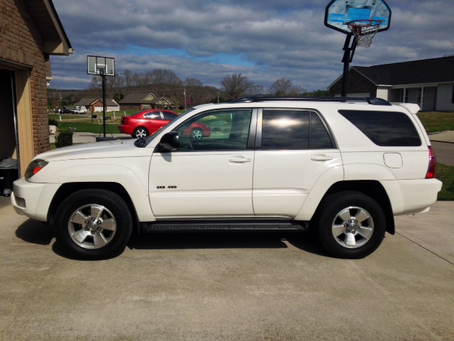

I just installed my Daystar leveling kit, and I'm looking to replace the 265/65 Michelin LTX M/S tires I have with some A/T 265/70 tires. The problem is, the Michelins have about 70% treadwear remaining. I think I can get $400 out of them on craigslist, and I've been considering going with these Treadwright Warden retread tires. Anybody have experience with this company?
