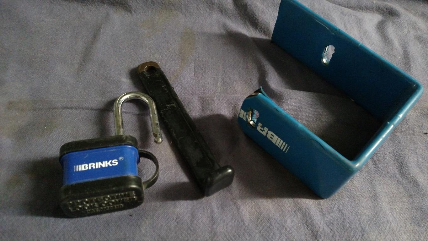

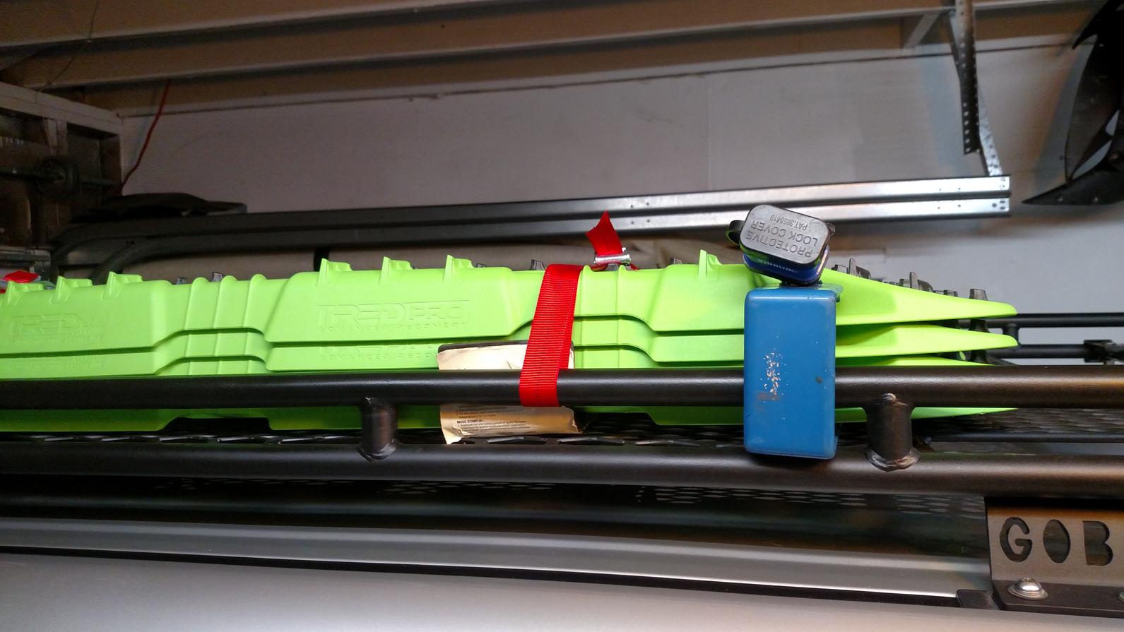

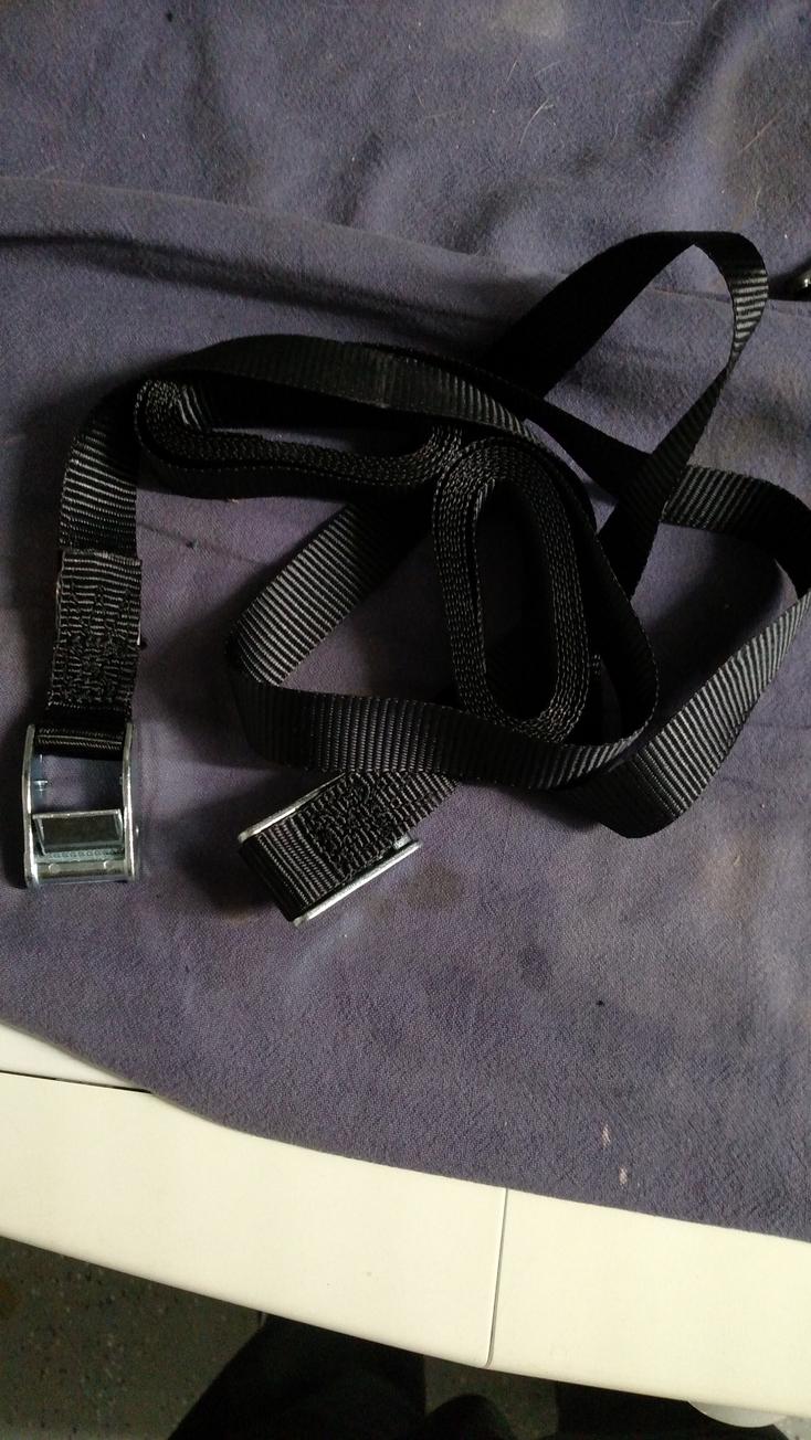

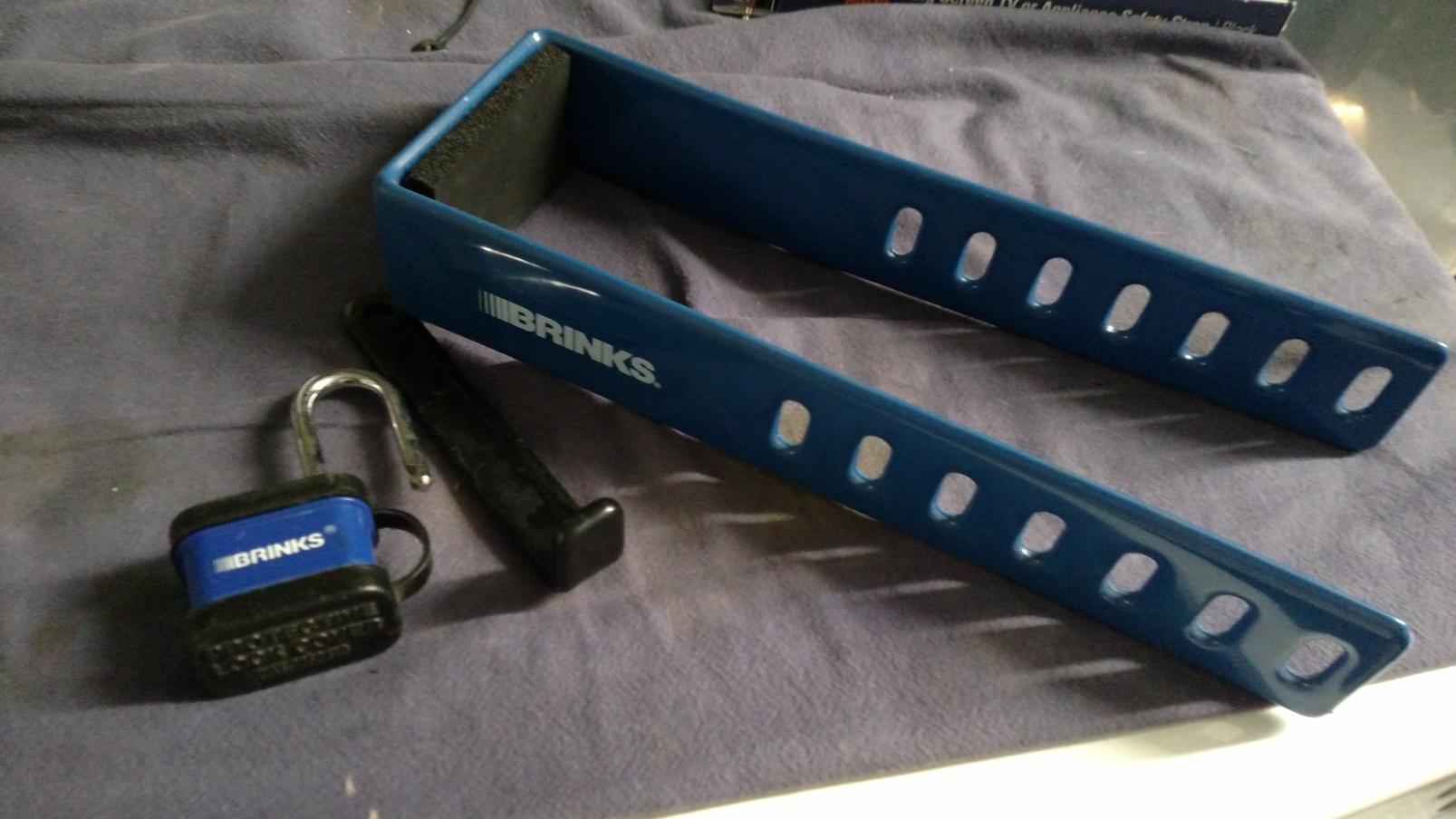

I finally mounted mine on the Gobi. I got some lashing straps and a ladder lock. I cut the ladder lock and use a drill press to make new slots for the locking pin (L shape with the hole for the lock to go thru). I use the reciprocating saw to cut the three drill out holes to look like a slot. The locking piece fits perfect in the hole for the Tred Pro.
