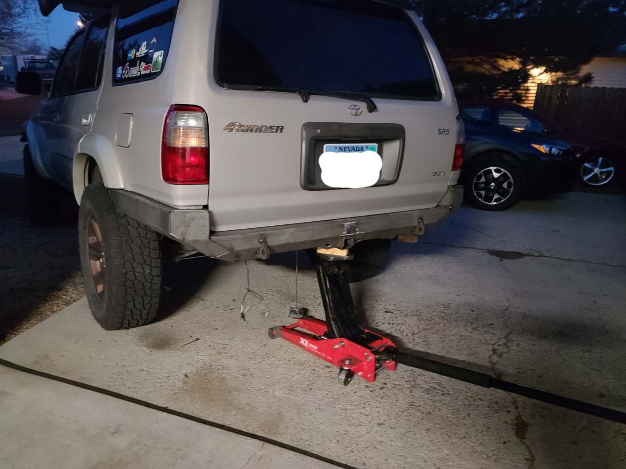

I was able to get the whole rear plate bumper fabd up today. It fits perfect. My only complaint is the gap from the rear or the vehicle around the hatch latch. It's no big deal, but I seems that making the bumper fill that space would be such an easy change in design that it almost seems lazy (unless I'm missing something). All parts are laser cut and they fit together great.

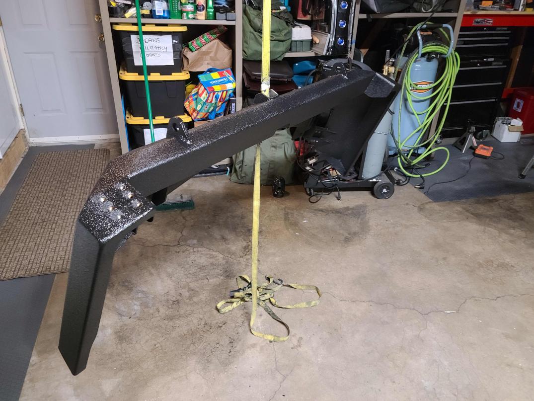

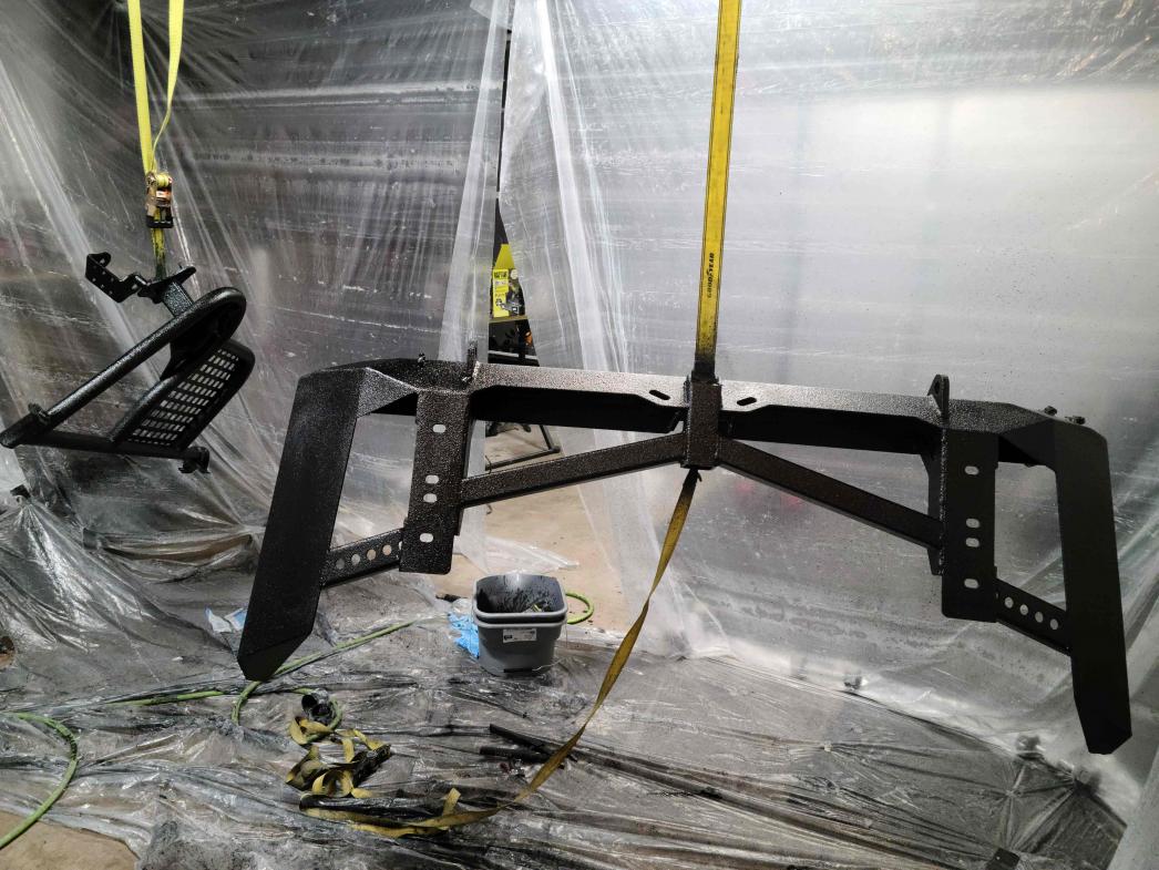

No issues from srq regarding missing pieces so far. Il finish the welding and swingout tomorrow then I'm sending the bumper off to get powdercoated.
The bumper looks great, and the fitment was great on my 4runner. Love the added clearance and the higher receiver!! No tow rating legally, but as long as you use continuous welds and are a capable welder using the correct settings I don't see an issue with utilizing the same oem limits as a guideline. This is an opinion and not advice. The bumper mounting structure is more reinforced than the OEM receiver anyways.

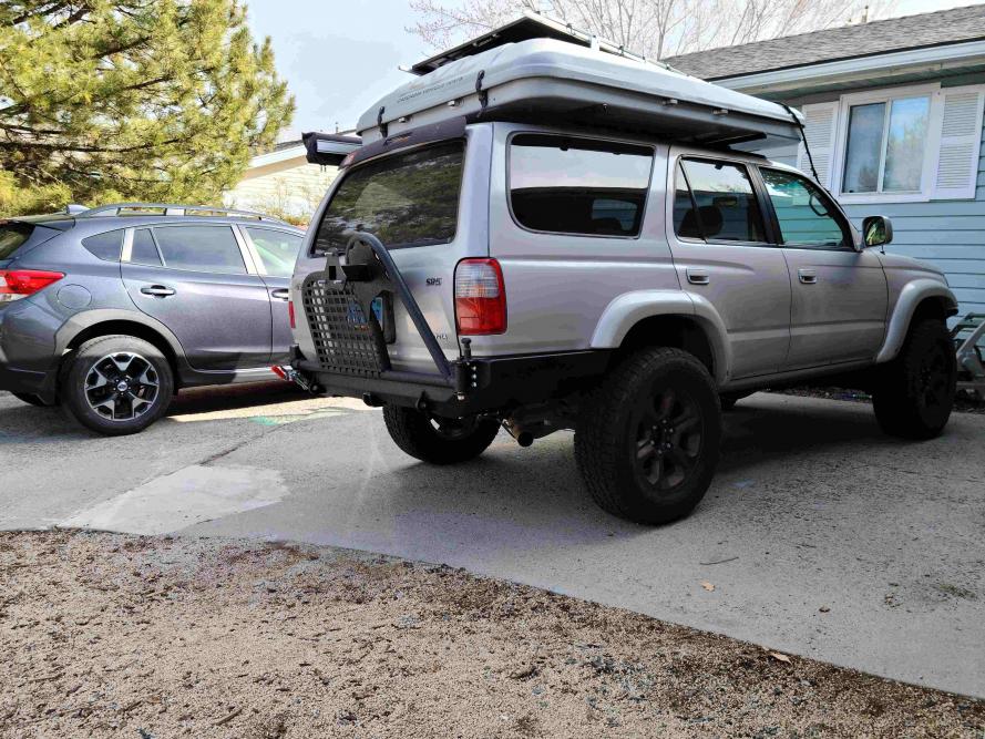

Finished up. Good kit.
Was missing 4 nuts that attach the locking mechanism to the bumper, and they mismatched the hardware for for spare tire mount so I now have 1 correct thread pitch stud and 2 incorrect thread pitch studs for the lug nuts. It's already welded and painted and I didn't check the lugs until today because I figured it would all be correct..little frustrating.
Il probably just get correct nuts to match the "Wrong" thread and deal with it. Won't be taking it off often anyways.
Overall though, 9/10 .hardware was a little frustrating but the fitment is great . If I designed my own I'd make the equipment panel wider to make full use of the space.
