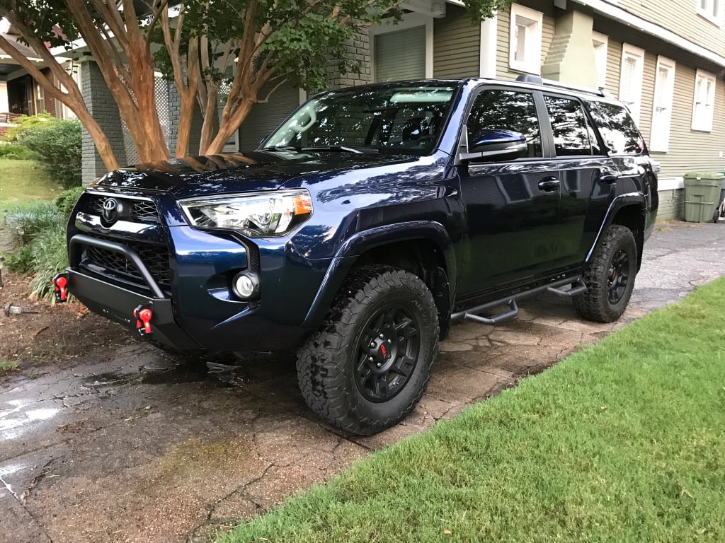

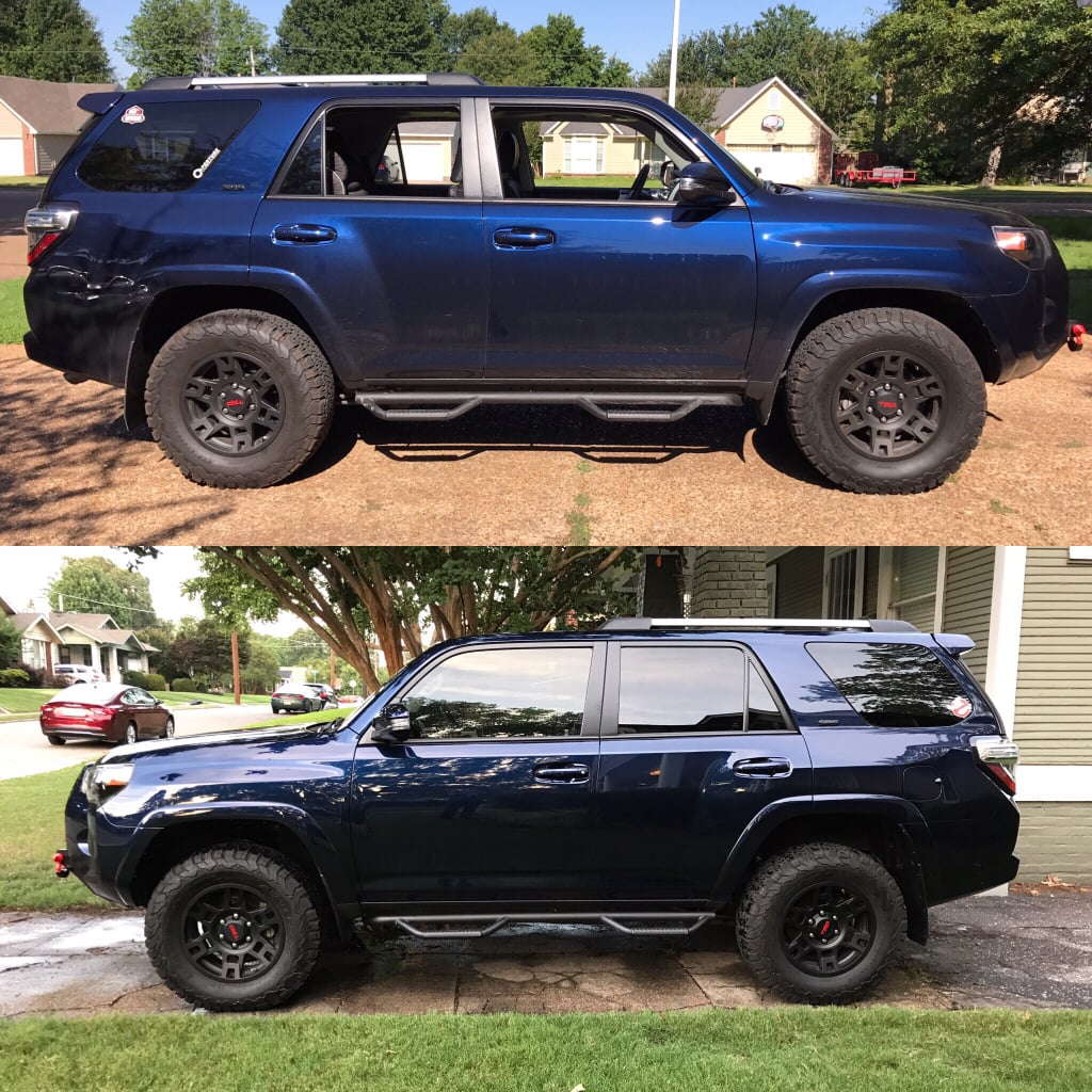

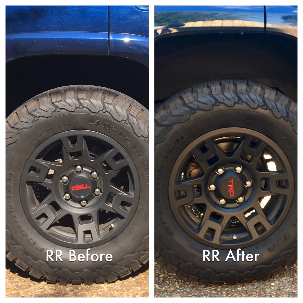

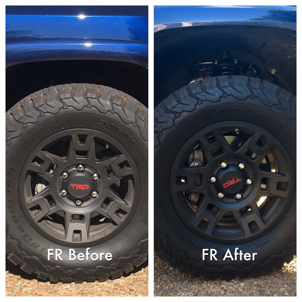

If you're firm on not wanting to swap out UCAs, then the maximum lift will be around 2" to maintain good alignment numbers. I just installed OME Nitrochargers on all corners, OME 2883 coils up front (2"), and Wheelers T-13 coils in the rear (1.5"). Everything came from Wheelers, around $900 shipped. I'm running 265 BFG KO2s, and everything feels great... multitudes better than the floating stock suspension. I'm in Tennessee, so serious rock crawling is mostly out of my realm, but I do use it for camping and light service road/trail riding.
