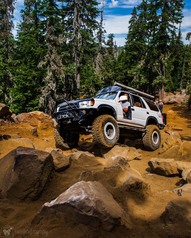

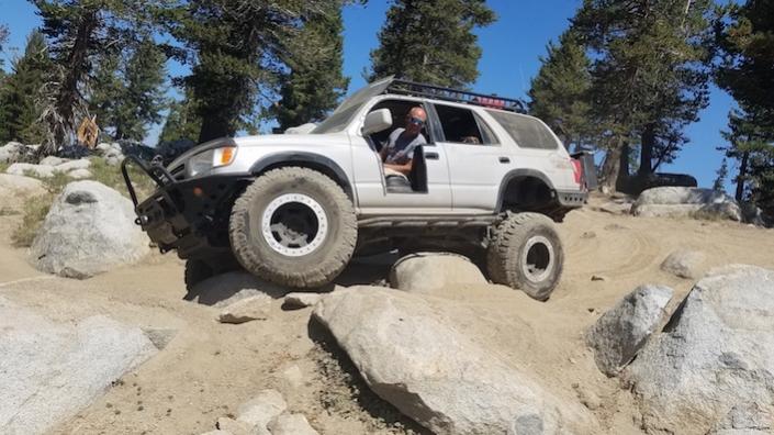

I run Bilstein Tundra valved 5100 and Tundra TRD springs in front, clip on the middle (3rd) slot. Used to run Level 8 MK6 wheels 17x8 -12 offset (like 4.1" BS) and did not have issues with the stock UCA when I was running 33" tires. I found this backspace to be a great compromise.
On the SPC arms, you need to look at what your definition of "heavy use" is going to be. I wheel the snot out of my rig with 37s and have never had them slip - not even a little. But I am a rock crawler and snow wheeler primarily and do not try to see how much air I can catch with my rig. All my friends that crawl have the same experience with them.
