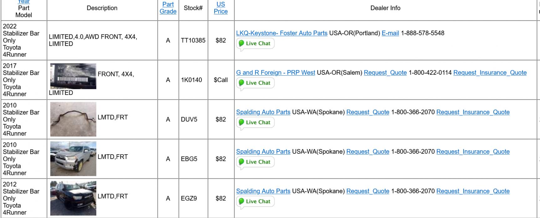

Car-Part.com
Finding a rear or side impact would be preferable of course.
edit: 1st link didn't work

OK, last post for now. I finally found a site that would filter well for model. Did a side by side of Limited & SR5 and the "net" is that the following parts are different on an SR5 4wd vs a Limited 4wd:
For Sr5 retrofit
Front swaybar: 4881135450 (about $180). Note: Limited PN is 4881135460
Front swaybar bushings (need 2) 4881535140 ($30/ea). Note: Limited PN is 4881535130
The Brackets (to attach the bushing to the frame) and the links (to attach the swaybar to the control arm) are the same for either of these swaybars. Makes sense as the only difference is a marginally larger bar.
Compared at site: Front suspension. Stabilizer bar & components.. 2022 Toyota 4Runner 4.0L V6 A/T 4WD Limited Sport Utility | Toyota Online Parts Depot, Cochrane AB
Pricing at site: FRONT SPRING & SHOCK ABSORBER. 2022 Toyota 4Runner LIMITED | Toyota of Lake City, Seattle WA
YMMV. Hope this is helpful.
