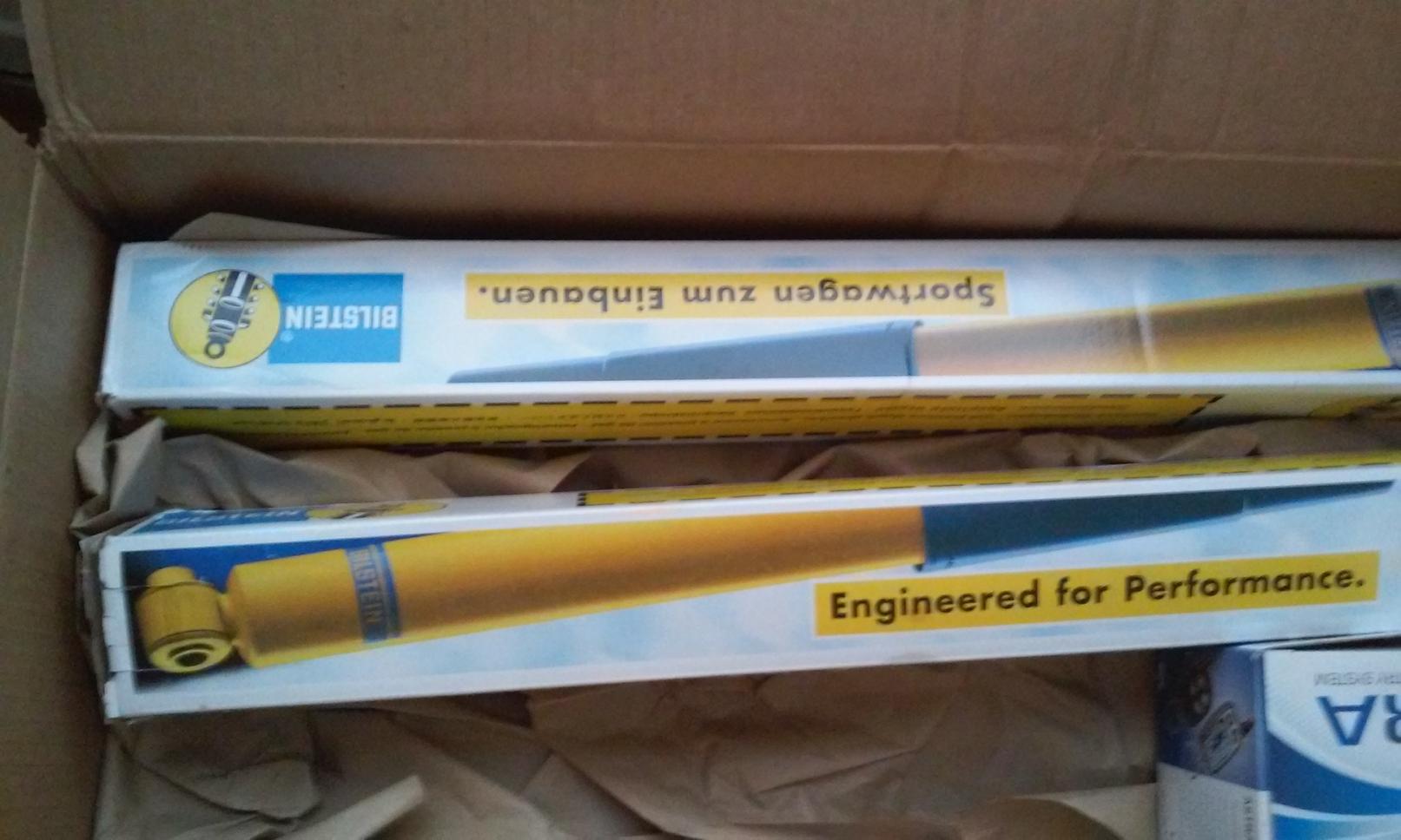

Greeting members......My billies came in and i will be swapping it out next week.
99 LTD, stock suspensions with OE Tall coils (using these).....I will be putting on the Taco ARB bumper with a winch in the near future,......occasional camping, off road, fishing 4-5 times a year...so
What setting on the Tundra shocks should i have the perch set @ to get the (70%-urban, 30%-off road) best of both world and have a 1.5" lift in the front?

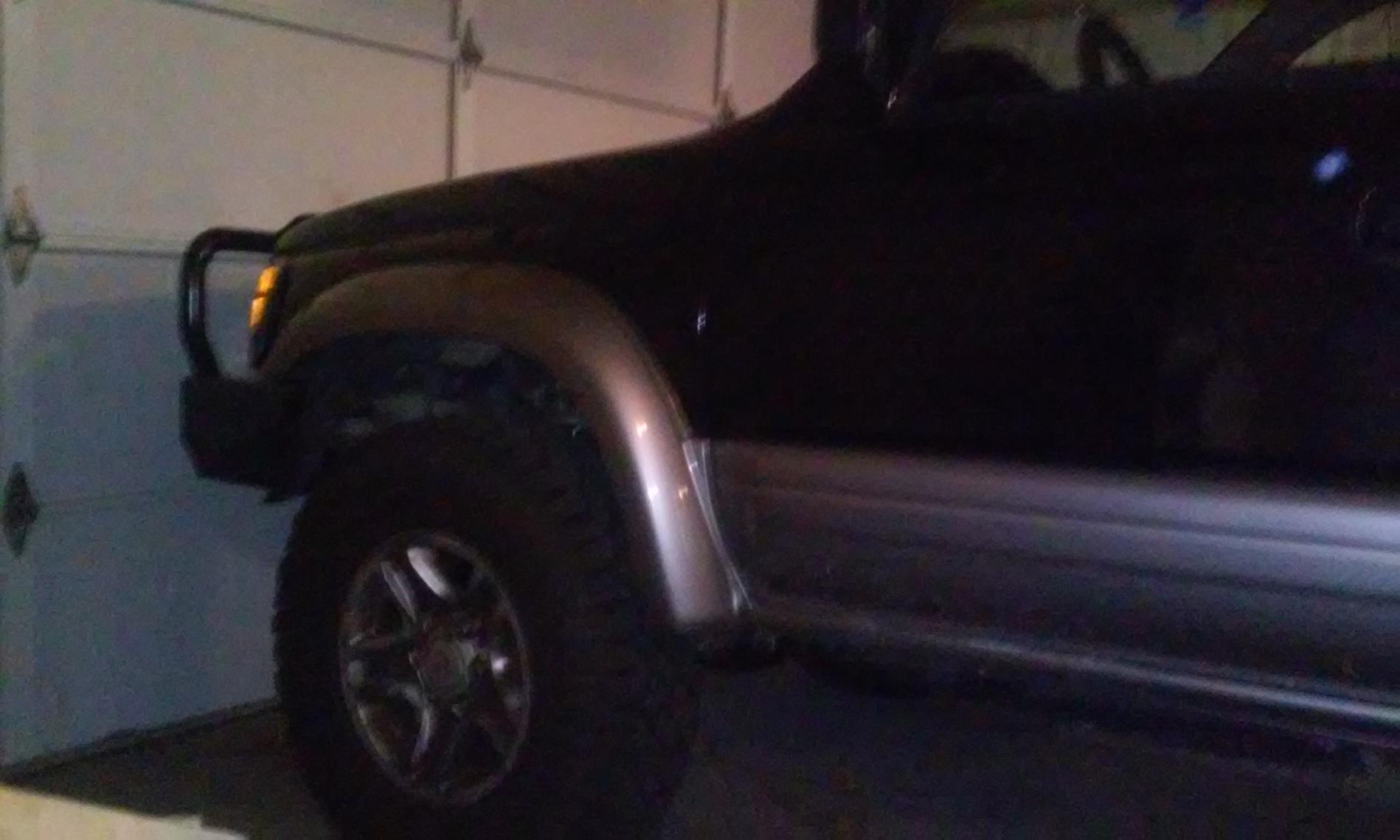

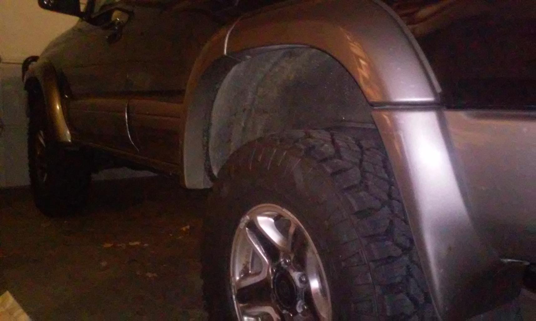

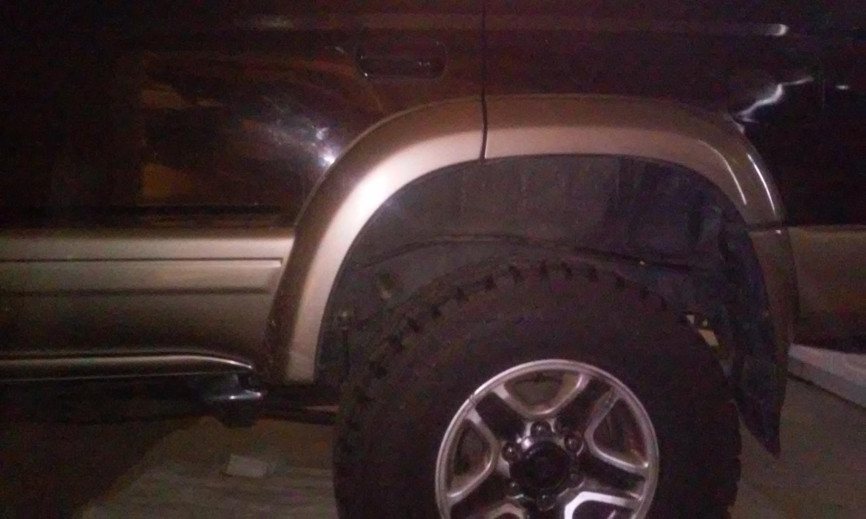

Well, had a chance to get my LC 7 wrap on the rear with Taco 5100
Front is on the 3rd perch, back has about 250+ pounds of stuff
I'll get better pics later, overall i am thinking of getting OME 881 because i have bumper. Front has settled about .25" since 2 weeks ago.
