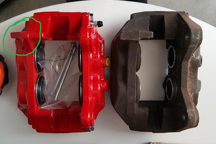

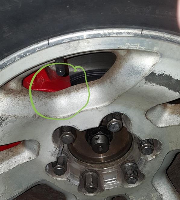

Hey Brillo I took a couple of pics so you could see what I was dealing with. I am not sure maybe a different brand of caliper would of worked in 199 and this is unique to Callahan? There is a tab that sticks out that is just enough that it would not fit. With the 1/4 spacer I can get just the tip of my pinkie in there now. Granted it probably would not of taken much to grind it off.

Grinding the wheels isn't that hard, I did it as well. It's just a high point that needs to be flattened out. I had no issues with balancing as I took a uniform amount of aluminum off each spoke.
Wow..... Interesting....
