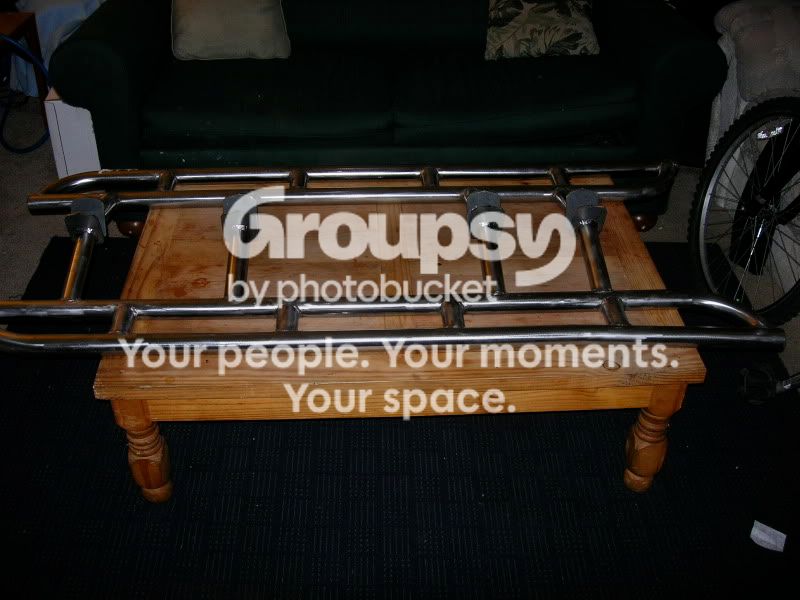

Not a whole lot has happened to the 4runner other than just getting used. I sold my Whitson Metal works Roof rack, that was sad but its at least getting used rather than collecting dust in the garage. I sold it because I just moved to Norcal from Socal, the extra cash and not having to move it was nice. Plus it killed my MPG and I knew I was going to be putting some miles on.

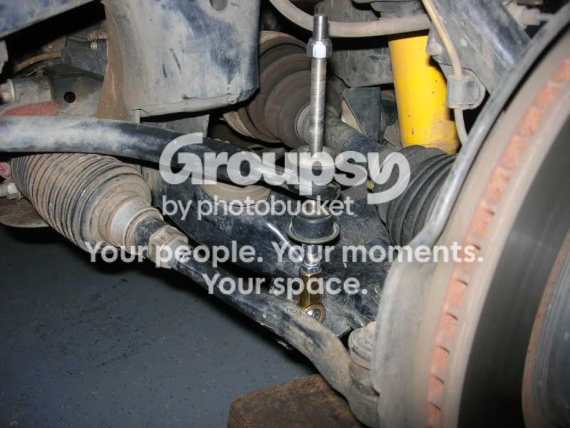

I have been having some strange wandering issues and my tires are wearing pretty strange. I assumed I had worn out LCA bushings thanks to some squeaky bushing noises that i thought was my sway bar, it wasn't. So I decided to swap them out. Here is how bad they were.
Video>>>>>
This job got really fun, really fast when I found out my passenger side alignment Cams were seized nice and tight. Drivers side cam out easy, probably due to the oil that inevitably gets on them from the oil filter. I had the privilege of burning though 7 Sawzaw blades cutting the two Cams free....took 3 hours to get the one LCA out.... So quick PSA. if you have over 200k miles, change your LCA bushings. If you haven't done so, grease them up generously before reinstalling them so you don't have to do what I had to do.

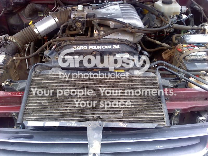

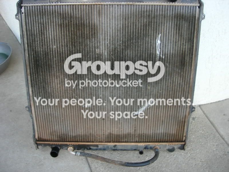

Any photos of your tranny cooler? My apologies if I missed it. From your first post, looks to be a salvage yard special...
Its in post #3. And yes, it is a salvage yard special. its been a long time and i dont remember what exactly it came from, but I think it was a late 90s Ram 2500...little overkill :uzi:
Edit - it looks like this: https://www.amazon.com/APDTY-Automatic-Transmission-1995-2002-52028574AG/dp/B074NT9ZW9
Turns out its the trans cooler for a 95-02 5.9 cummins...hehe
Thanks for the link. I didn't see it the 3rd post... Dang that is big. That explains the exceptional cooling you experienced!

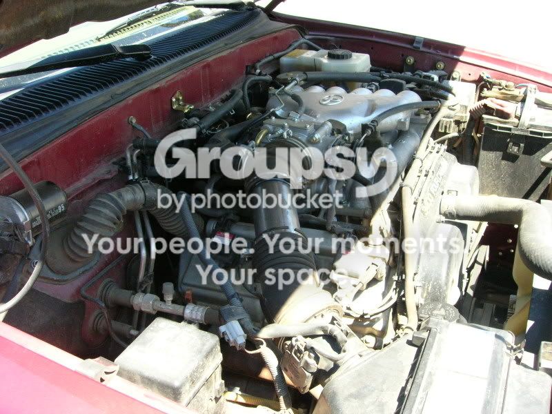

So my water pump gasket developed a leak about 6 months ago. It got really bad a couple weeks ago. Decided just to do the timing belt and all associated parts with it. Cam and crank seals, Water pump, pulleys tensioner, spark plugs and an oil change while I was in there. 291,512 miles
I didn't have a seal driver tool so i made one with some scrap wood and a hole saw, hopefully this will help someone in the future. This worked great!
