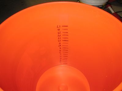

if you have time to do a drain and fill you have time to do a bucket style full flush. It will be less messy.
use the hash marks on this bucket as a rough guide re # of quarts out and in.
