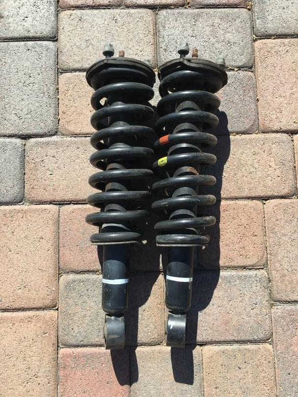

Jstim, I was unaware that the factory struts came with the perch settings. Is this the case? I am pretty green to all of this suspension stuff, but I was under the impression the Bilstein tundra struts were adjustable and the stock factory were stationary in their placement. For what it is worth, this is what they look like. Off of a 2003

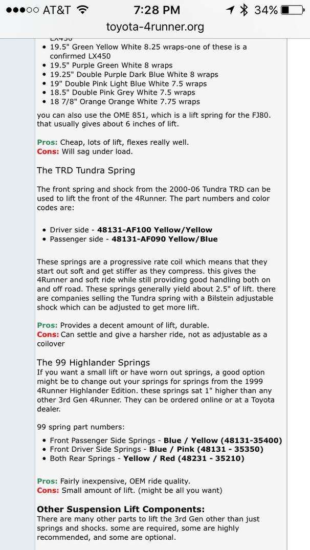

Have you read this link? Check it out!
http://www.toyota-4runner.org/3rd-gen-t4rs/66976-3rd-gen-4runner-lift-information-faqs.html

I have definitely looked that one over quite a few times as well as scouring the rest of the forums. The catch is that I'm not using the TRD coils as noted by the markings on the ones in the pic. That's really where I got hung up, I'm sure it would still work. But would probably net me some sort of lift if I just bolted those ones on (being the non TRD coils from the picture). That's where I was thinking I could swap my 3rd gen coils on those struts to get struts that are supposedly in good shape and still keep my ride height. Unless I am missing something, and it is very possible I am, it hasn't really been covered in any of the lift or build threads that I could find.
