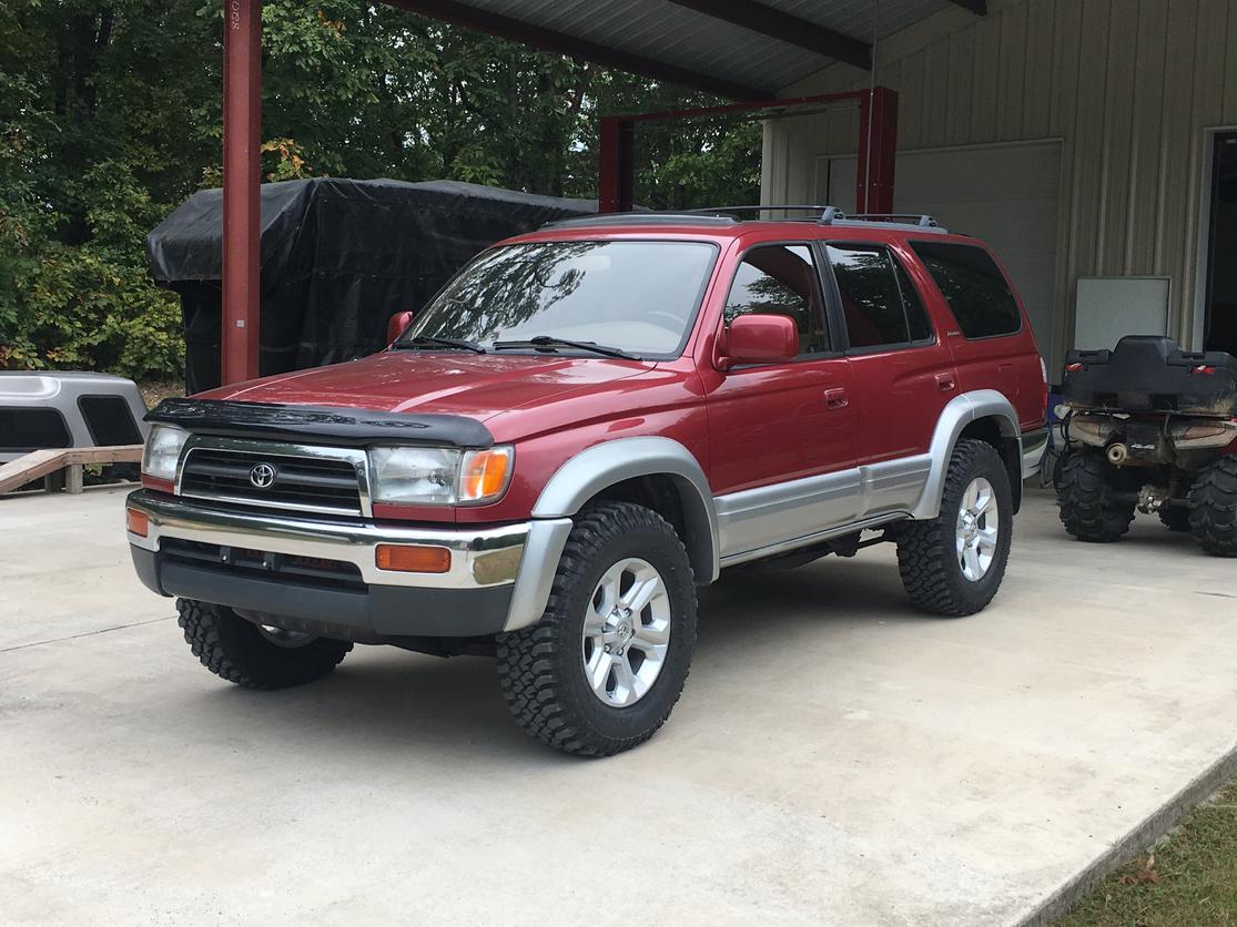

I assume the CL ad means these:
http://www.toyota-4runner.org/3rd-gen-t4rs/25718-4th-gen-wheels-3rd-gen.html
Yes, they'll fit with the TBU. See this thread for verification: http://www.toyota-4runner.org/3rd-g...ements-231mm-13wl-tundra-calipers-rotors.html
Thanks, Link & Ed.
I appreciate the help. Link, that is a beautiful ride! the Red with silver fender was what i was looking for, but had to settle for black with a new engine due to my daily driver being dead in my driveway.
