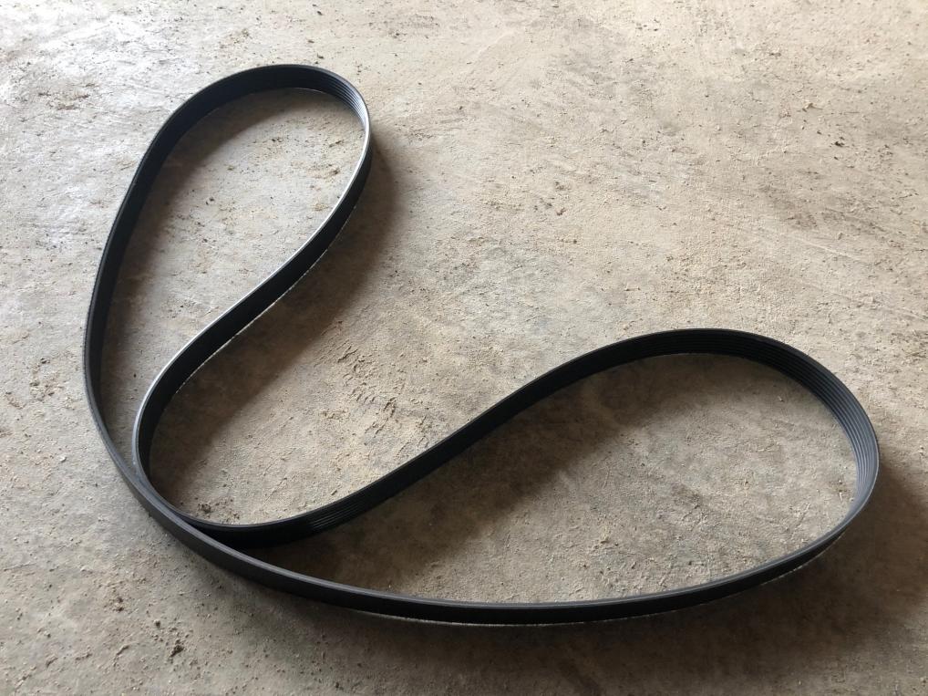

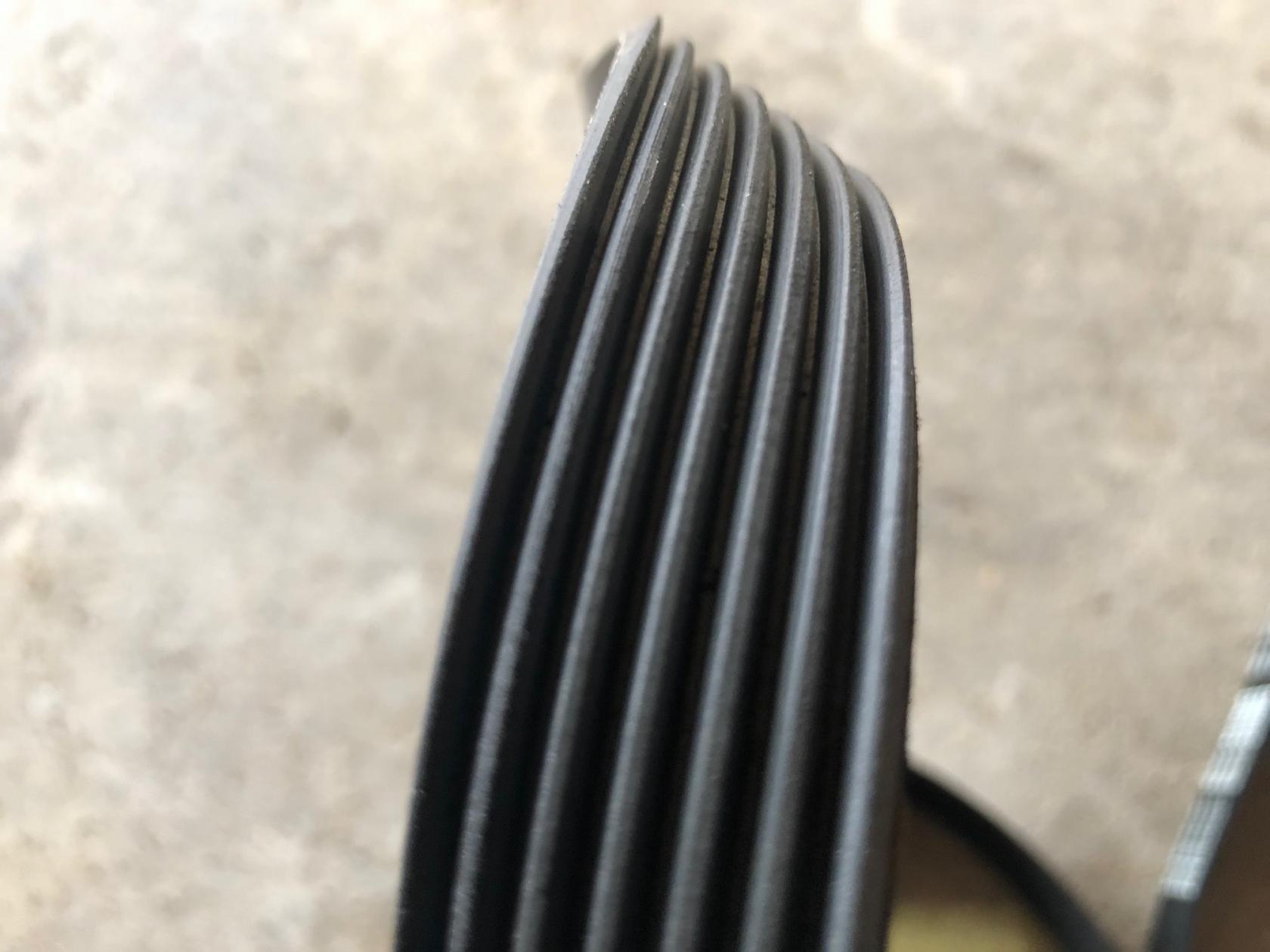

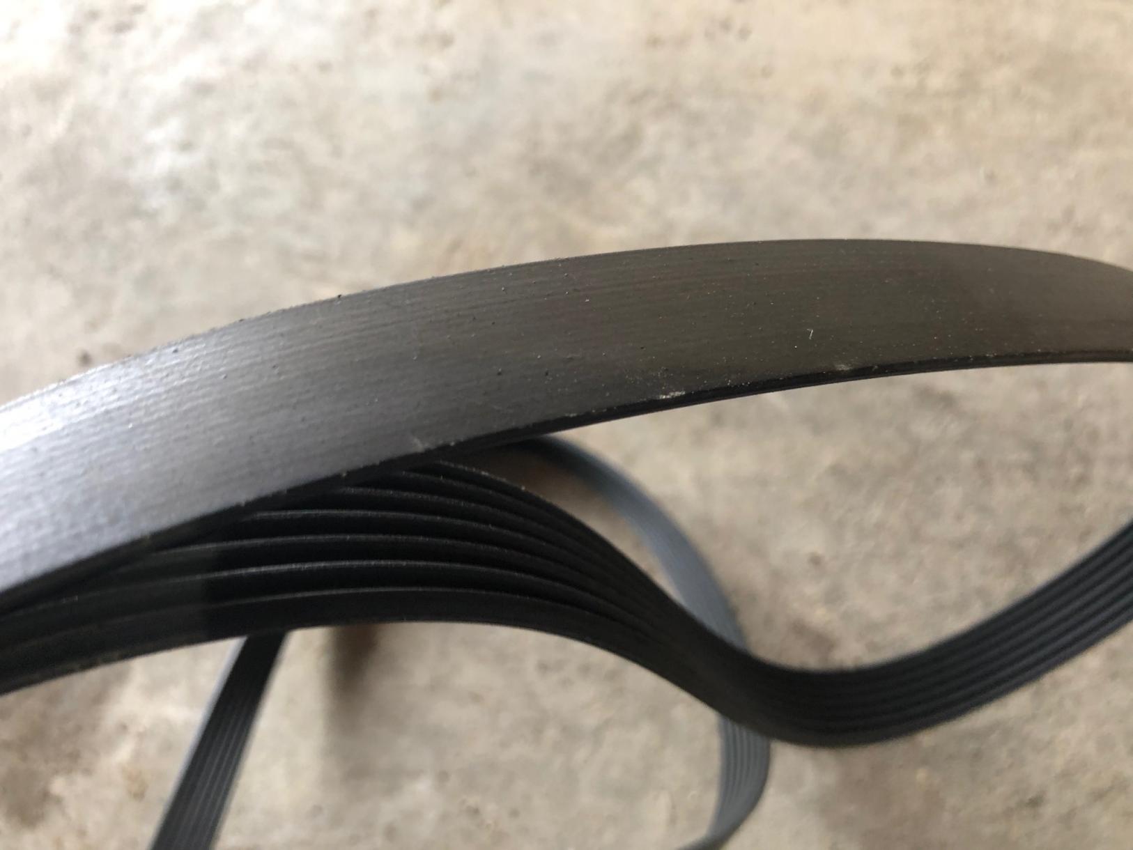

Trapped at home because of the virus figured I'd get some maintenance done.
Changed today with another gates, pics of old belt below.
Looks like it could've gone a lot longer LOL
Old one stretched maybe half an inch longer than the new belt.
I do periodic visual checks of the belt every oil change and was wondering why there was not much sign of wear.

Agreed - im also on here bc of downtime.
I visually inspect mine regularly, but the wear on each one is different. Like suspension theres no definite need to change it at certain mileage
I just did a full maintenance at 130K miles that included radiator, water pump, t-stat, hoses, pulleys and serpentine belt. None of the old parts looked anywhere near failure, really did it out of an abundance of caution and that fact the vehicle is now 17 years old. The serpentine belt looked just like the one pictured. I don't know if they fail by chunking out teeth like a timing belt often does or if they develop lots of cracks on the underside and separate but mine wasn't doing either.

Depends on what the belt is made of, that one looks a little glazed but not too bad. I've noticed on the aftermarket belts they're a bit more plastic feeling/ looking, when they wear they get rather glazed and a bit harder/shinier? (Can't seem to find the right descriptor...) makes me wonder if they use a similar material to timing belts which can look good even though they're worn.. They will usually start developing small cracks that become more obvious over time perpendicular to the ribs, I've seen a couple with missing chunks, but not often. The factory ones seem to stay more supple feeling even after a long time and with cracks in them.
Something entertaining if you're bored is running a pick through the grooves and seeing how many ground up rocks and such get embedded in those belts. :)
