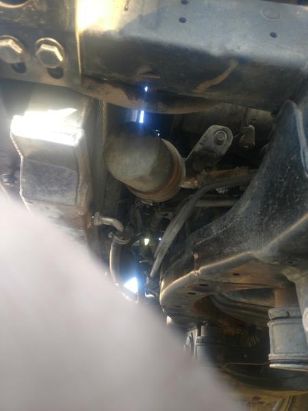

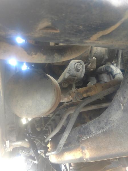

I have a tundra/4runner 4.7 in my 99 Tacoma. I am using the tundra oil filter adapter. I was told that the 4runner adapter might move the filter back a little. I am interested in creating a little more space between my radiator and filter.
For those that can, I would greatly appreciate you taking a picture of your oil filter and the part it screws to showing it's relationship to the AC compressor.
Current setup:
To say space is tight, well that would be an understatement..

I bring this up as I look at your first filter and thinking the 4runner mount will bring the bottom of your filter toward the back of your rig and close to your swaybar.
Interested to see how it works out...
