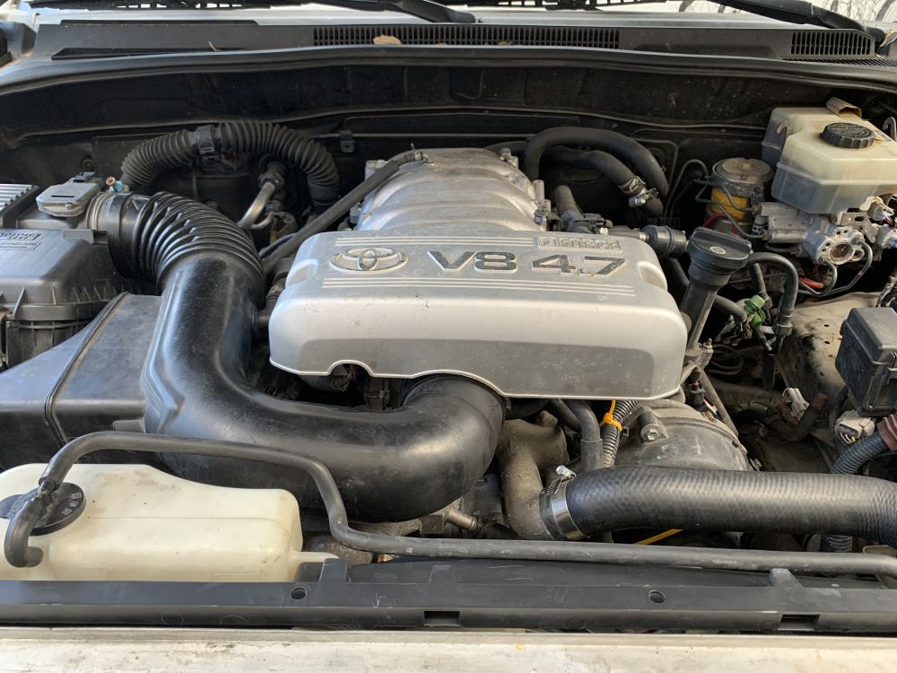

Rear main seal on my 2003 V8 is leaking.
Local shop quoted it out and listed 3 parts. A torque convertor seal, rear main seal & and O ring ... but didn't give me part #s.
Are these the right parts #'s for my V8 and is there anything else to be done "while I'm in there"?

Picture because we all like pictures...

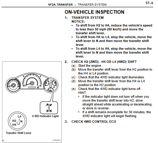

I haven't researched this in awhile, but the link you posted seems to be pretty close as far as applications. I think one of the other cases is for the SR5 with the part time electronic dial actuator, with no center diff lock. The other is the electronic dial actuator full time 4wd WITH the center diff lock, and you are correct about the VF2A being the manual J-shift. This is the case I did my swap with. I found a page in my 5th gen repair manual that confirms this is the manual shift case.
  • Screenshot 2024-06-08 at 06-29-35 020001-1000M_S000J_72WGG_T0081.fm - 020000.pdf.png
