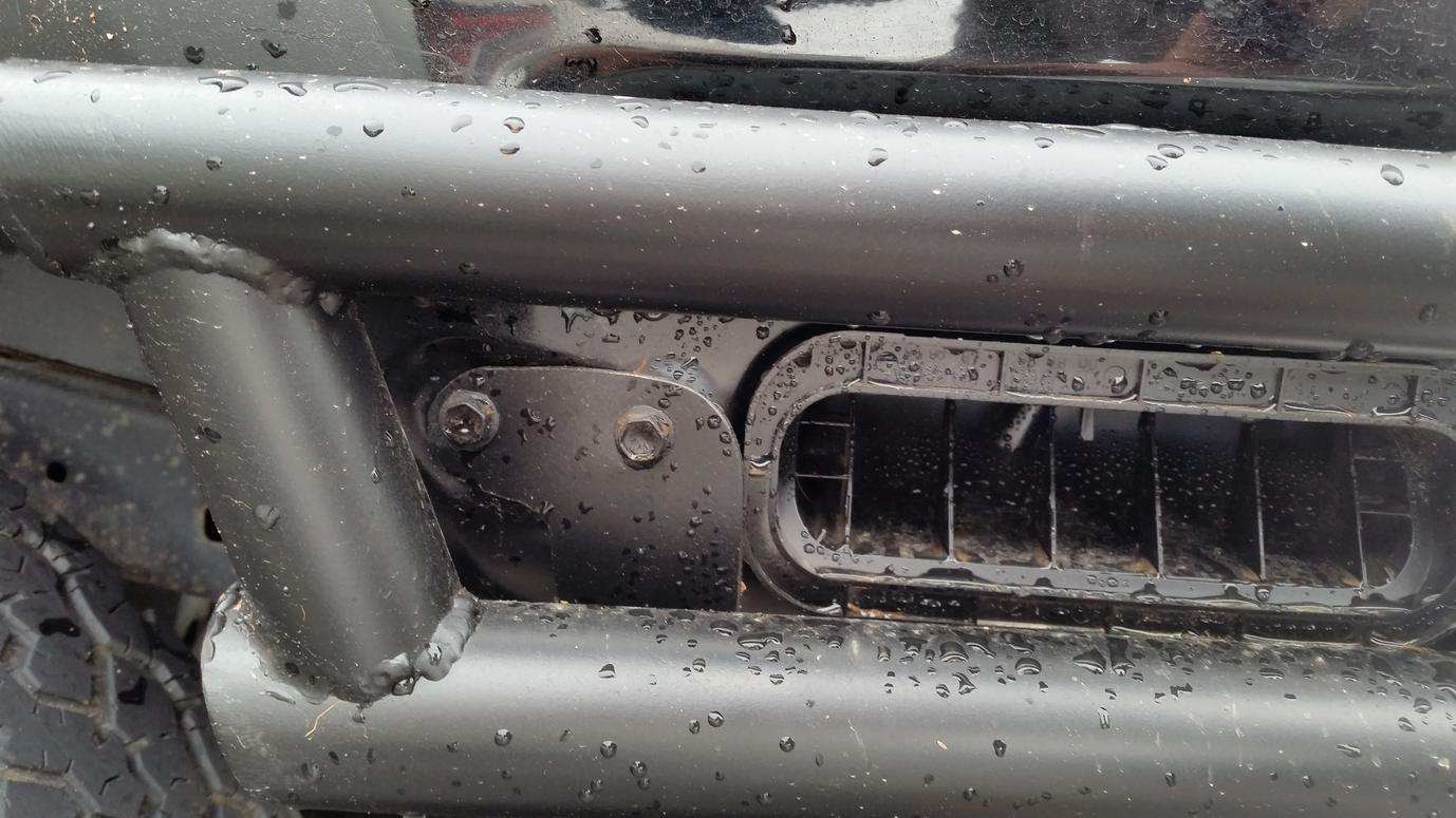

As stated above, it's to equalize cabin pressure. Here's what it looks like on the outside. When you shut your door, the windows would probably blow out if this wasn't there. Well, maybe not, but it could be bad.

All modern cars have a 'flow-through' vent of some kind, somewhere on the car, usually near the rear. My old land Cruiser FJ 60 had the vent 5 feet off the ground on the D pillar, so dust ingress was never as much an issue as with our 3rd gen 4Runners.
I can report that shutting the doors still feels normal, even with the vent sealed.
