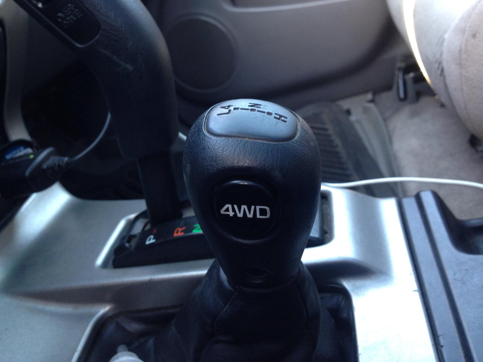

I am going to claim ignorance here... does a 2001 SR5 have full time 4WD?
I can feel it in the steering wheel, and it is definitely speed dependent. I would characterize it as a vibration.
A 2001 SR5 has AWD(non locked center diff 4wd) when you have the 4wd button depressed on the transfer case shifter. Otherwise there was no option for an all time 4wd model. Your shifter would look like this and the button would need to be depressed in order for you to be in AWD(all-wheel drive), otherwise you would be in 2wd if the button was not depressed. image.jpg
