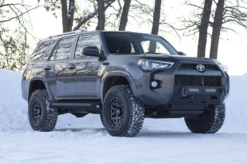

Hey everyone, I’m Cam from Victory4x4!
A little late in the build but it's never done so I figured I should start a build thread.
I bought a 2017 Magnetic Gray SR5 4Runner this past summer and love it. I'll update mods here as they're made.
Specs
2017 SR5 - Magnetic Gray Metallic
Suspension/Wheels/Tires
3" BDS Suspension
Mamba M23 - 17 x 9, 4.53bs, - 12 offset
Falken Wildpeak A/T3 285/70R17
Armor (Victory 4x4)

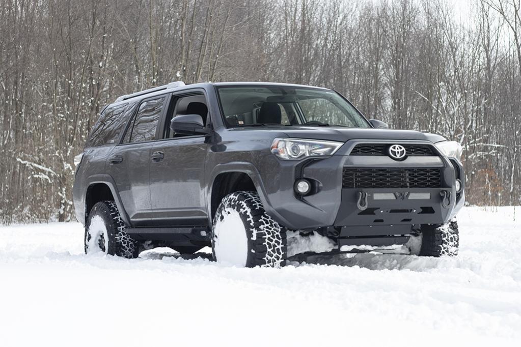

Blitz Front Bumper
Blitz Rock Sliders
Front Skid
Mid Skid
Transfer Case Skid
Recovery
WARN VR8-S winch
Factor 55 FlatLink
Warn Epic Shackles
Roof Rack (Victory 4x4)

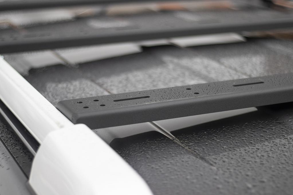

Roof Rail Crossbars
Storage

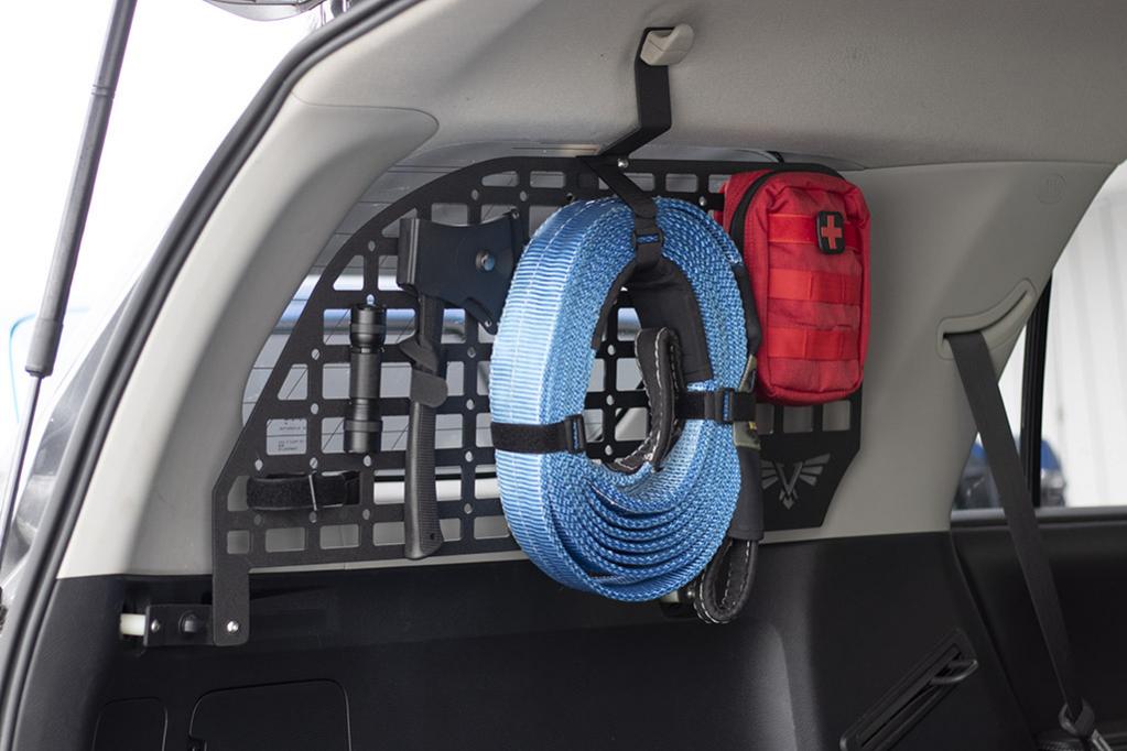

Victory 4x4 rear window MOLLE panels
Victory 4x4 Center Console MOLLE panels

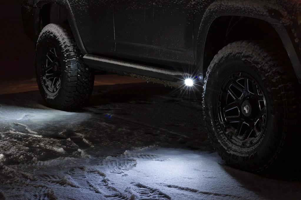

Lighting
Interior LED replacements
Rock lights in the Blitz sliders wired to the dome light circuit as courtesy lights
MISC

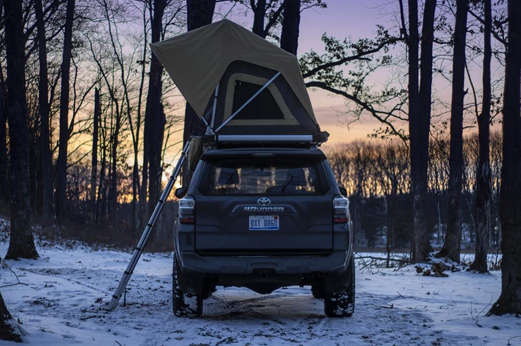

Freespirit Recreation Adventure Series Manual 49″ Roof Top Tent
Blue Sea Systems Power Block in cargo area
Husky Floor Mats | Front, 2nd Row, Cargo Area
If you have any questions, post and let me know!

Very Nice. What's your pricing on the above items. How is the wind noise with the roof rack crossbars? How easy are they to install and remove? Thanks!!
Thanks! I just added links to the products above. The molle panel is $179. The crossbars are $89, sold individually so you can run as many or few as you need. It will just depend on what you plan to load on top. I ran a 2 person RTT and used three crossbars, if you run a bigger one, you might want four. I haven't noticed any additional wind noise at all with them.
The install video should be up soon, but they are easy to install. The plastic factory end caps pop off and you slide mounting plates into the rail. You'll put one side of the crossbar onto the bolts and the other side is notched so it just drops on top of the bolts.

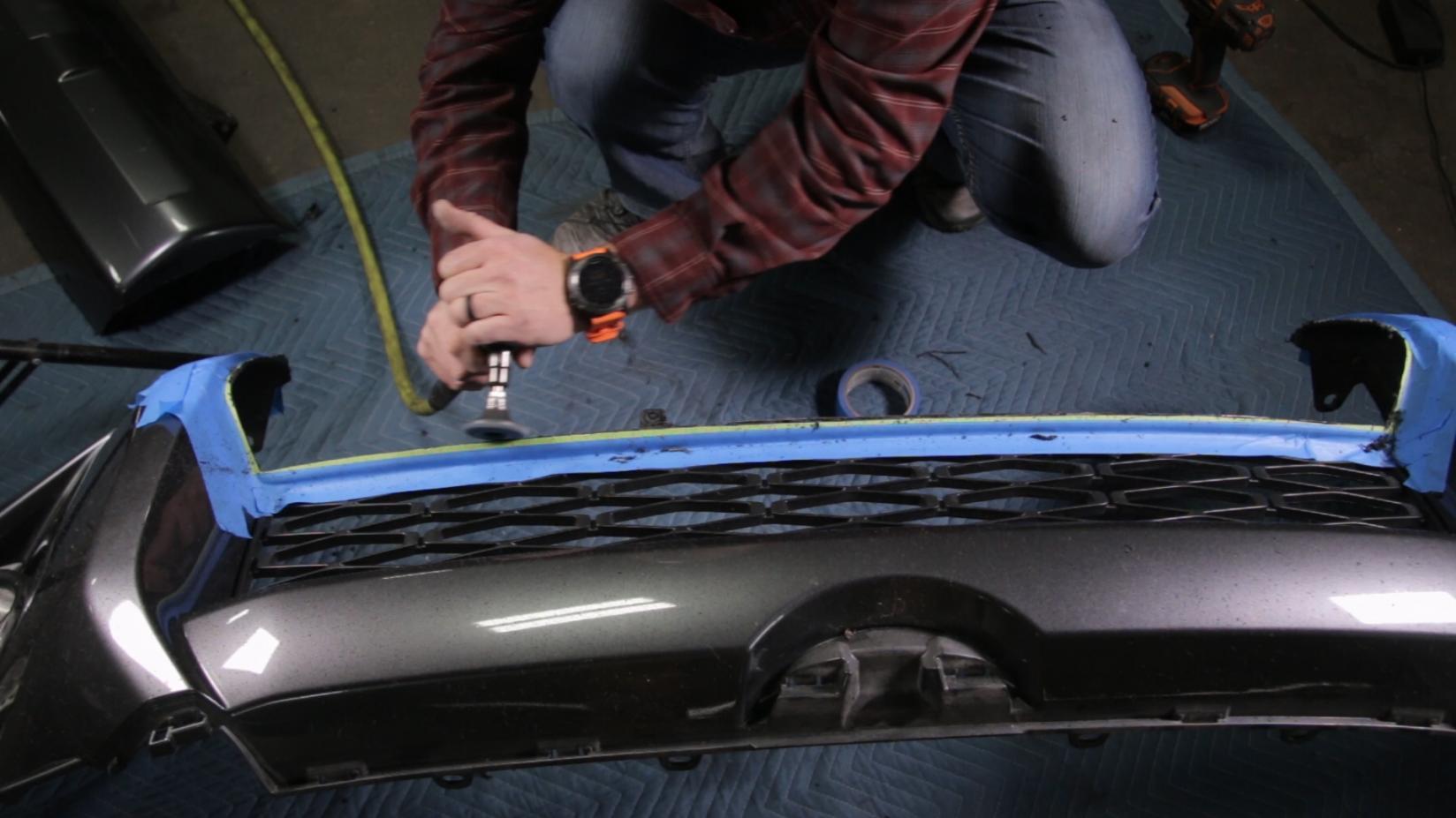

Any install videos for that bumper? I was pretty set on the SSO slimline but like the looks of that one as well.
Install video is coming very soon! It just requires one cut around the lower valance portion of the stock front bumper.

I really like the looks and the low profile design of your crossbars. The only drawback to me is the lack of a larger point in the slots to allow a bolt head to slip through. I'm guessing you are wanting the customer to use a T-Bolt? Thanks again.
A regular bolt would work as well. You should be able to fit them up through the bottom. If not, one side of the cross bars can lift off the studs to get access to the bottom without taking them all the way off. We will also be designing additional accessory mounts in the near future.
Sliders look great. Are they angled up or perpendicular to ground? I'm looking to get one eventually but a lot seem to be angled up. Not sure the pro's or con's of either one.
thanks
thanks
Either way will work as a serious rock slider, but we designed ours to be parallel to the ground so they will also work well as a step. If you are using them as a rock slider, the important part is that they mount to the underside of the frame.
