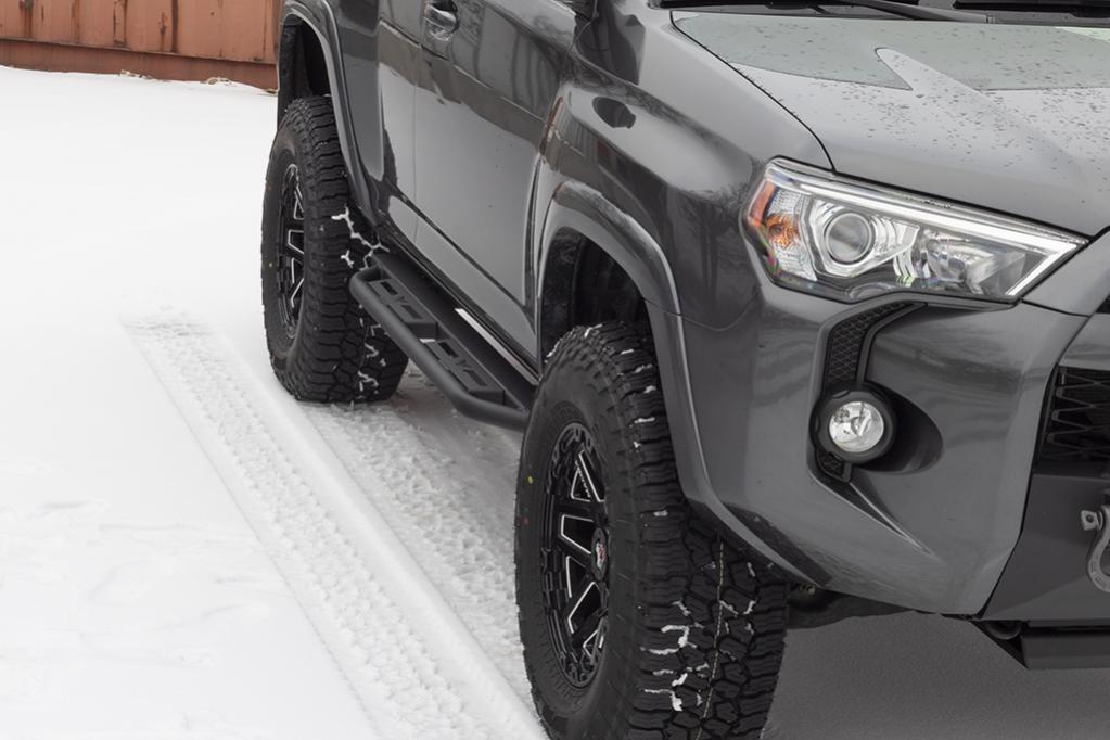

Victory 4x4 5th Gen Sliders
Here are some details on our sliders.
Our tube sliders for the Toyota 4runner are designed to be used as a step as well as protect your rig. They are proudly made in the USA are available in a 2 stage satin textured black powdercoat over durable zinc primer finish, or in bare metal.
• Main structure built from 2x3x3/16" box tubing.
• 1 3/4" round outer tubing. Tube gussets useable for safe step entry.
• Bolt-on installation.
• Some drilling required for offroad use.
Someone had a question about how they are mounted so here's some more info on that.
They are frame mounted and have 3/4" gap between the slider and the pinch weld to allow for some flex on a full weight drop.
If you are only using them as a step, the bottom mounting holes will not need to be drilled, but they are necessary for offroad use as they prevent the slider from being pushed up into the body.
Strike Rock Sliders | 5th Gen 4Runner (14+) - Victory 4x4

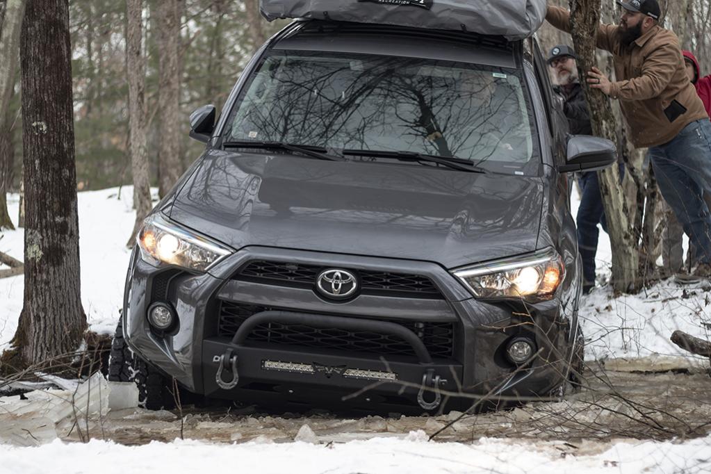

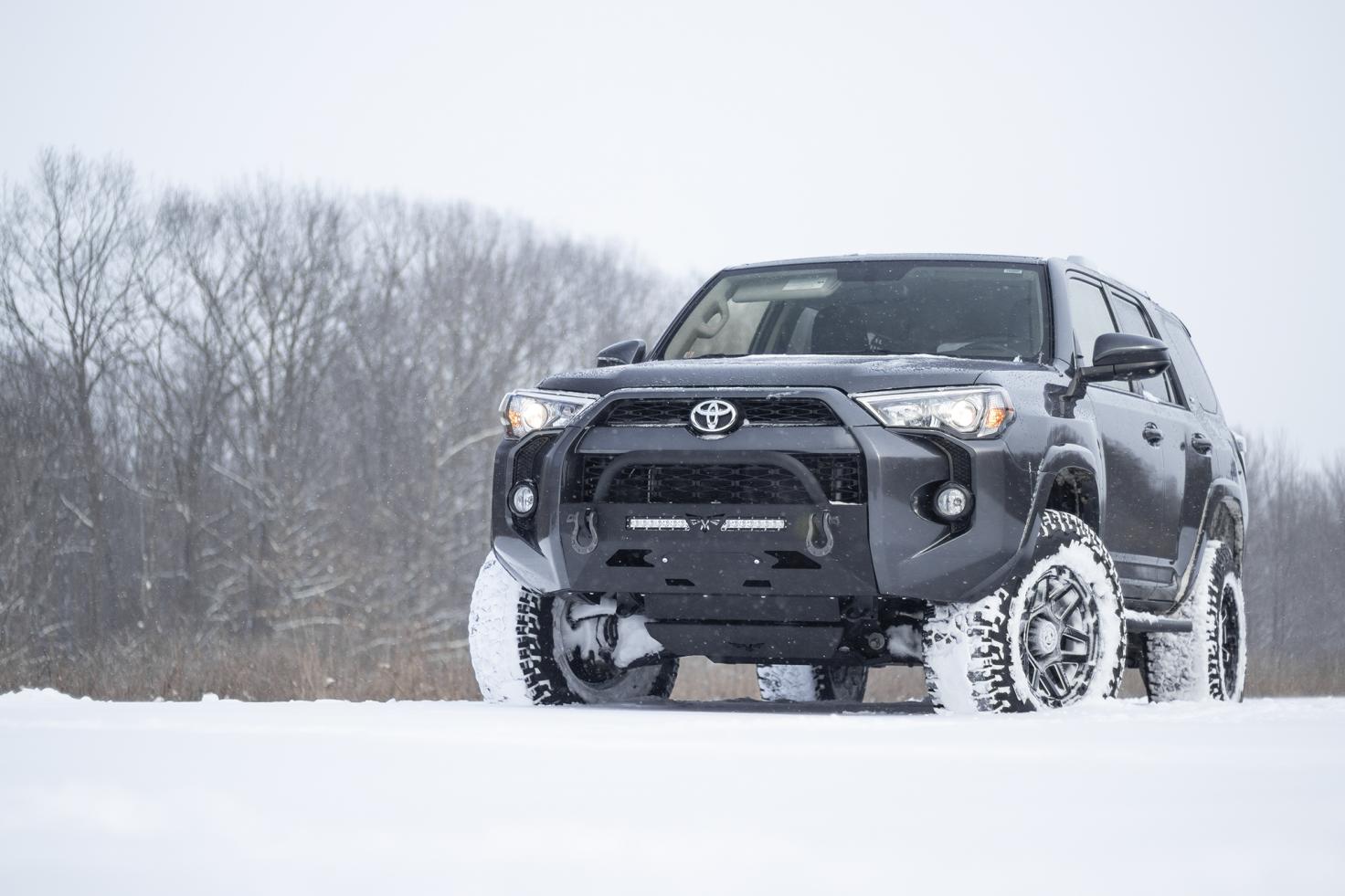

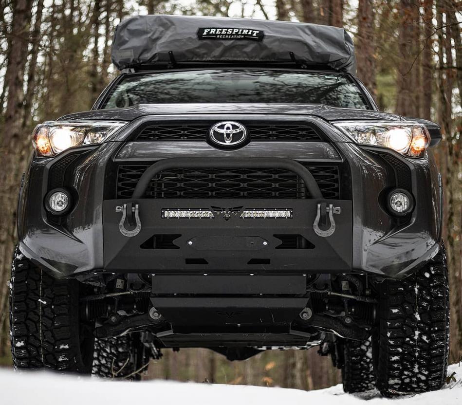

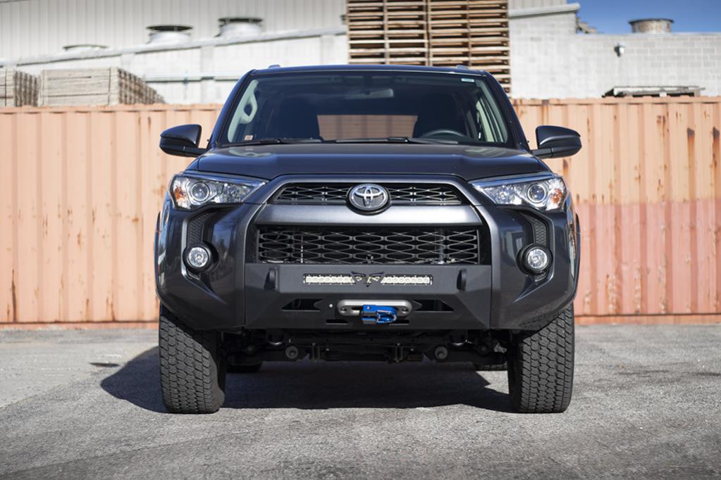

Blitz Front Winch Bumper
Here is some info on the factory integrated winch bumper.
Our Blitz winch bumper for the 5th generation Toyota 4Runner is designed to integrate with your factory front bumper fascia for a clean look with maximum recovery options. This made in the USA bumper features an integrated 20" lightbar mount, 3/4" recovery tabs, plus provisions for many industry standard winches. It's available with and without a tube. A fairlead block off plate is included for those that don't yet have, or need, a winch. The bumper is available in a 2 stage satin textured black powdercoat over durable zinc primer finish, or in bare metal.
CNC cut and formed from .188" steel.
Includes 1.75" x .120" tubework for added grill protection.
Compatible with most 8-10k non-integrated solenoid or removable selenoid winches.
Some integrated winches will fit with a power steering return hose reroute
Built-in provisions for a 20" light bar (22" max mounting width)
Proudly designed and made in the USA.
Does not fit Limited trim 4Runners
Tube
Blitz Front Winch Bumper With Tube | 5th Gen 4Runner (14+) - Victory 4x4
No Tube
Blitz Front Winch Bumper | 5th Gen 4Runner (14+) - Victory 4x4

Would it be possible to get this bumper without the LED cutout? It does look great on your bumper, but I refuse to be that guy who puts a light bar on his truck. :) I do not ride trails at night and they are illegal any other time.

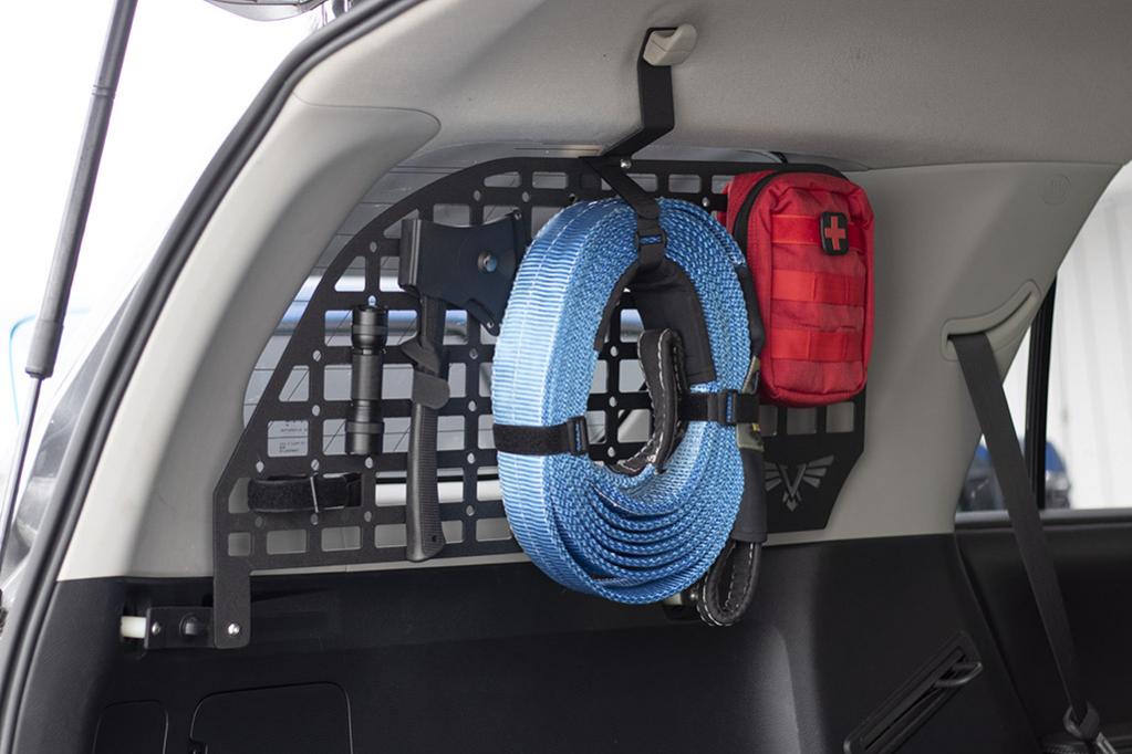

Any pictures of the molle panels installed? Looks as though they are not bent to fit the shape of that window area, like the other offerings?
We won't be offering them without the cutout but may include a perforated panel to mount in place of a lightbar in the future.
The brackets are bent to fit the shape of the window area to allow for more flat storage surface. The top and sides of the panel are shaped to fit the window area. The brackets also allow you to mount the stock cargo net hardware.

Skid Prototypes
Here are the prototypes of the Engine, Tcase, and Transmission skids. We don't yet have the gas tank skid prototyped but it will mount similarly to our Tacoma gas tank skid. (to the frame, not using the stock gas tank straps). They will be offered in 3/16" steel or 1/4" aluminum (mounting brackets will still be steel).
Stay tuned.
