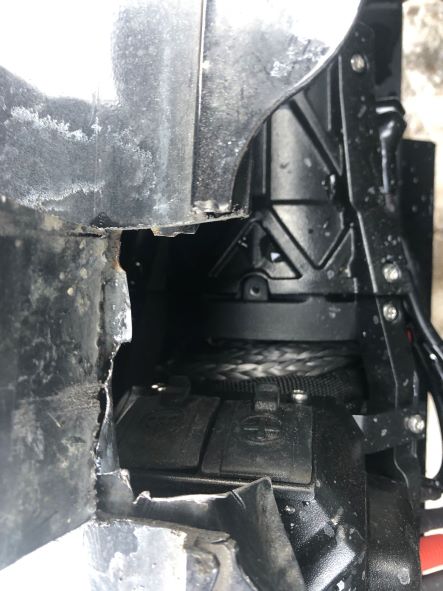

- I used a smittybilt gen 3 9.5k winch. The predrilled holes to mount the winch in were tight, but a 16 mm socket barely fit. An Impact 16 mm socket would not fit
Opportunities for creative solutions
- So this is likely more of a 4r issue than a bumper issue, but because of the top of the front bumper, its really tough to access a winch. Particularly this one, where you have to plug the controller in. A wireless winch or remote may fix this, but this was my solution

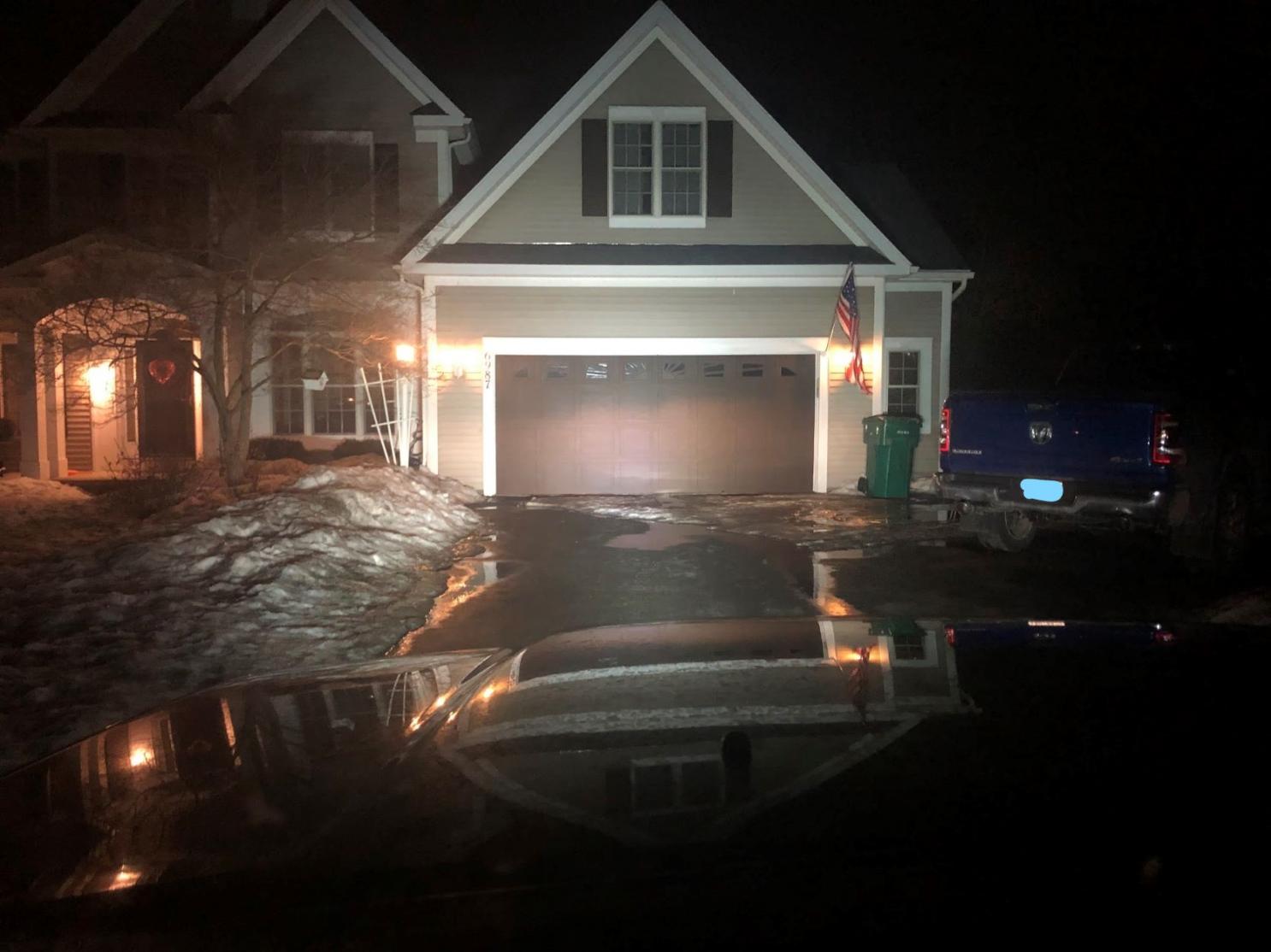

Another user complained that the Victory "V" logo impaired his light bar. I have not appreciated this at all and I have a continuous lit up area

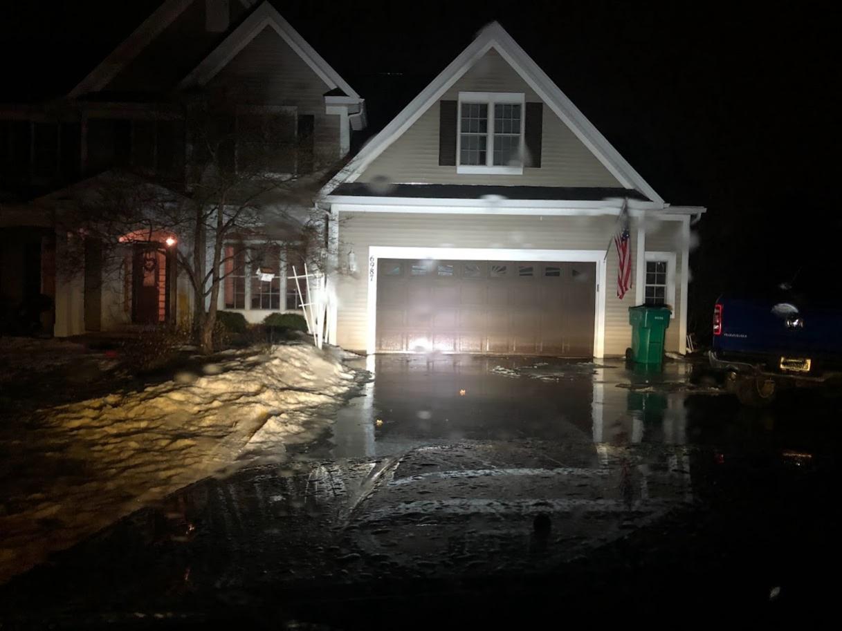

Another photo without the house exterior lights on to show they arent filling in any light
