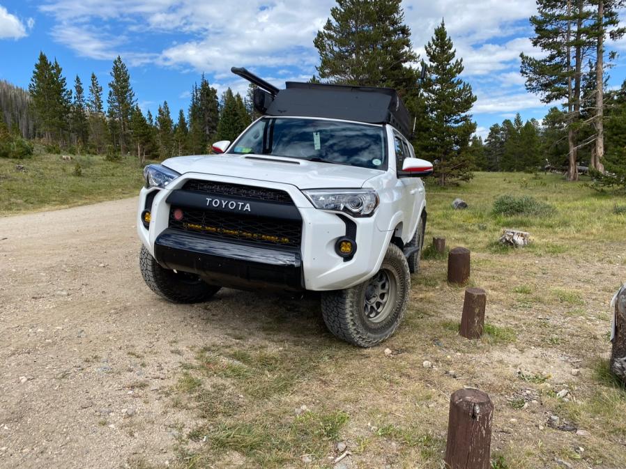

The main issue that causes the wind noise are the slots in the bars. I designed a fairing extension then had it laser cut out of aluminum, then powered coated. Primary for my roof top tent but now I use it in the winter as well to direct air over skis and my traction boards. I did a test with the tent on the highway, a there and back with little traffic. Improved my mpg by 3! Now my tent is an X-Cover (brick)

I added 12", which was max giving the size of the rack and tent. If I were doing one without a tent, I would go around 6" to push the air up and over the rails and gear on top.
Just an FYI, I have done design (ME/ID) work for two roof rack companies, one major manufacture. I have been using a fairing since the late 80's, as I was a competitive cyclist, and it made a HUGE difference with Yakima bars.
The main issue with all the 4R racks on the market is that they are flat, though angled it is not ideal. Curved to match the windshield would make them much more effective. I have designed a roof rack for the 4R but not sure if the investment in tooling is worth it for the sales opportunity. But it would be innovative given the standards out there.
Anyway, PM me if you want the file, or even a shorter version. Then you can have it cut. I will also tell you how to install it.
