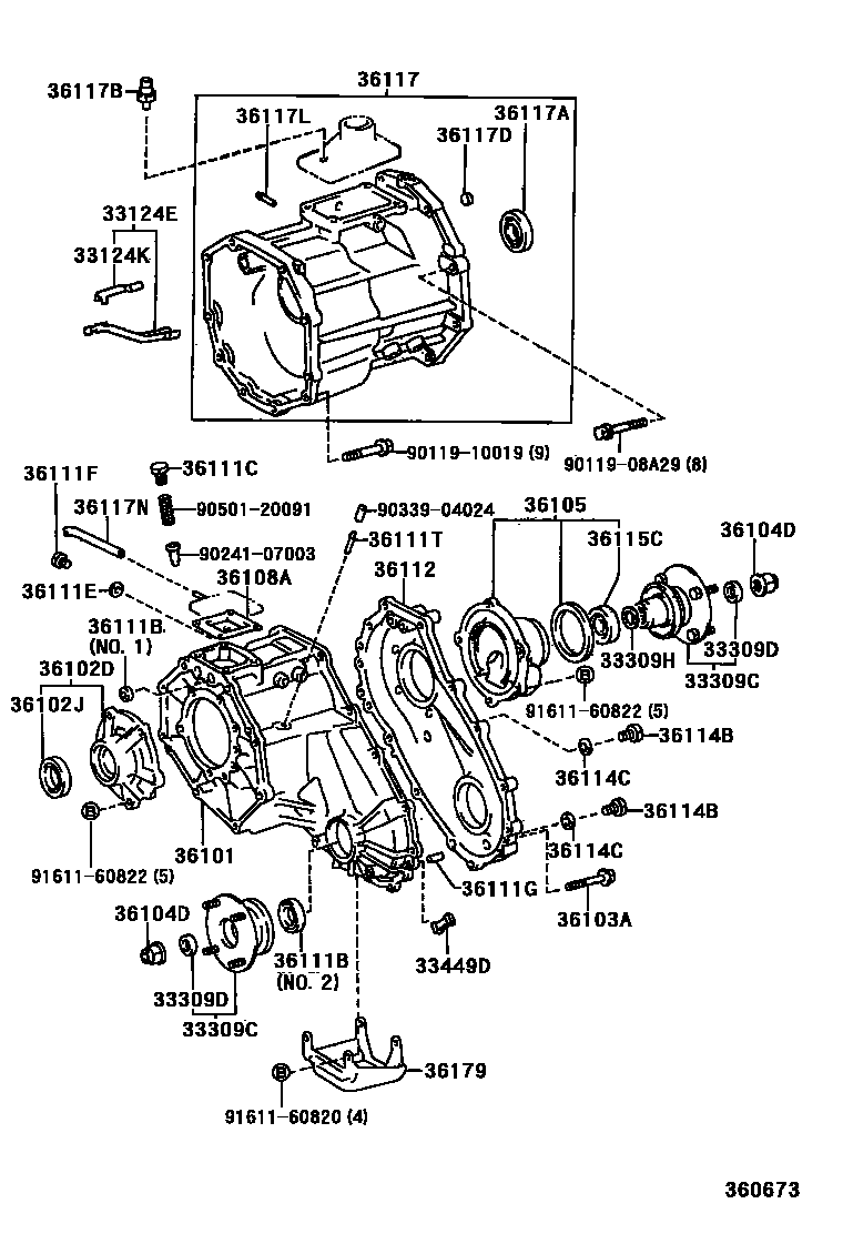

I am planning to convert my gf's 4Runner from 2WD to 4WD. I need the extension transfer adapter for the W59 transmission The manual transmission mounted to the 3RZ 2.7l engine. Does anyone here happen to have one laying around?
It is the part that the transfer case bolts on to the transmission case and the shift lever attaches to it.

Here is a diagram of the part and part number if it helps...
Hope someone here can help me complete the project abroad!

You may want/need a complete transmission + TC - the output shaft on the trans may be different between 2WD and 4WD (it is on the equivalent auto setups).
