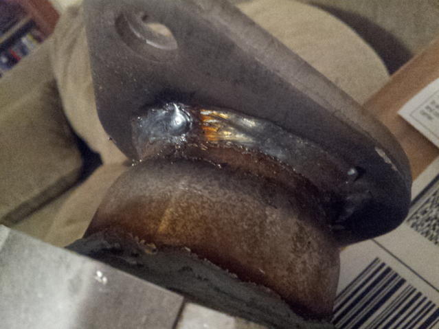

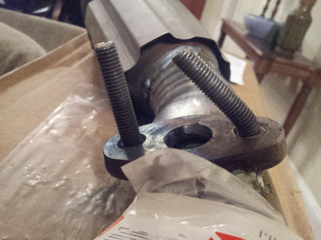

Pic 1: The AF sensor bolts are bent to h***, likely because they use low grade threaded rod instead of a proper high-temp bolt. The actual damage was Fedex's fault, but I'm thankful it prevented me from even trying this thing.

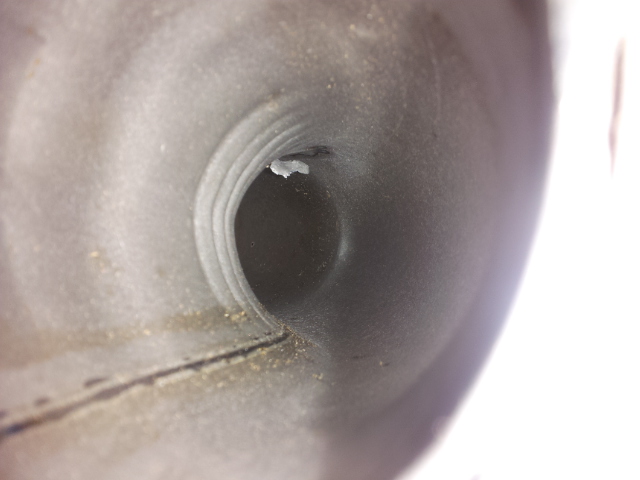

Pic 2: There is still a large piece of metal left hanging inside the pipe where they punched through for the AF sensor and it extends into the exhaust stream. It's upstream of the sensor, so it's likely to interfere with the sensor's ability to sense... at some point, it's going to brake off and get lodged in the catalyst. Lastly, they welded the bung directly onto the folds of the bend - probably not the easiest to seal there and will probably fail quickly/easily.

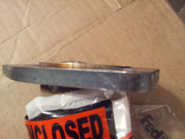

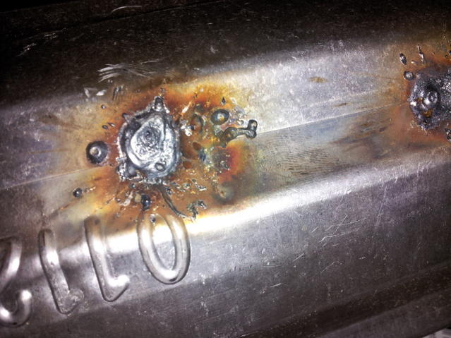

Remaining Pics: Terrible welding, the flange is not perpendicular to the tubing, and more examples of a garbage product.
Needless to say, I'm returning it. I'm sure there are some of you out there who are happy with your Walker product, but I think this is just ridiculous. No wonder we're lucky to get aftermarket cats to last a year!
