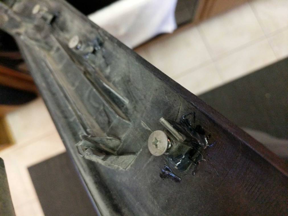

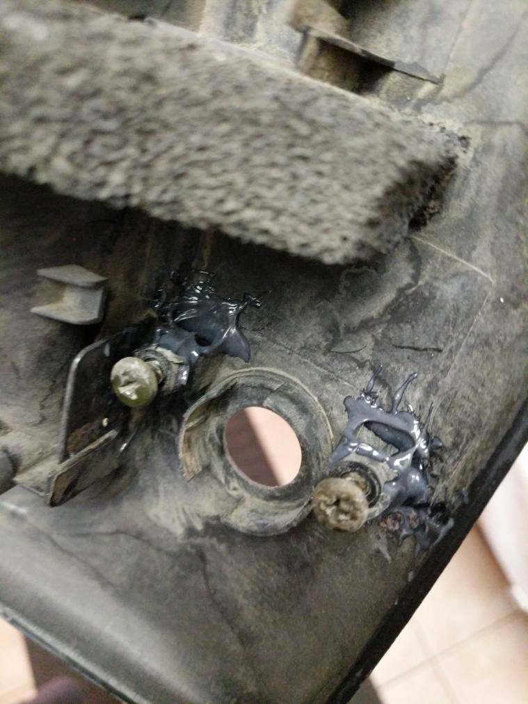

I've done 2 rear bezels with 6-minute JB Weld KwikWeld epoxy. keeping the broken plastic bolted in place on the latch or cylinder I glue them down and hold them in place till they start to set. Once the first application of epoxy dries/cures (1-2 days) I glue it again and reinforce around the area and add glue and material like SS mesh, then let it dry/cure again. I have found both the latch and key cylinders fastener tabs are so tiny it's a joke - bad design, should have been solid lugs.
Edit: JB Weld KwikWeld epoxy
Added pics. Ready for second, reinforcing coat.
