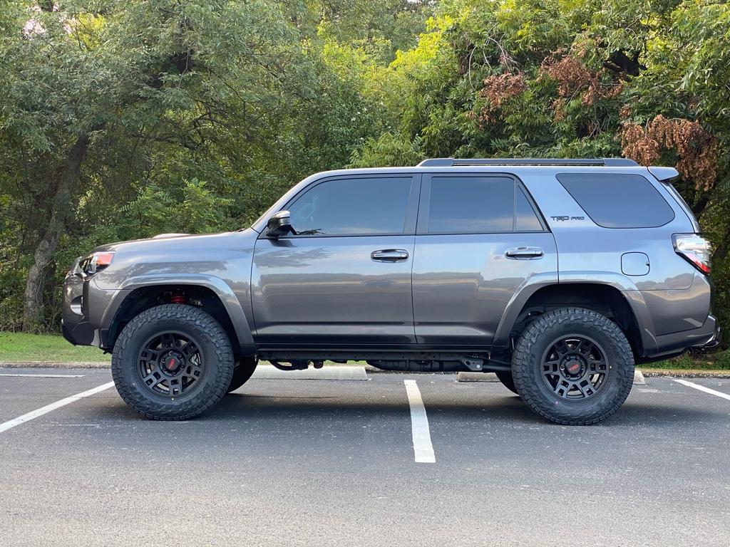

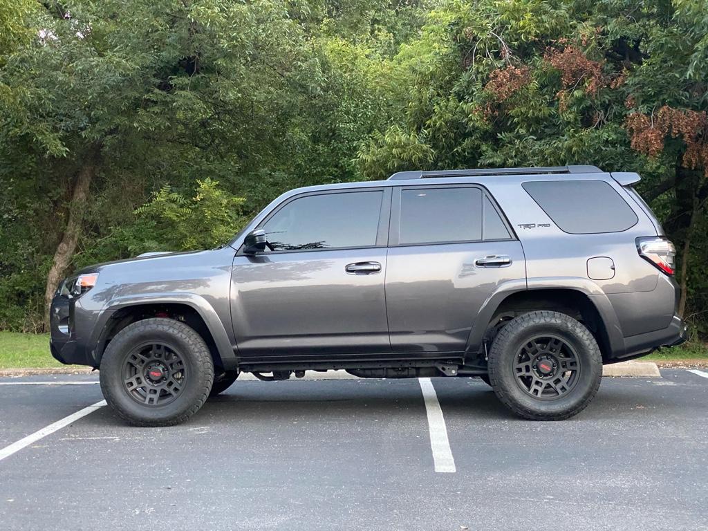

I would bet all your questions would be answered in those other threads, but I went with Eibach because a spring is almost always a better choice. My installer laughed when he saw the Westcott. Eibach was easier. Got red springs in rear as a bonus. Rides great. Stance is great. Able to run 285's easily with stock wheels. With that said the guys at Westcott were great to talk to, but the springs were a much simpler install.
Before:
After:

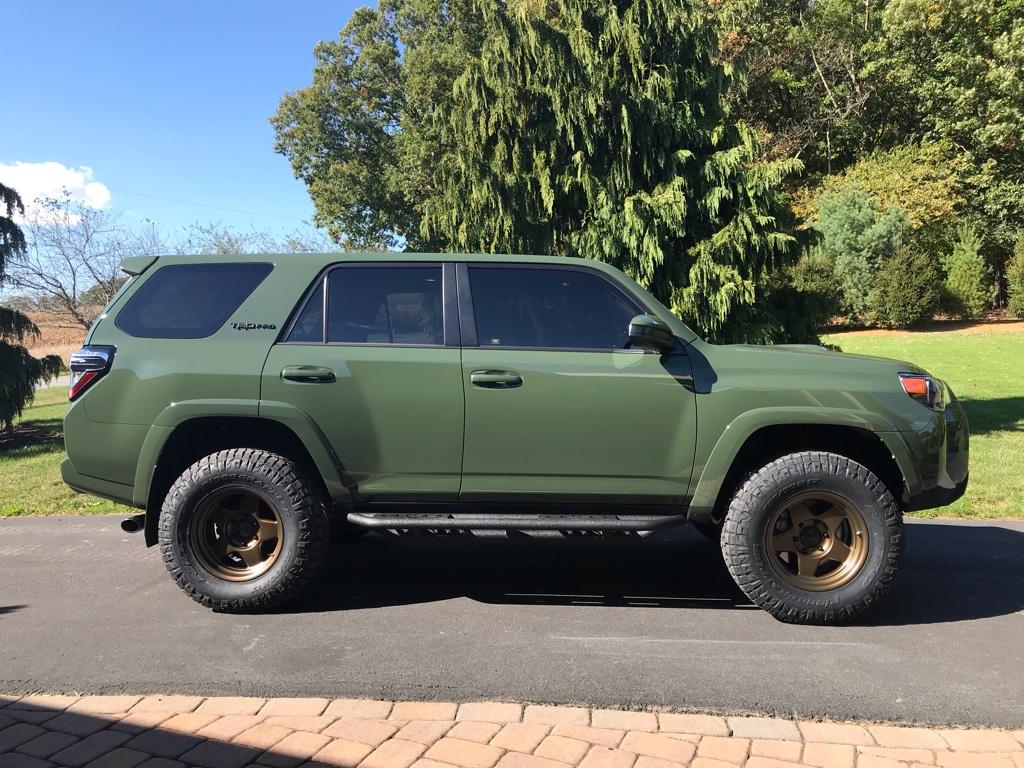

TRD Pro Eibach springs aren’t easy to find these days. I tried ordering from Eibach and after placing the order and waiting two weeks without a shipping confirmation, was told by them they were out of stock and it would be between 1-3 months before they went back in to production.
I found a set at one of their distributors fortunately, and canceled my Eibach order.

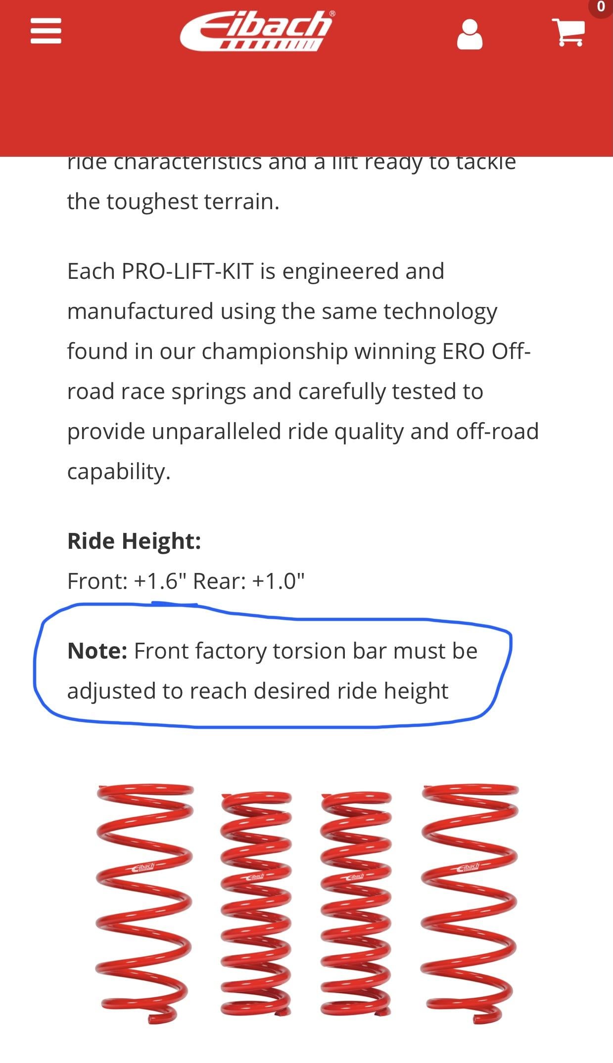

I see with the Eibach springs you have to adjust the torsion bar. Have you noticed any bounce in the front end due to this when you hit bumps on interstate and so forth?
I think mine rides better on the highway than stock.
