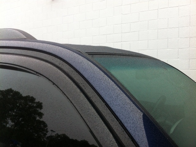

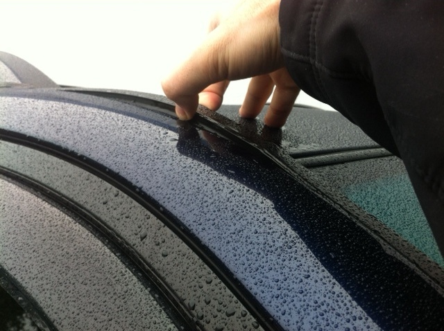

well i cleaned sunroof drains, helped some but i am still getting the wet floor underneath the floor mat. i was removing the aftermarket XM antenna and noticed this trim pictured below was quite loose, would that have anything to do with it? also saw someone mentioned A/C drain? whats up with that? thanks everyone!

If those trim pieces are loose, it means your windshield has more than likely been replaced. The glass companies usually take the half assed approach of prying them up and not properly securing them afterwards. Those seals themselves don't seal out water, but like Derek G mentioned, the epoxy under the windshield may not be making a proper seal.

its just on the passenger side that its loose, where the XM antenna was placed, drivers side has no issues...windshield looks factory toyota, has the etched Toyota stuff on lower drivers side, no other evidence of replacement, noise, sloppy seal, etc...thinking a/c drain may be it...where is it?
