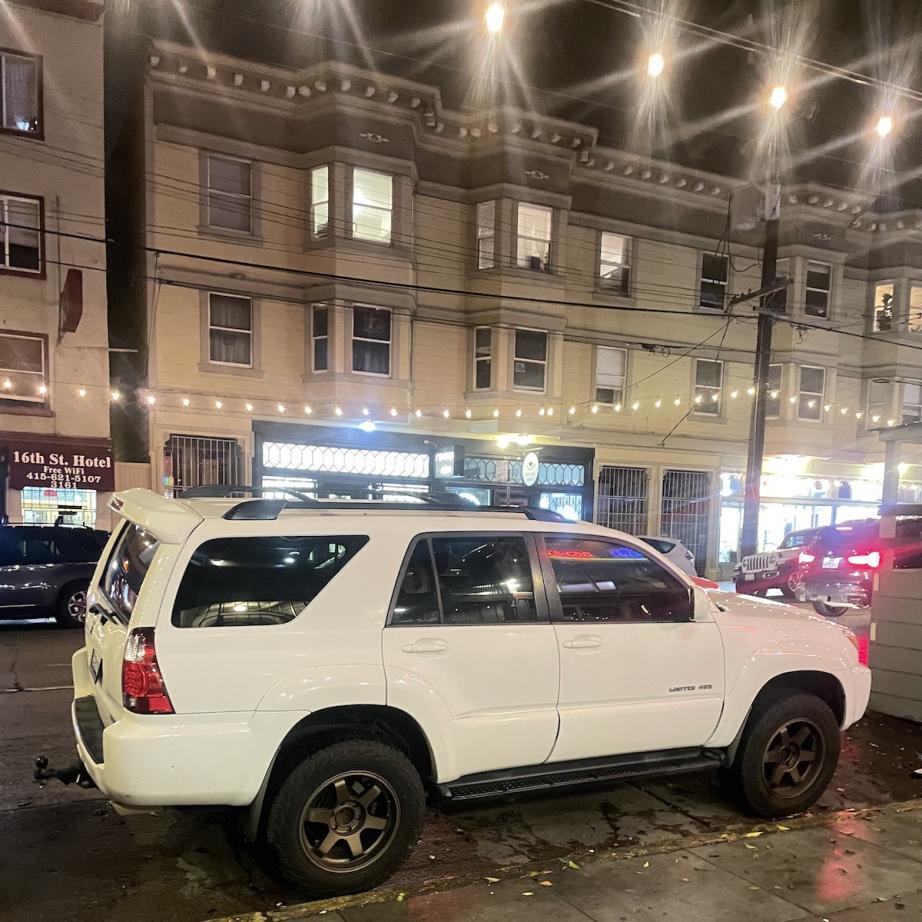

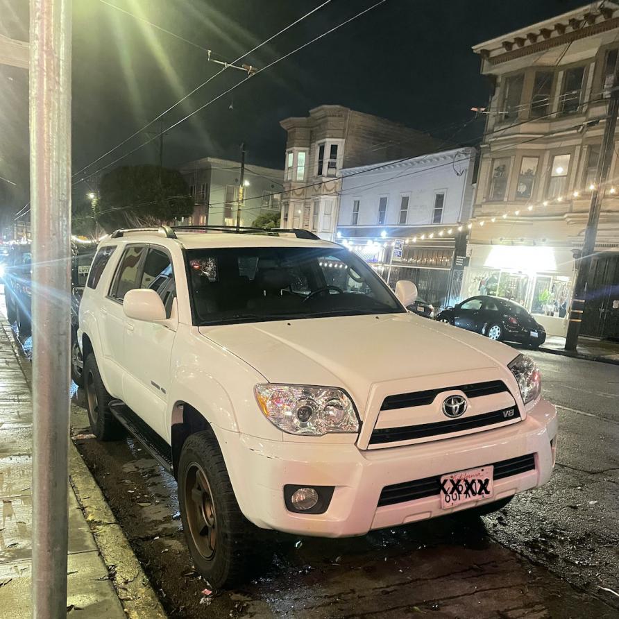

Can you or others pinpoint the year of this Sport Edition? Sorry these are the only pics I have.....
Thanks!

That's a Limited, not a Sport but its definitely an 06-09. They all look the same really.
I would say 06-09 has better styling and definitely go for a V8, zero regrets!
Edit: Also, do you want leather? Cloth? SR5 will have gray cloth seats, Sport will have black cloth and Limited has gray leather.
That is an 06' to 09' model year you have pictured. The apex of the fender well is round on these and the headlights have a little nook in the bottom.
03' to 05' models have a squared off fender well and no nook in the headlights.
