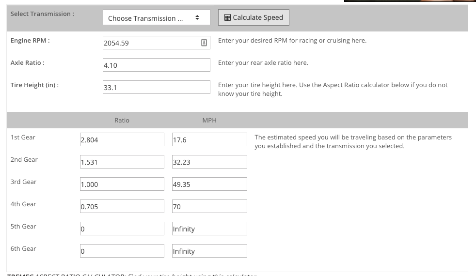

In the first attachment you can see that at 70mph the engine will be running at about 2054rpm. At this rate, any slight elevation or need to accelerate will most likely downshift or bog if it doesn't. It also implies that although it's comfortable at 70mph on flat ground, it probably took quite a bit longer to get there as this gearing loses a lot of torque.

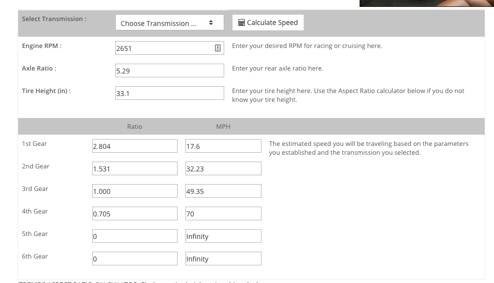

Now let's take that same T4R and regear it to 5.29. You can see the results in the second attachment. Notice that at 70mph the engine will be running at 2651rpm. At this rate, you should have more available torque for climbing hills and passing without downshifting as much. A drawback here is that 2651rpm is quite a bit noisier than 2054rpm, which could get annoying on longer highway drives. It also implies that although relatively high revving on the freeway, it will have an easier time accelerating and hauling heavy loads like armor, steel bumpers, gear, or towing. You also have the option of bumping up your tires to 35's which will again trade off some torque but bring the cruising revs down.

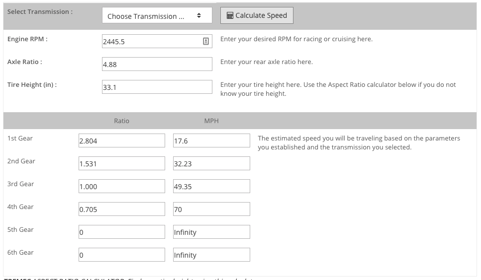

This time, lets regear the same T4R to 4.88. These results are in the 3rd attachment. At 70mph the engine is at 2445.5rpm.

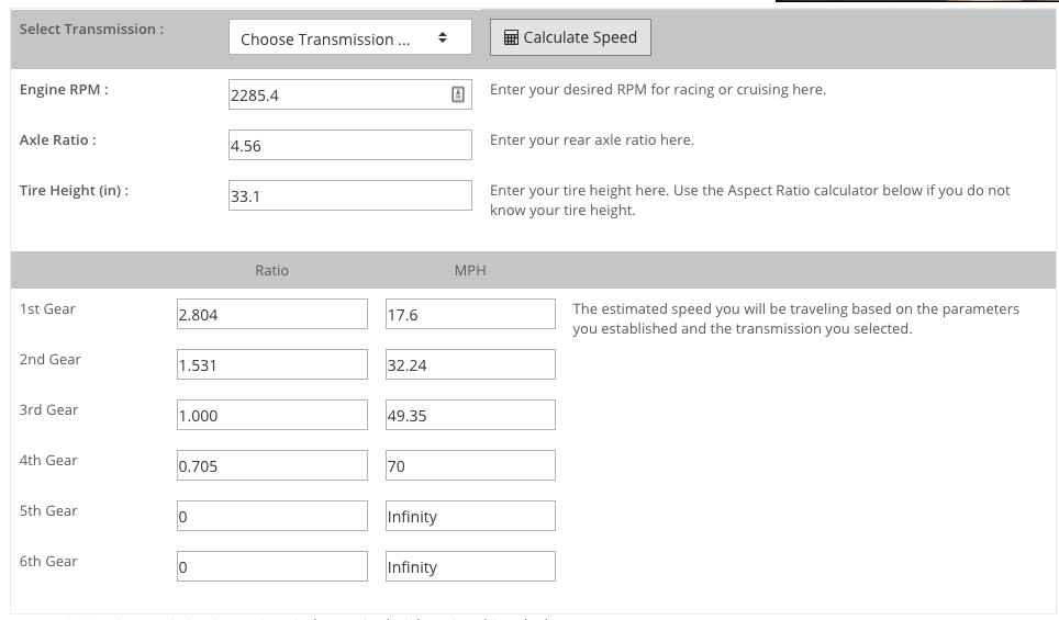

Finally, lets check out the same T4R with 4.56. These results are in the 4th attachment. At 70mph the engine is at 2285.4rpm.
