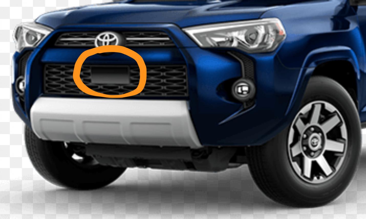

I searched, so apologies if it has already been discussed, but what is the purpose of this? The only thing I can think of is that it is for parking sonar.

Part of the safety sense package added in 2021. That detects obstacles in front of the vehicle and is used for radar cruise. Most all new vehicles have something similar now.
Part of the TSS (Toyota Safety Sense) system as Whippersnapper02 mentioned. Included are the adaptive cruise control and automatic braking. Some don't like the placement as it could interfere with add on equipment like a winch etc.
I wonder how durable that sensor plate is going to be in regards to occasional rocks, debris and bugs we all encounter in regular driving. Will it work ok when covered with snow, mud or dirt? What will it cost to replace? - can't be cheap. It just seems like bad placement to me and perhaps not the best idea anyway.

It's pretty solid, so no issues so far with rocks/debris/bugs. Caked on dirt and mud has deactivated the safety features but since I've been on trails when this happens never bothered me and simply wiped clean with my hand when getting back on the pavement.
FWIW - I believe that is a 1mm wavelength radar sensor unit. What's a bit unusual is that it's really big. So maybe it does something more that isn't obvious. Or there's a group of radar units in it? Not sure. Normally the front radar fits within the emblem. So I'm not sure why it's so big.

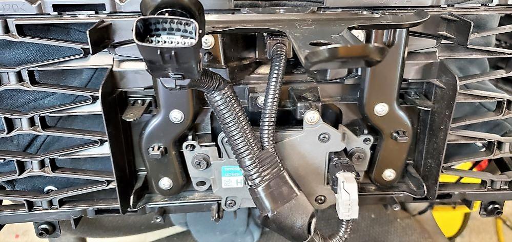

It's the same radar sensor used on most or all the Toyotas(A2C740034) and just sits behind a big cover. Maybe because of the Pro is why they didn't put it behind the emblem like the rest.
I'm glad they didn't put it behind our emblem as it would have been harder to retrofit the heritage grill.
Here is a pic showing the backside and you can see how that front panel is clipped on. Mine has the camera and is what that top harness goes to.
