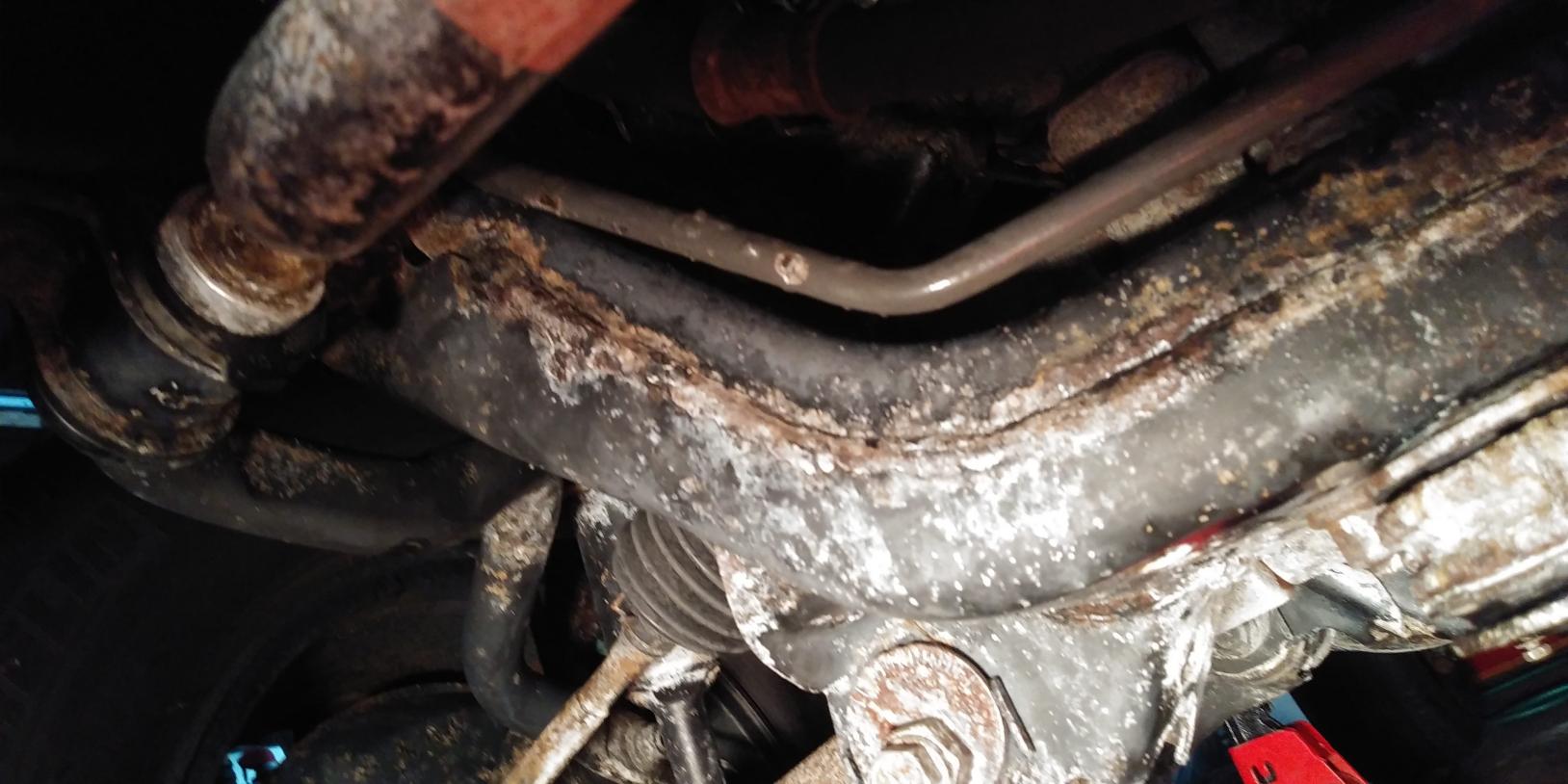

Front of 2007 4runner, on the bottom behind the radiator? Transmission line?
note am in process of de-rusting, that's all the white stuff.

Looks like the transmission cooling lines. There should be a second one routed pretty closely to it. These are known to rust out.
What’s your rust treatment plan? I’m about to do the same on my ‘08 (I live in Chicago, so lots of salt)
I don't see a 2nd one, I wonder if it's A/C line.
It just started to take the paint off and brackets quite rusted. I'm using POR 15 prep stuff all over it, taking down the rust as much as possible, then 2 coats of por15 should hold it for as long as I have it...I hope. I did this on 99 4runner and worked in general except where rust took off again but I wasn't as patient that time. I'm also trying some other rust eater products to remove rust which are working but slow...gotta keep it wet. It's a mess because the bolts and brackets are rusted in place. Quite rewarding to see the rust disappear though... Key thing is to check all the lines, I just noticed a bubble in a break line and other lines as noted. Always keep a spare 4runner around while working on de-rusting your 4runner...lol

One is the power steering return line and two others are the transmission cooler lines (in/out to trans). Mine were rusting out, all three of them...so I removed the hard line connection and ran new rubber transmission hoses for each.
