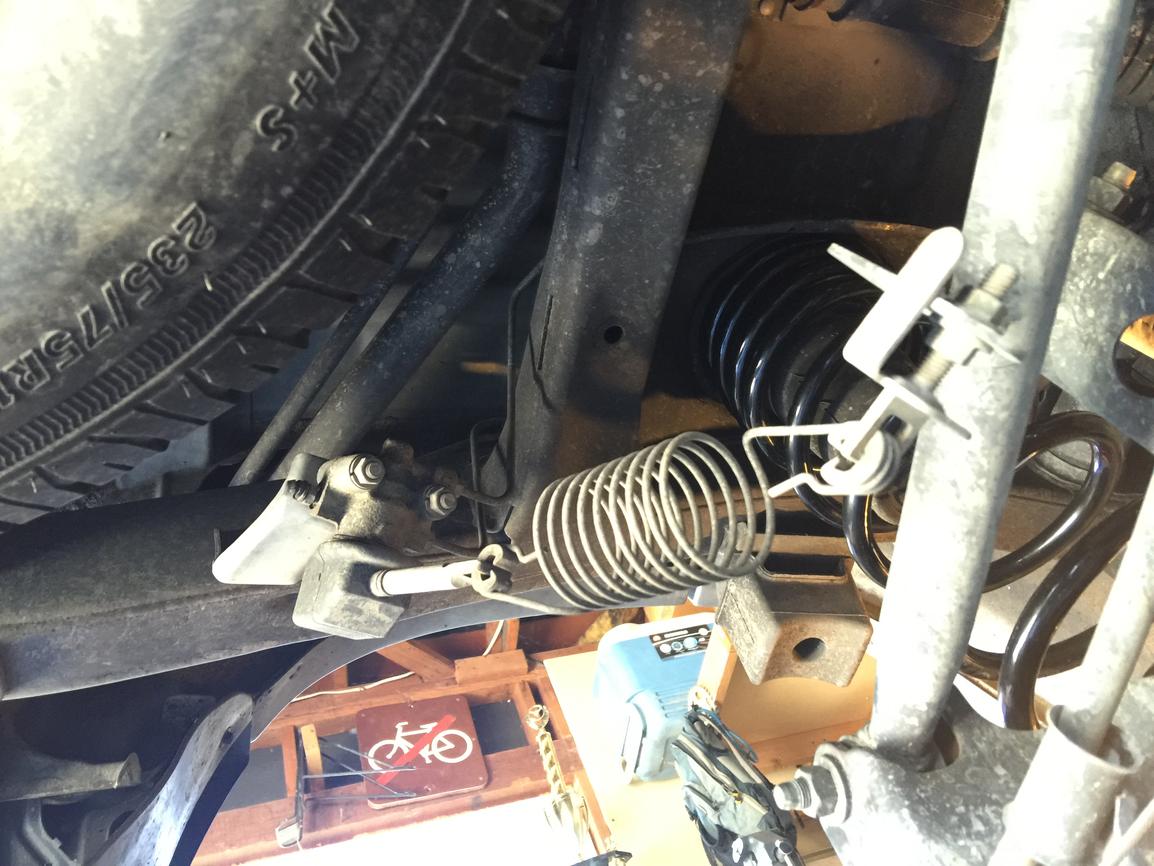

What is this thing attached to the pan hard bar?
infamousRNR
Senior Member
Never seen this before. It's attached to the pan hard bar and has some sort of spring on it...
Neither of my 4runners had it. Who can explain this?...

It's a load sensing brake proportion valve
It adjust the pressure to the rear brakes depending on the load you are carrying in the back of the 4Runner.
That looks like a LSPV--Load Sensing Proportioning Valve. If this rig does NOT have ABS, that's what it is. Presumably your other rigs had ABS, and thus no LSPV.
Most 3G's have ABS. This is probably an early year and a base model (wild-ass guess).
Many 4 cylinders have LSPV.

I haven't adjusted anything and my brakes seem to be fine. Should this be adjusted? And how?
if your truck is a base 2wd 4cyl non abs truck then when you lift it, the lspv must be adjusted so that the truck doesn't think its under hard braking. there are many threads and articles on how to adjust it.
....but if your truck is anything other than stated, chances are it doesn't have an lspv because it has abs, and in that case you don't have to worry when you lift.
Hey James, I think you're gonna be just fine. The Load Sensing Proportioning Valve's purpose is to give you increased brake power to the rear brakes when you have the back of your truck loaded down with a bunch of weight. As the suspension compresses from added weight, the panhard bar which the spring is attached to sinks down, pulls on the spring and opens the valve sending more brake fluid pressure to the rear brakes. I remember when I was working on your truck that I saw brake lines running to and from the LSPV.
Some stated your brakes could lock up but there's no way that's going to happen by adding a lift if you understand what the valve is accomplishing for you. What you would have to worry about is when you are carrying extra weight in the back, it's going to take more compression of the panhard bar to open the LSPV valve because the panhard bar is now riding at a greater angle than before. So, looking at the picture Sean provided, you can adjust the spring a little tighter to take out the slack we created with the lift by adjusting the bolt on the bracket attached to the panhard bar. I would guess you would want to adjust the spring to take out the slack but not enough to actually open the valve. This way you could get the appropriate amount of additional braking power to the rear brakes when carrying extra weight in the back.
I hope my explanation make sense.

Lifting had no adverse effects here, I have that exact setup and at one point around 5" of lift on the rear axle.

Yup ^ pretty much sums it up. I understand your explanation above as well and i will take a look at it in the morning, but from what i've read and wit the confirmation from [MENTION=90352]UnderFire[/MENTION] I'm sure it'll be fine.
