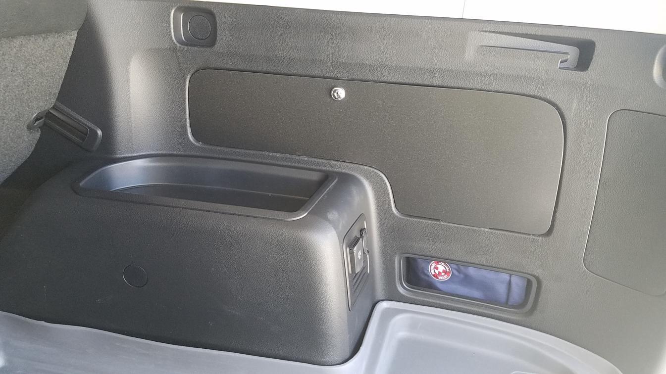

Here's the lowdown......I used a piece of aluminum, and an alarm panel door lock. First use a chunk of poster board or cardboard and trace the outline of the cubby. Transfer that to the Plastic or aluminum sheet but add two ''tabs'' that project out on the bottom, one in the top ''step'' and one in the bottom. You can then cut out the sheet to shape and the tabs will go into notches you grind into the cubby with a Dremel. Cut the alarm lock or any other lock with a sweeping arm that pivots up into a notch in the top of the cubby. I pushed inward while bumping the lock arm into the plastic and then cut along the mark left on the plastic so when it is locked it stays tight with no rattles! Then hit it with some Plast-Dip for texture. Two short piano style hinges will work on the bottom as well. I am sure it can be refined from my first crude attempt!
