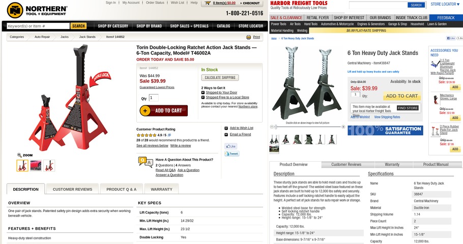

Given that, the height seems to be:
Either of those will work perfect for you. It's just extra insurance to have the added height and wider base. The HF will work great and they have 20% coupons all the time. Plus there should be one real close to you so shipping shouldn't be factored in.
Cool good to know. My 2 ton jacks at left over from when I had my Toyota Celica and they have a hard time even getting the front tires off the ground without a wood block underneath them. Good point.
Yeah, my 3 tons just don't cut it anymore for tire rotations. I might get some 12 tons at some point for some real extra insurance. It's me that's laying under 2 tons of vehicle so I might as well go overkill.
Here's a link for $34.99
6 Ton Jack Stand Set
That link comes up to $40 for me ($7 shipping + $3 tax) = about $50 for me.

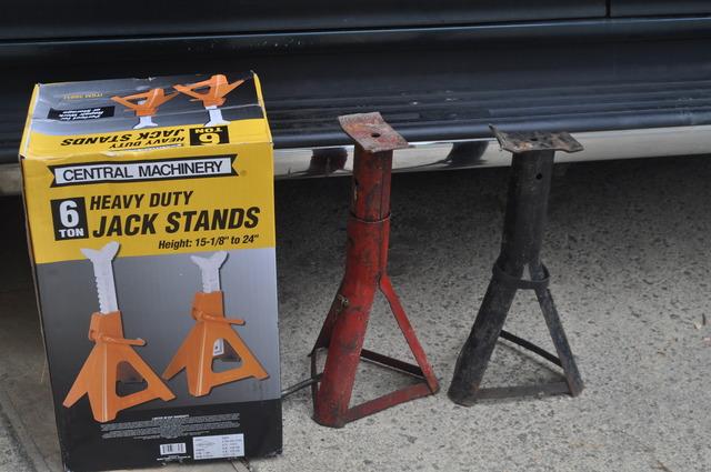

I wonder what 'tonnage' my old garage-sale jack stands are?

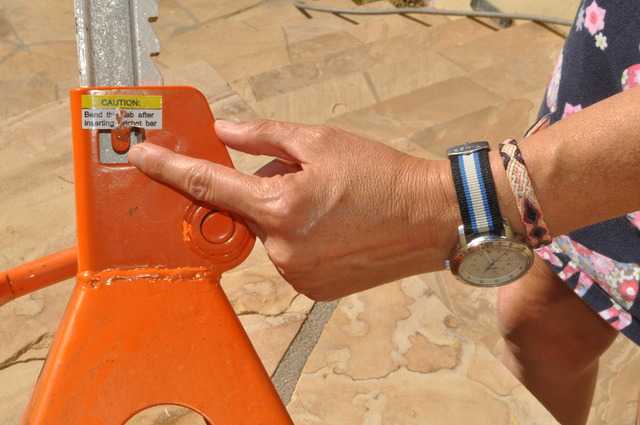

One 'gotcha' I found with these six-ton jacks is that they strongly suggest you push in the locking tab on the side of the jack, once you initially insert the ratchet post.
The problem is that the tab of metal was impossible for me to bend inward!
I'll snap a photo in the morning ... but my question is HOW on earth do you guys manage to bend in that hugely strong tab?

By the way, I just snapped a picture of the minor riddle of the tab on the jack stand.
The instructions clearly admonish:
CAUTION: Bend this tab after inserting ratchet bar
It's embarrassing to admit but I tried banging with a hammer, placing a steel rod on the tab and banging with a larger hammer, putting a nail and banging some more, etc.
Despite pounding away, the thick steel tab didn't budge a micron.
Two (somewhat embarrassing-to-ask) questions:
Q1: So why the big CAUTION? I mean, the only thing that I see that happens without the tab bent is that the ratchet can come out when the jack stands are upside down. Is there a safety problem that I don't see?
Q2: Do you bend your tabs? If so, how on earth do you do it for such strong jack stands?
a length of steel rod or a large punch and then with a BFH (3 lbs hammer or larger)... whack away
To Q1: My best guess.. without the tab bent in it could be extended above the toothed section and sitting cockeyed enough not to fall. Then if you are counting on it to support vehicle weight as a backup to some other jack or stand, it could fail when weight hits it.

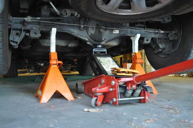

UPDATE:
I must say, I've used these suggested jack stands quite a few times already and they're absolutely wonderful!
Here, for example, is a shot of them in action doing my rear brakes this weekend.
It has been years since I last logged in, but I just want to report that, with more experience, I highly recommend buying four of the 15-inch 6-ton jack stands.
I bought my second set at Harbor Freight when they went on sale.
While it's rarely necessary to put the car on all four, I do it even when I'm just rotating the tires, simply because it's a bit of up-front work, but then everything else is easier with 15 inches of space under the entire car.
