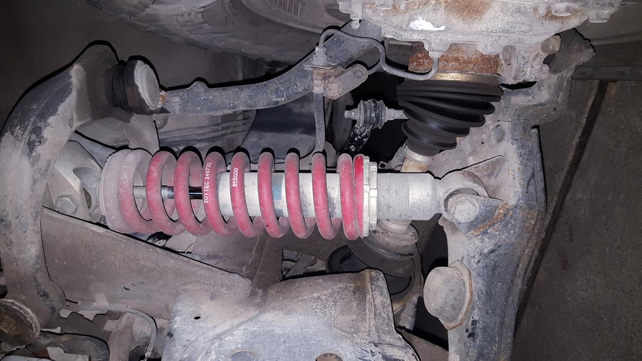

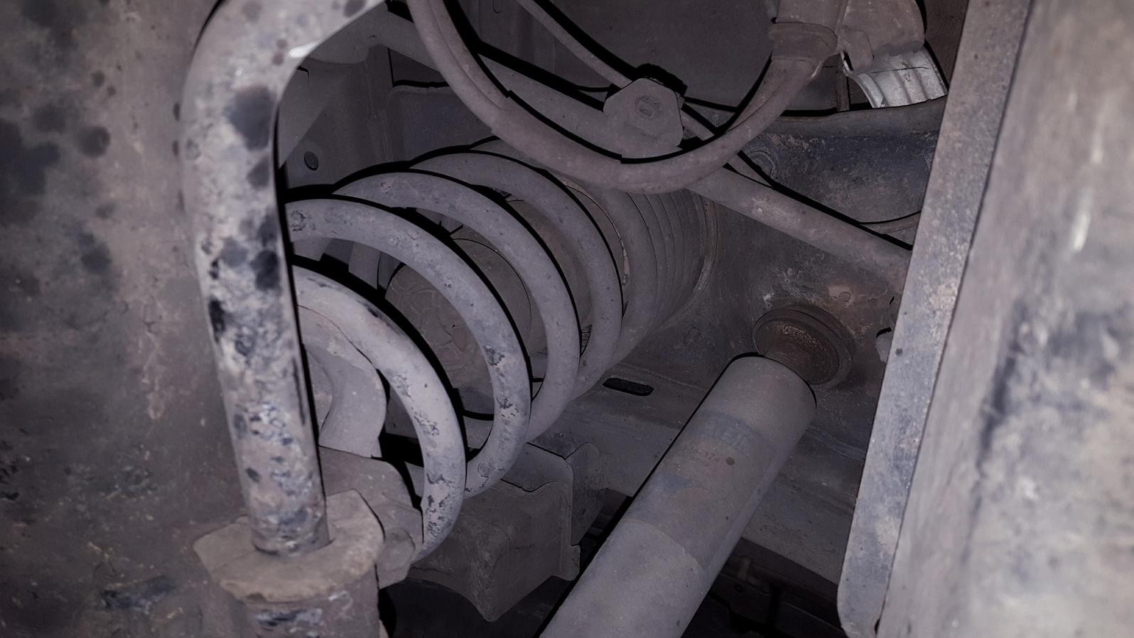

Take a picture of the front and rear suspension. Post it up and we should be able to tell you what shocks you have.

Actually I had taken some photos earlier tonight, but didn't realize the actual model info was visible.
Rear shocks: Bilstein 33-187174 2" Lift Rear Shock for Toyota FJ Cruiser
Front shocks: Bilstein as well
The front coilovers you have look like Toytec's "ultimate lift" they used to offer which was a bilstein shock & eibach spring. I think they phased them out so they could sell there BOSS lift kit over the last couple years.
The rear shocks you have are commonly used for 3rd gen rear 3-4" lifts.
Cool. So are the rear shocks fine then for a 3" suspension + 2" body lift?
That is correct. Bilstein 33-187174 were originally designed for a 0-2" lift for 4th & 5th gen 4runners & FJ cruisers but it is also commonly offered as a rear shock option for a 3rd gen with a 3-4" lift.
A body lift will not be a factor for suspension parts.
